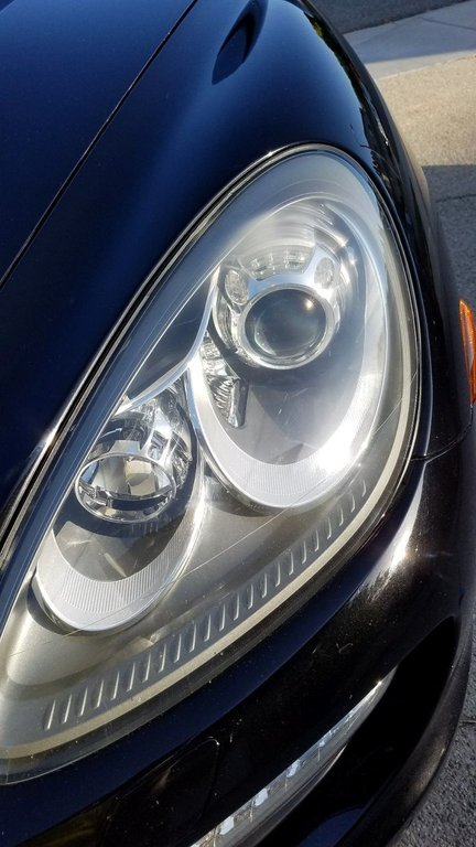

Finished product:
Difficult to see the seal on black paint
