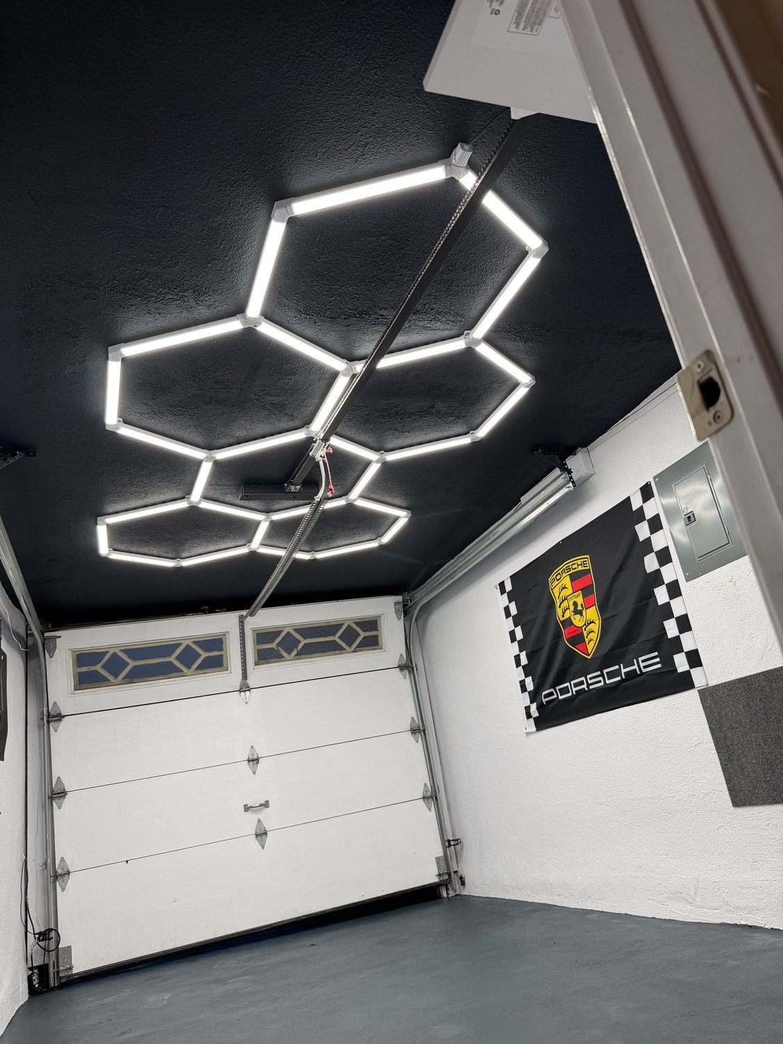

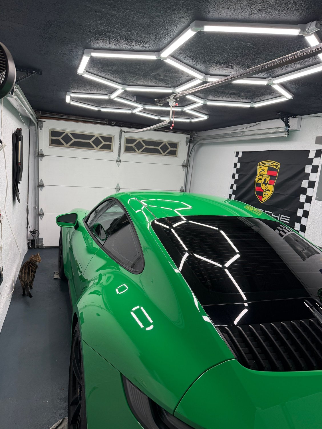

I just recently updated my lighting in my garage with lights many are using...Huge difference. Hex lighting provides very even lighting.

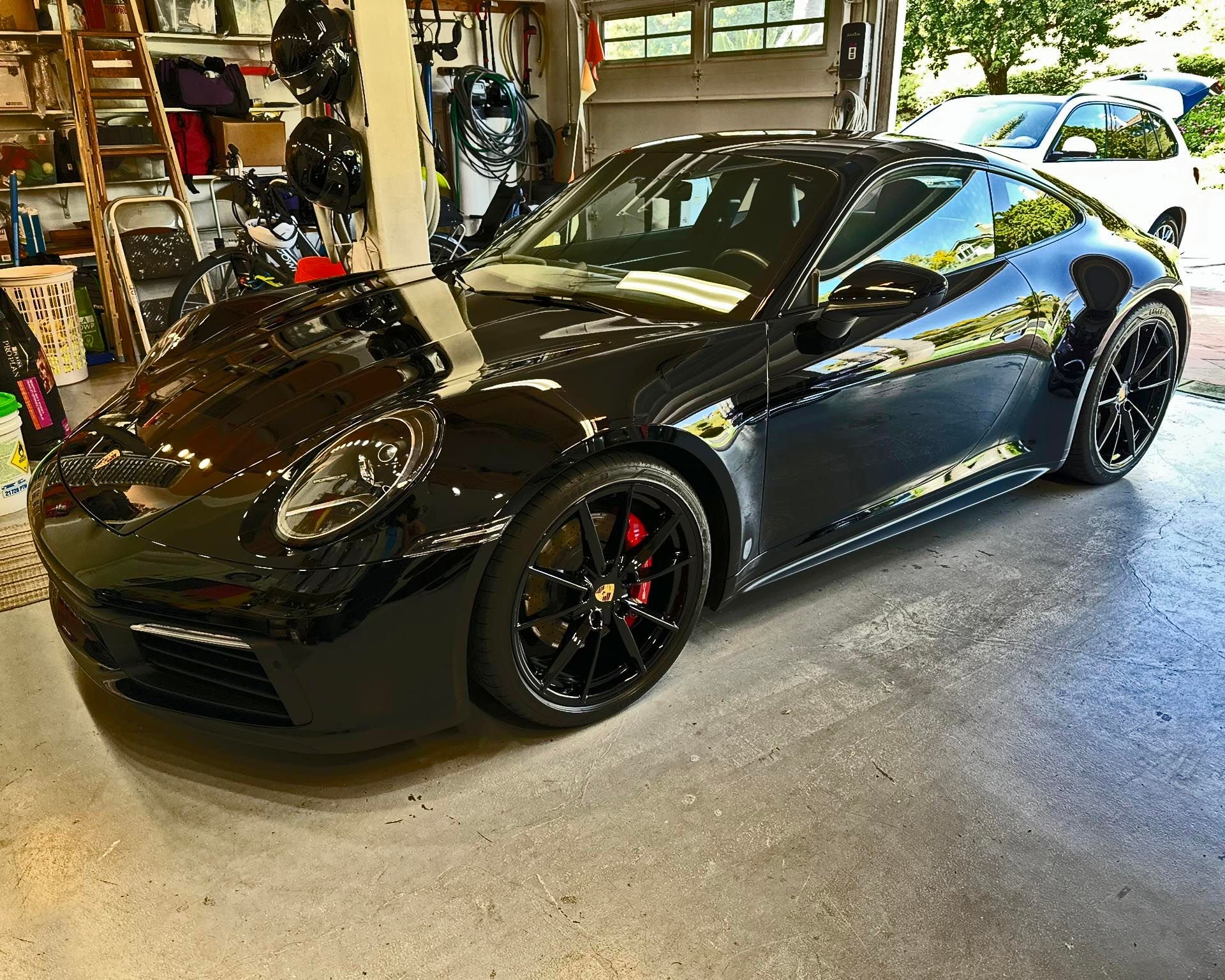

FWIW, here is my garage exactly as it looks every day. I also do most of the work on our cars and motorcycles and you can tell by the way this garage looks vs how other "Showroom" garages look. Unlike a car, a capitol improvement such as adding a garage and I'd keep the potential next owner in mind. Taller, Wider and Deeper are all better, more electrical service (Amps & Outlets), higher psi Concrete for the floor, Plumbing water and drains in particular, make sure it matches and complements your home aesthetically, etc.
I think in terms of Function over Fluff. So, as one example, I prefer shelves over cabinets with doors. Cabinets definitely look better, but lots of deep and wide open shelving are far more useful to me.
We live near and have a lovely view of the Pacific Ocean (~1 mile) but it's Southern California. So while humidity isn't a noticeable problem for humans, there is definitely salt in what little humidity there is in the air. In particular, the chrome on our motorcycles reacts to it. Frequent washing and TLC seems to be sufficient to keep ahead of it.
Our DD's live outside 24/7.
Standard 3 car garage in California. Very few homes have basements, so garages do double duty in this area of the country.

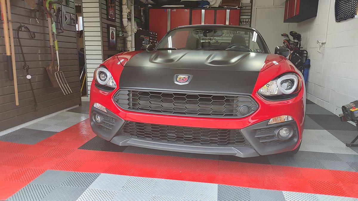

I'd recommend checking out Obsessed Garage (https://www.obsessedgarage.com) for great flooring, lighting, cabinets, etc.
Here's my budget build 1.5 car garage.

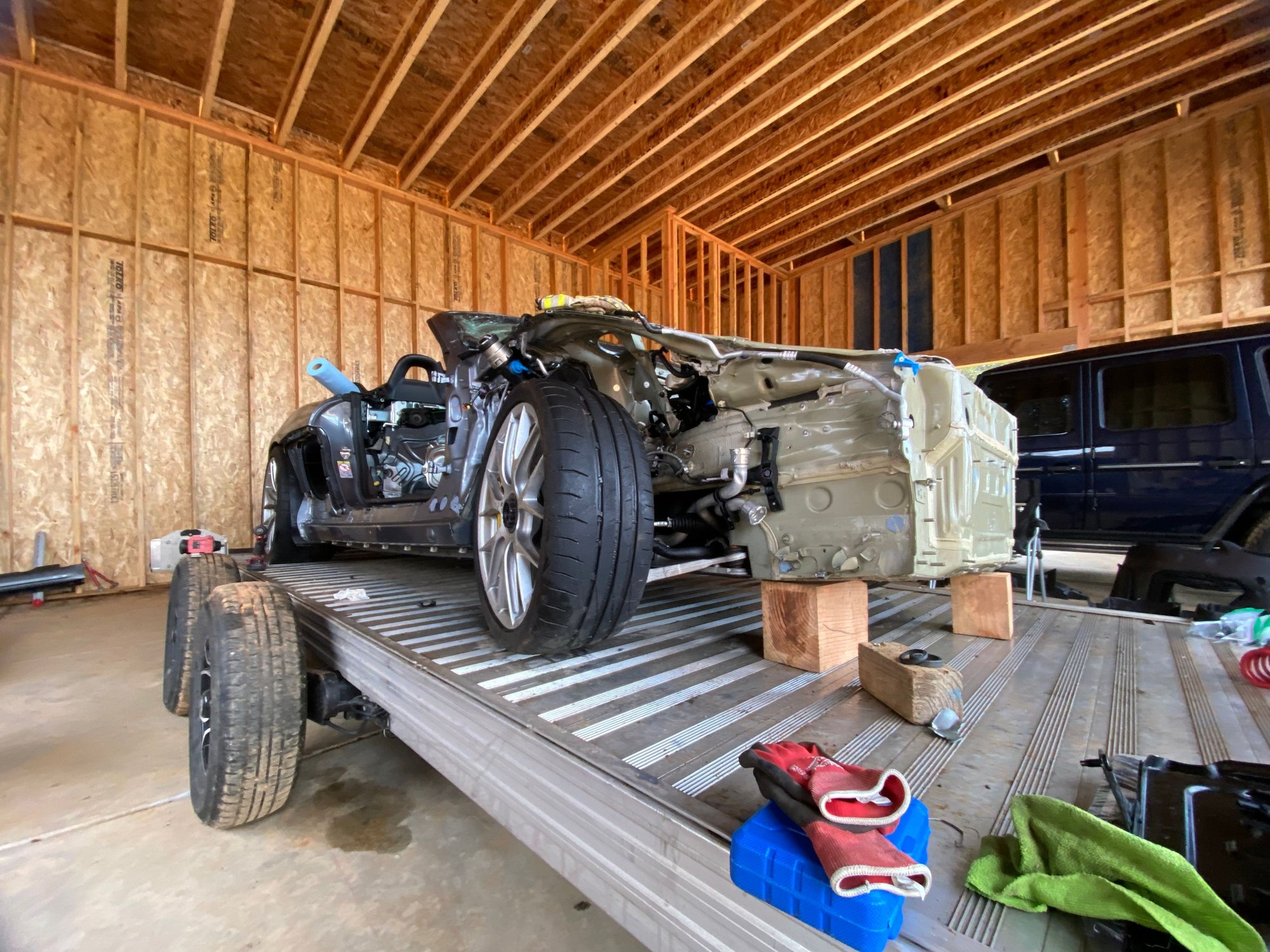

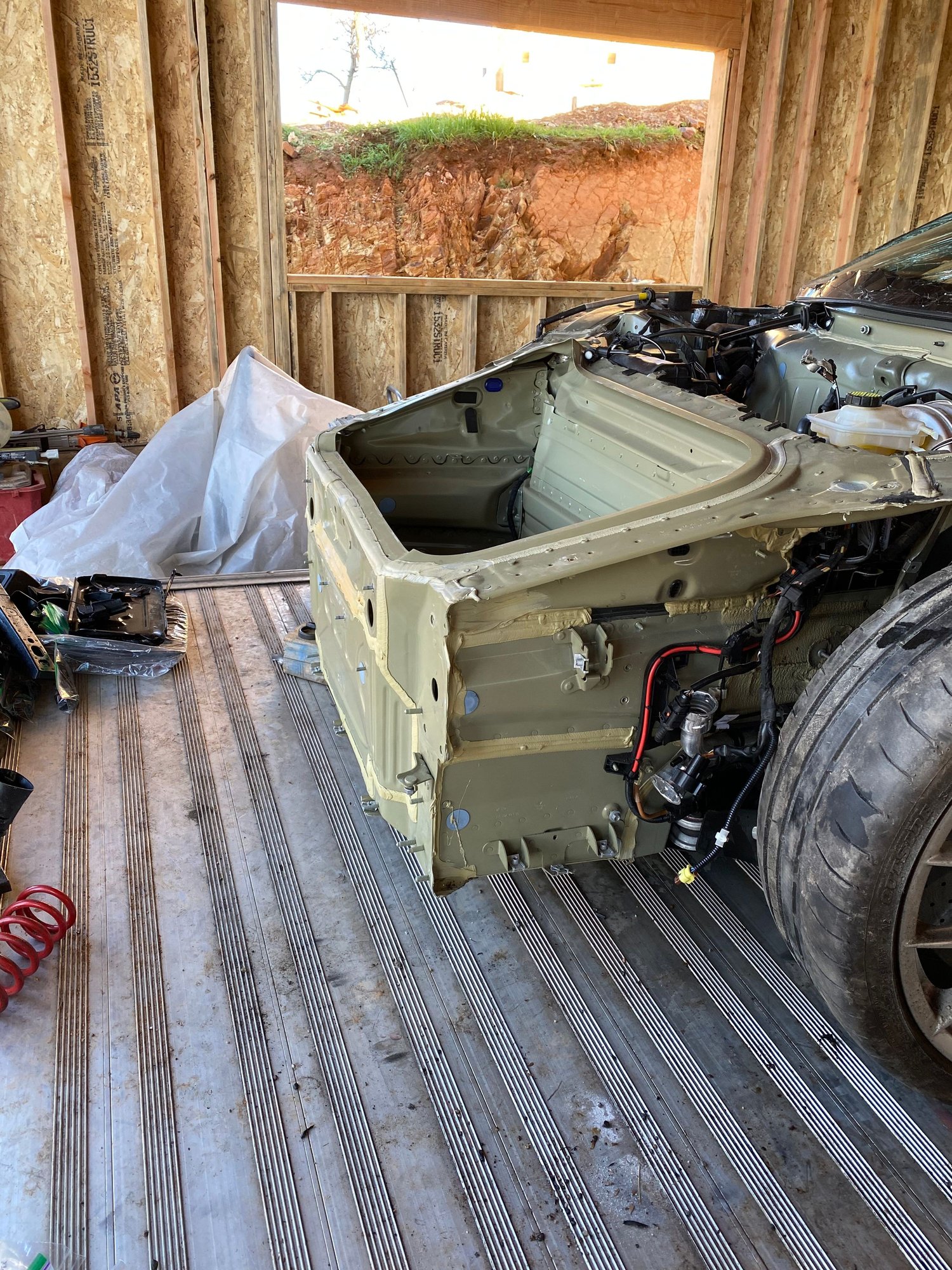

extra wide and deep garage in progress, lift hasn't arrived yet.
Under the trailer are the voids for the flush mounted alignment rack.
Cabinets will be in front, winch hard mounted inside of one of them.
Didn't want mini splits, went with a 3ton heatpump.
REFUSED to have spray foam and all of the pitfalls with few upside vs rockwool.
Doors are 12ft tall with jack drive openers to avoid worries of height restrictions.
Ceiling is 16ft, full bathroom because a petrol flavored shower within the house never went over well.
in ground dump for the camper trailer / a small class b should friends come to visit.
make sure you have enough depth for a truck, with your cabinets. in my case, I wanted a trailer inside if needed, for ease of 3am rollouts.
A few 11kW EVSE, 14-50 NEMA plugs, and plenty of standard outlets will be within the garage (200amp service direct feed) as the home has ~23powerwalls and what amounts to a small solar substation ~38kW pv.
There will be a few TVs, maybe a projector as well. full audio, possibly a mezzanine for indoor hangs. Outside has a full patio with kitchen and hangout pit.
Mostly wanted to hold a trailer, double wide stacker lift, and have a low car friendly alignment rack under roof... and when building it all yourself, why not check every box?
Oh.... and most important was that I couldn't see it from my house... so I dug to bedrock and moved all the dirt out with the R1S.
Just so happened to come across a SRS project while in the middle of the build...
Don't get me started on the house. Wall mounted motorcycle, indoor RS parking. Glass box on top of a mountain.
