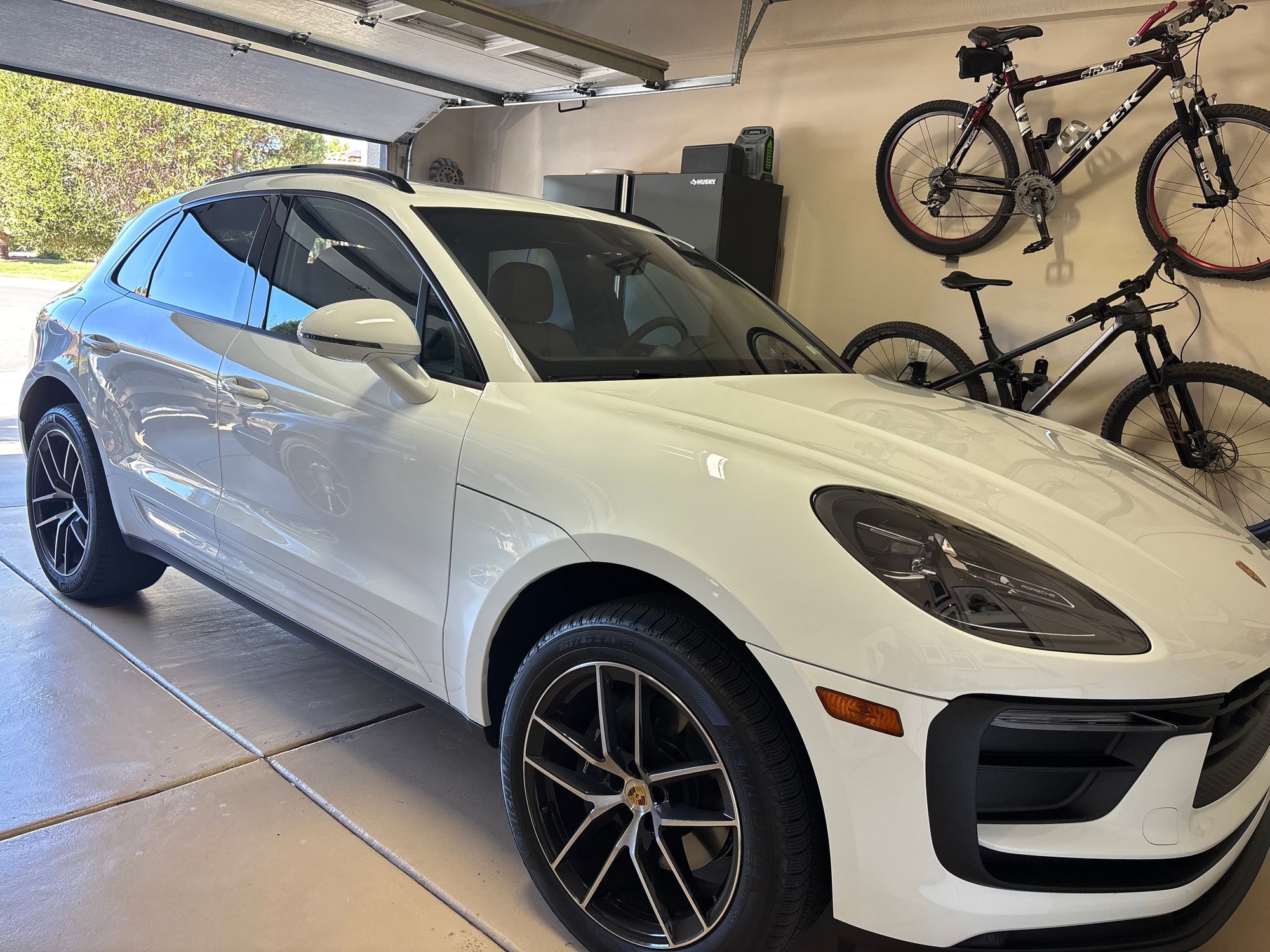

I’ve been using Pinnacle Crystal Mist Detail Spray for 15 years and up until today I had not found any other detail sprays that I thought worked better. My primary focus was gloss, depth and ability to lubricate the paint surface enough to prevent swirls during cleaning. Most products came up short on the appearance and or lubricity. I decided to give Carpro Release a try based upon Moe’s suggestion and I have to say that after 15 years I may be switching to Release going forward. The gloss is next level and yet it doesn’t have that artificial plastic wrap look. The lubricity is also excellent, as good or better than Crystal Mist.
Thank you for the feedback and glad you liked Release
I love how easy it is to use and get great results
That Macan looks radiant 😍😍
