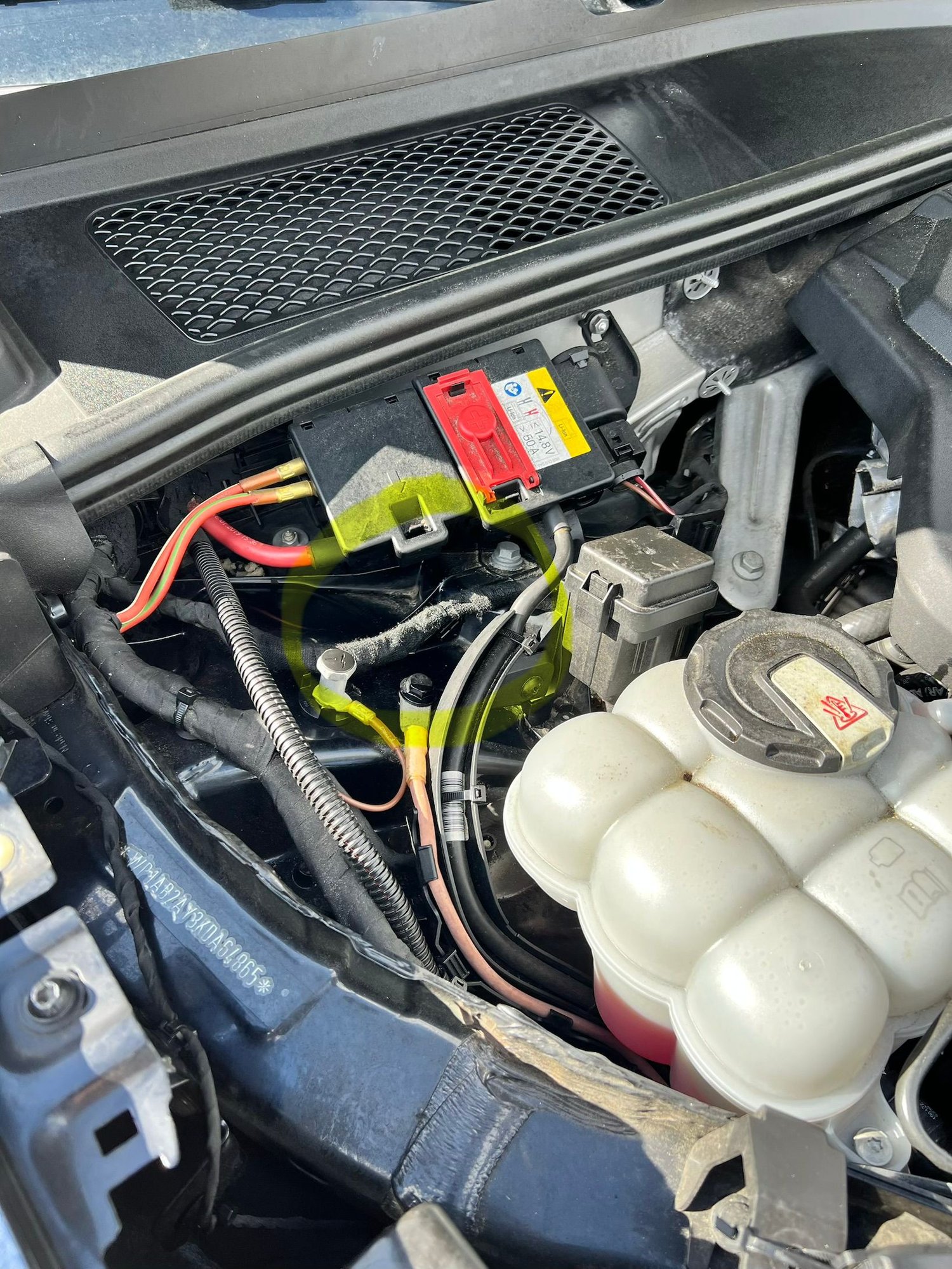

The circled wires in harness under the hood near right firewall were damaged, see post-repair photo below. I didn’t take before-repair photos but several wires were broken and/or chewed.
I didn’t ask my indie shop about the exact details of the repair but error light is off and car is good now 😁.
