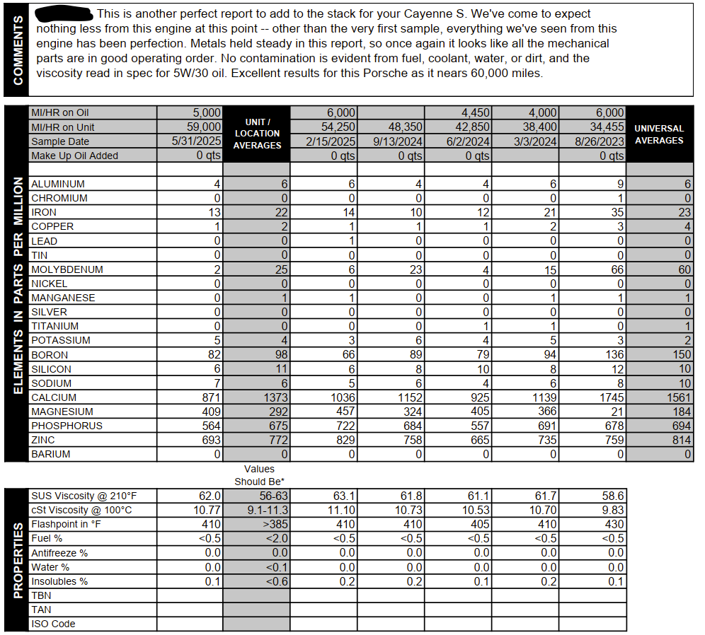

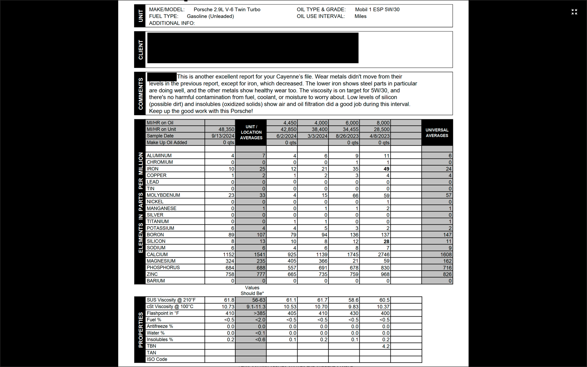

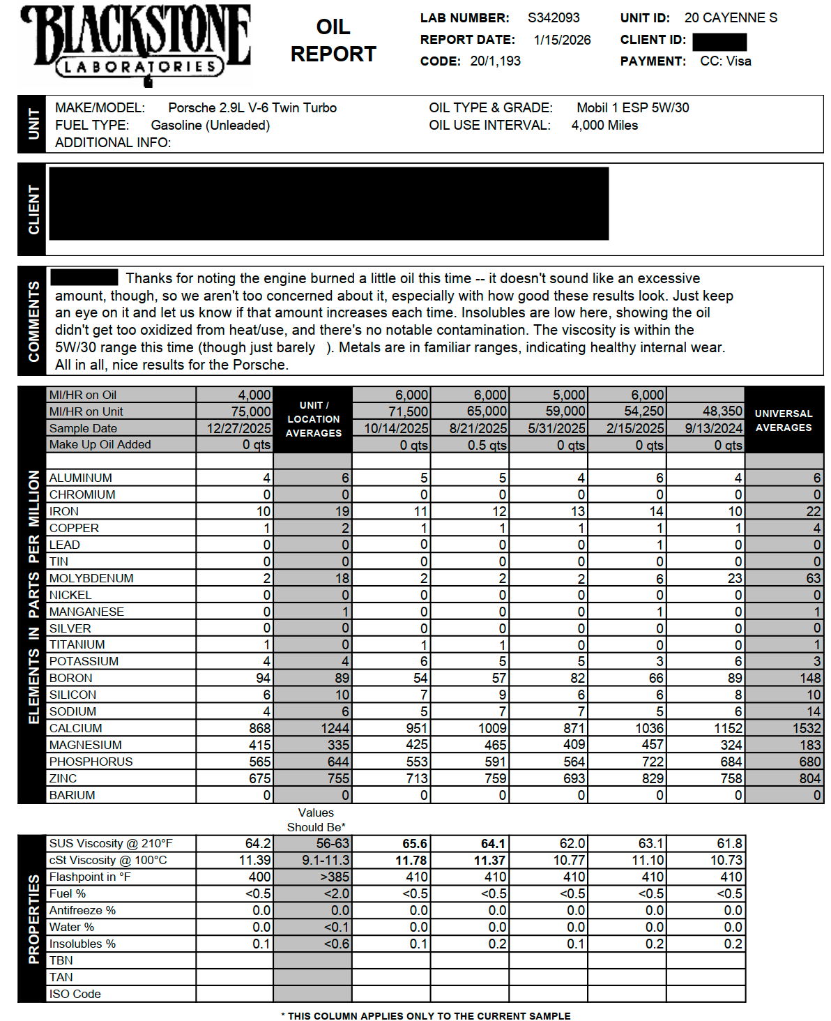

Engine: 2020 Cayenne S with EA839 2.9TTV6 with 81,500miles as of today. Purchased from a Porsche dealer as 2-year old CPO unit with 24,500 miles.
Driving style: mostly mellow, sometimes aggressive, some max GCW towing.
Summary: excellent results
- Low wear metals
- Low fuel
- Low coolant
- Additive package is working
- Max GCW towing in late 2025 may have cause viscosity increase
Oil is always Mobil 1 ESP 5W-30. Filters most of the time have been the cheapest in-stock filter at Advance Auto, AutoZone or O'Reilly's.
