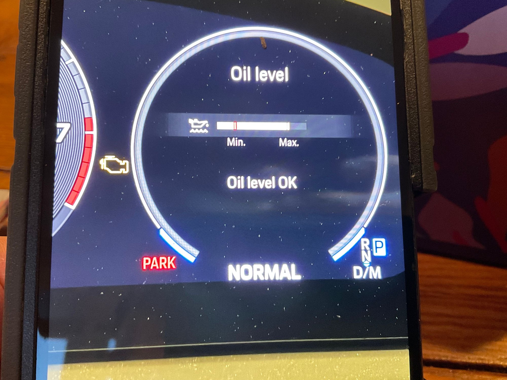

So this is my gauge. As long as I’m above minimum I’m ok?

yes, ur nearly at the max line. the car won’t prompt you to add oil until it goes to the min line. if you are half way between and want to top it off, the easy thing to do is to just go by the dealer. they will top it off for you for free. or try to get you to ignore it. depends on if you get someone lazy or not.
