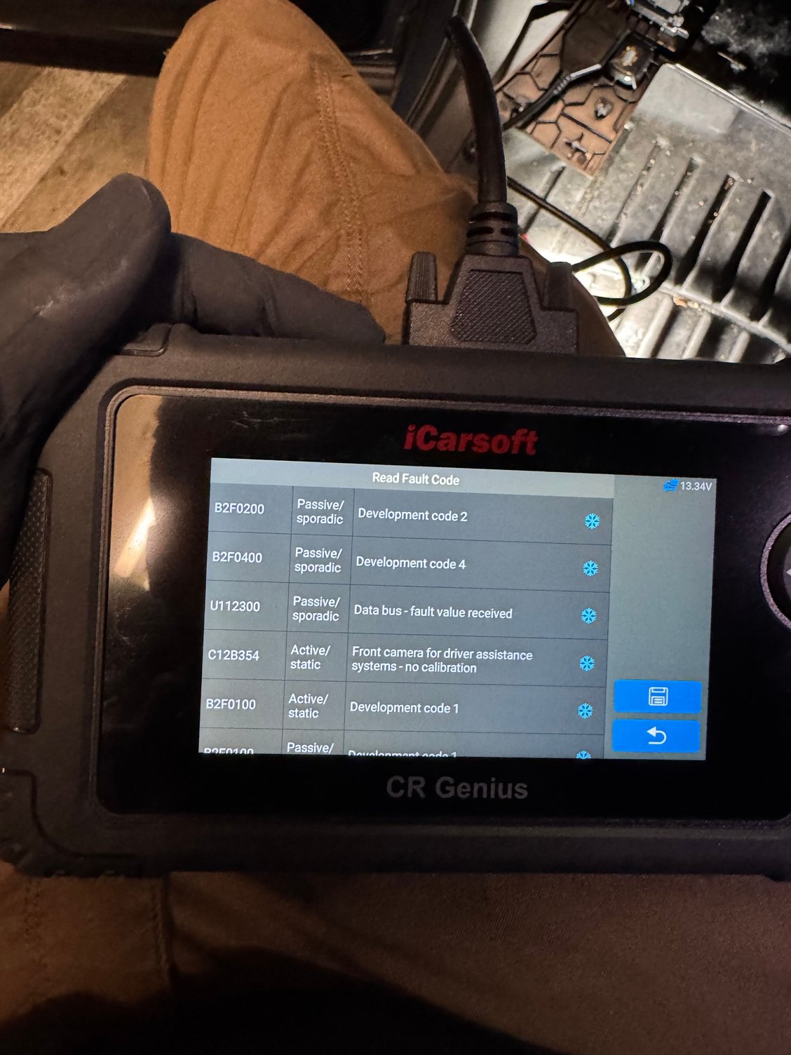

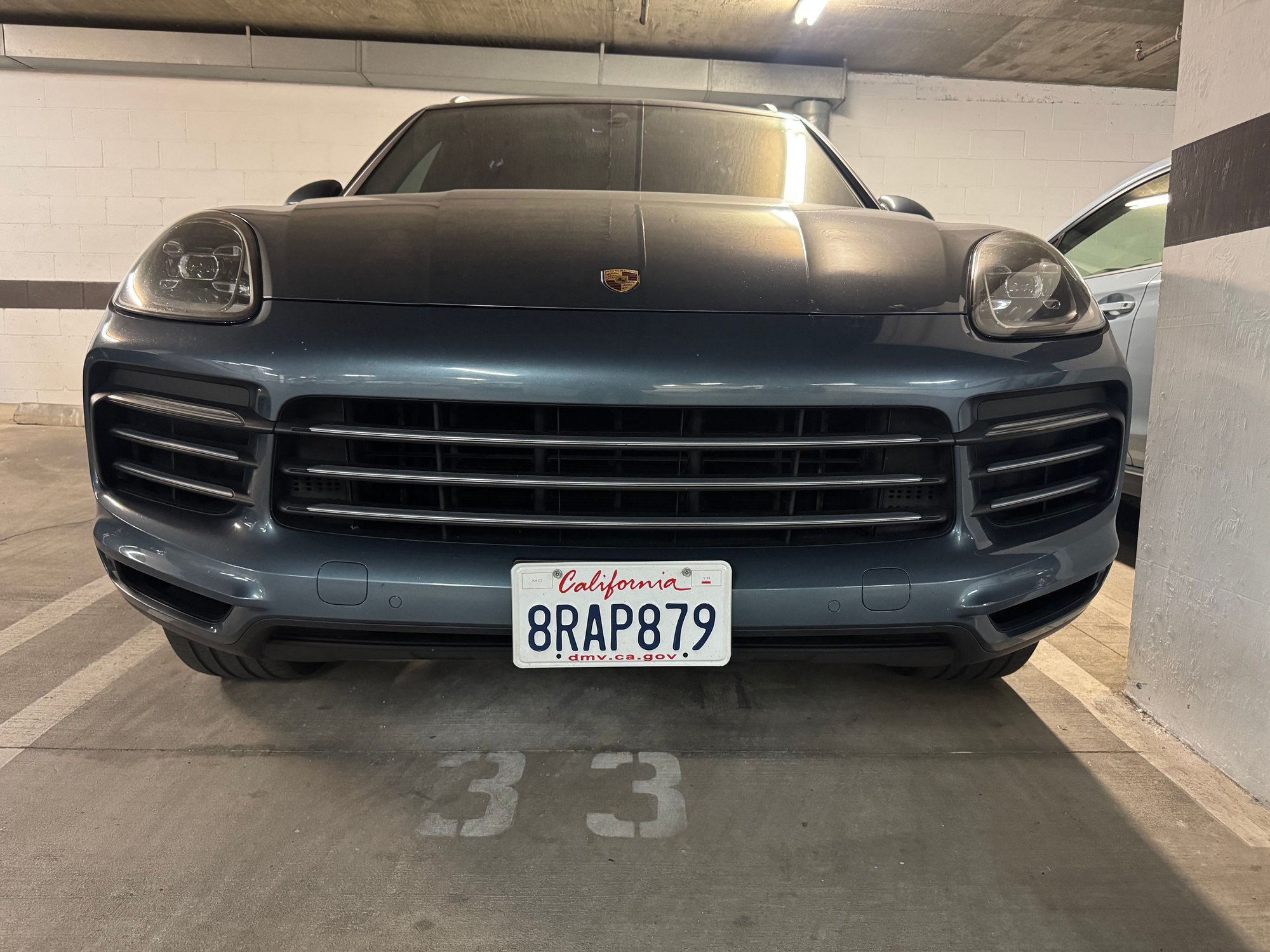

Correct me if I'm wrong, but I don't have a front sensor/camera in my grill. I think the only sensors I have are in my windshield. Anyway, I scanned for codes again, and this is what came up.
Any suggestions?
Thanks
Any suggestions?
Thanks
Mine is a 9Y0.2 and has sensors there. Let’s have others with .1 versions chime in.

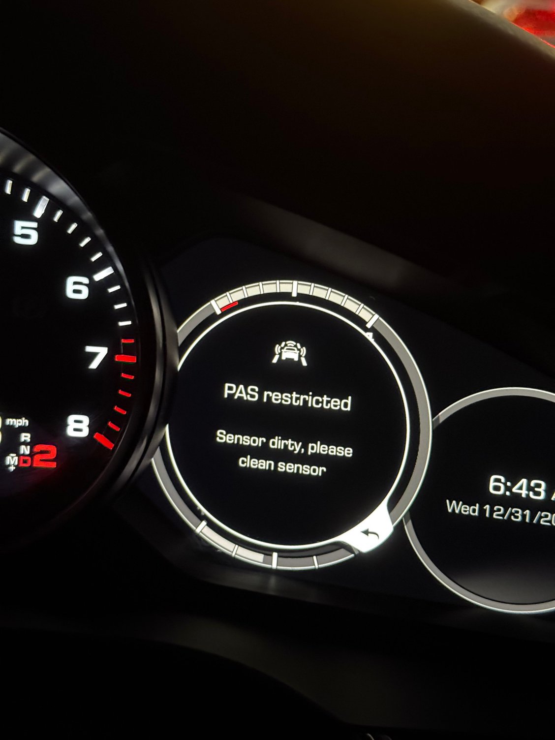

Any updates on this issue? I just took delivery of a CPO 2021 base YESTERDAY and it came up this morning. I don’t have ACC or any visible sensors in the grille either. The dealer is an hour away and I’m hoping for a quick easy fix at home..
