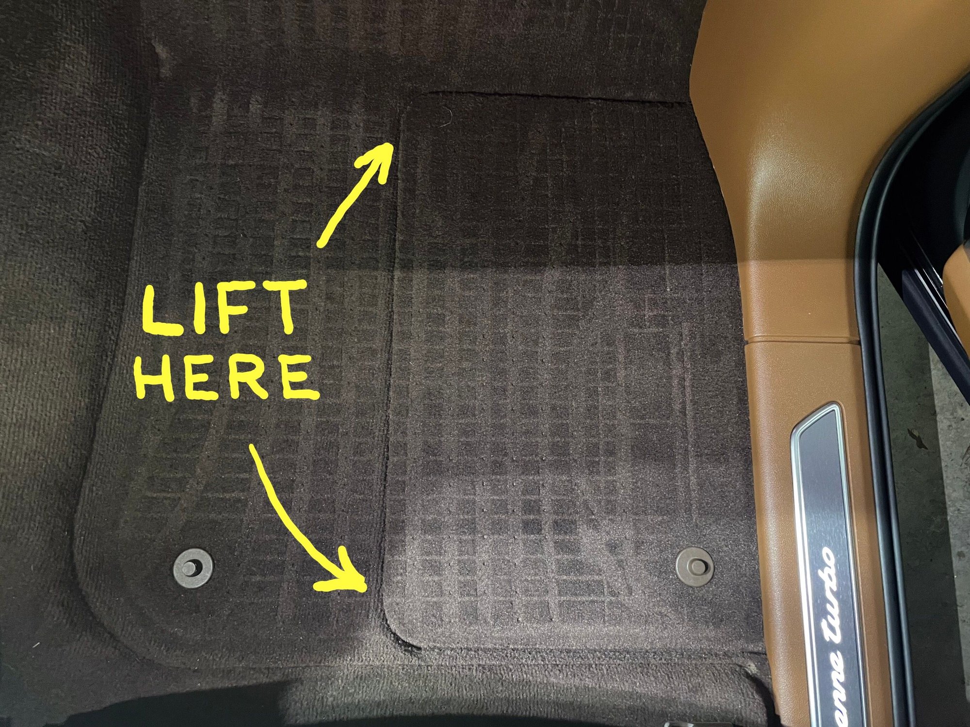

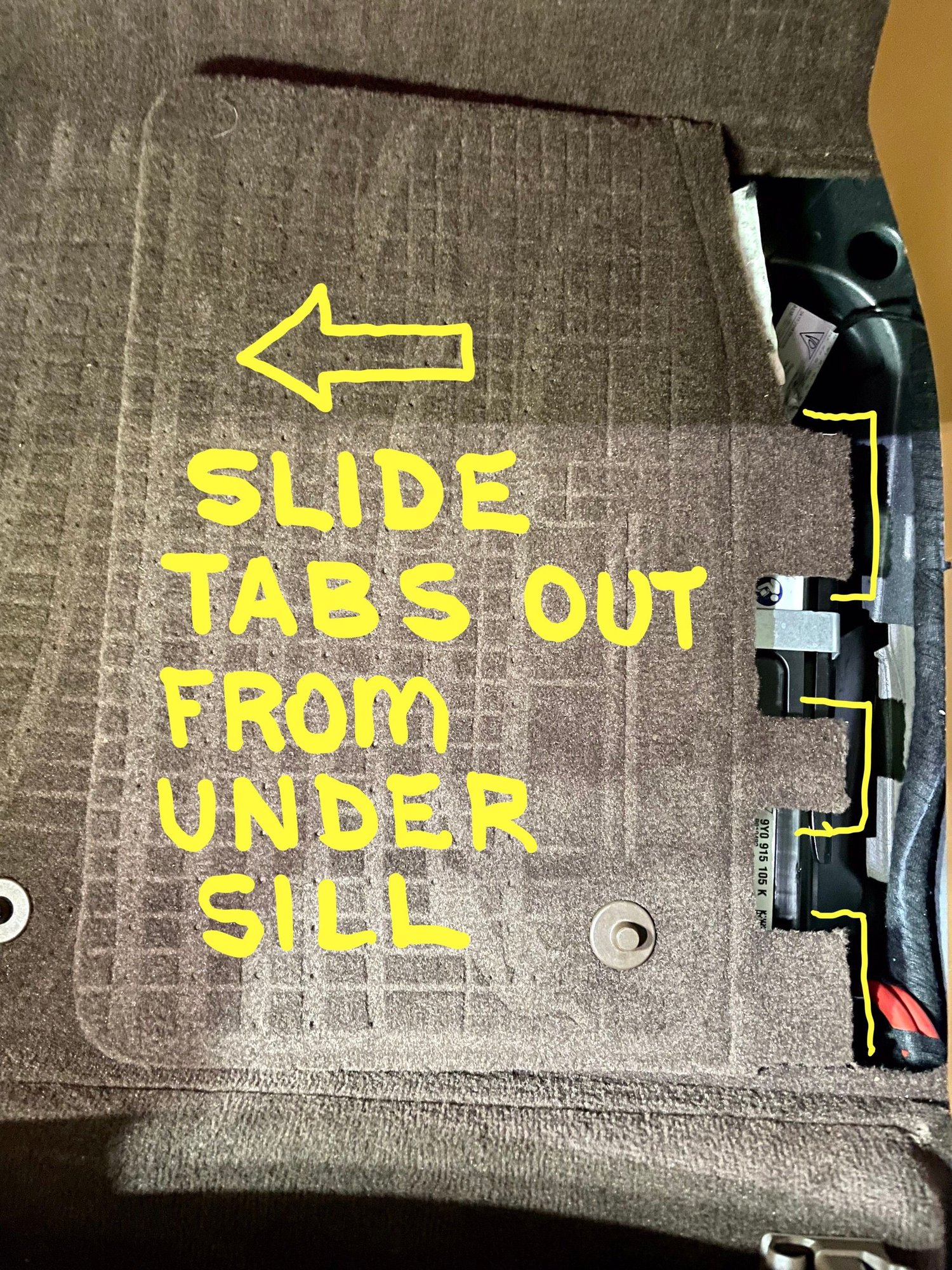

To see for yourself, just look at the battery. It is located under the passenger floor mat and easy to access.

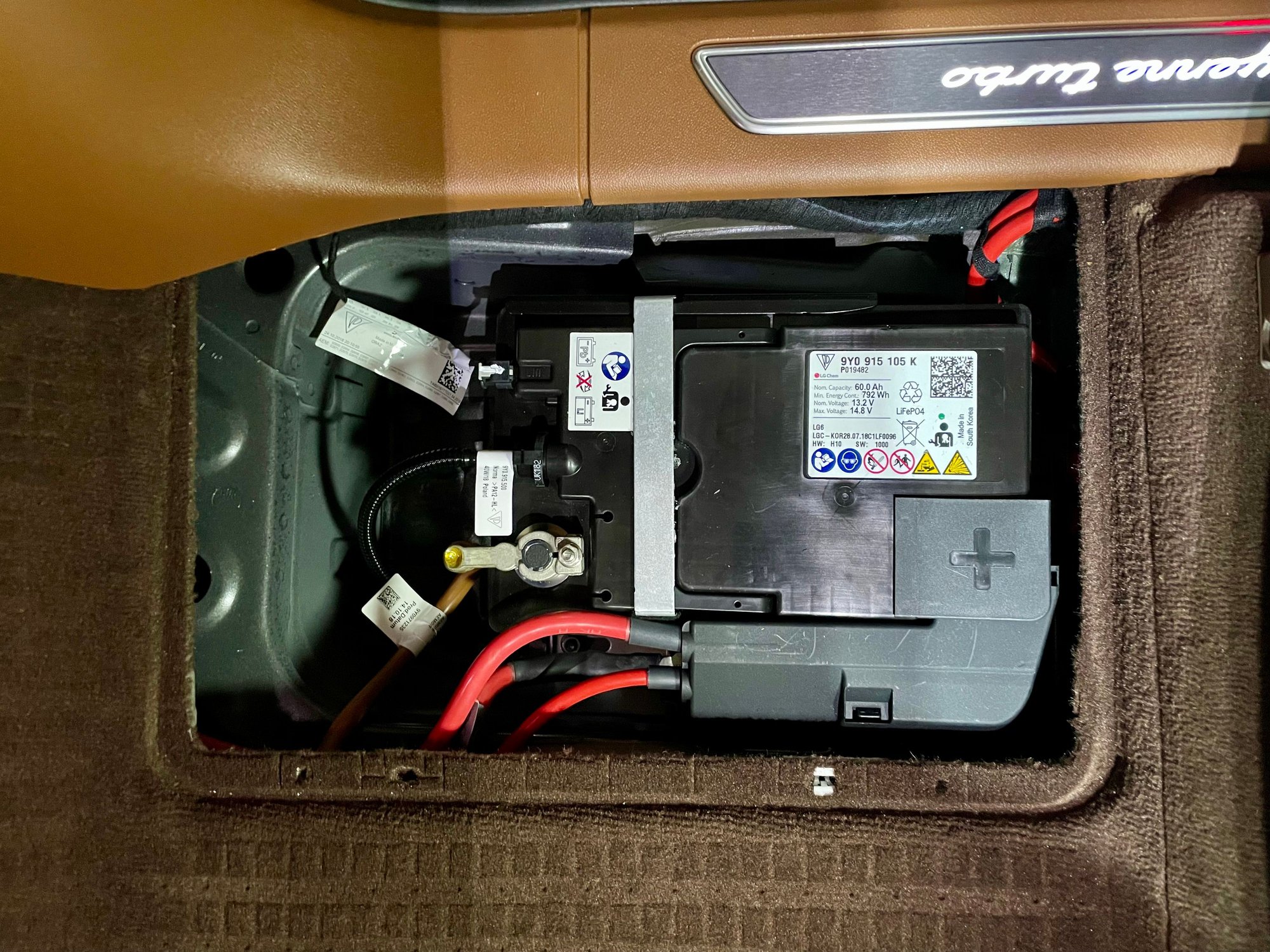

Open the battery compartment and see. The cover is in the floor in front of the right front seat. Post a photo of what you see.

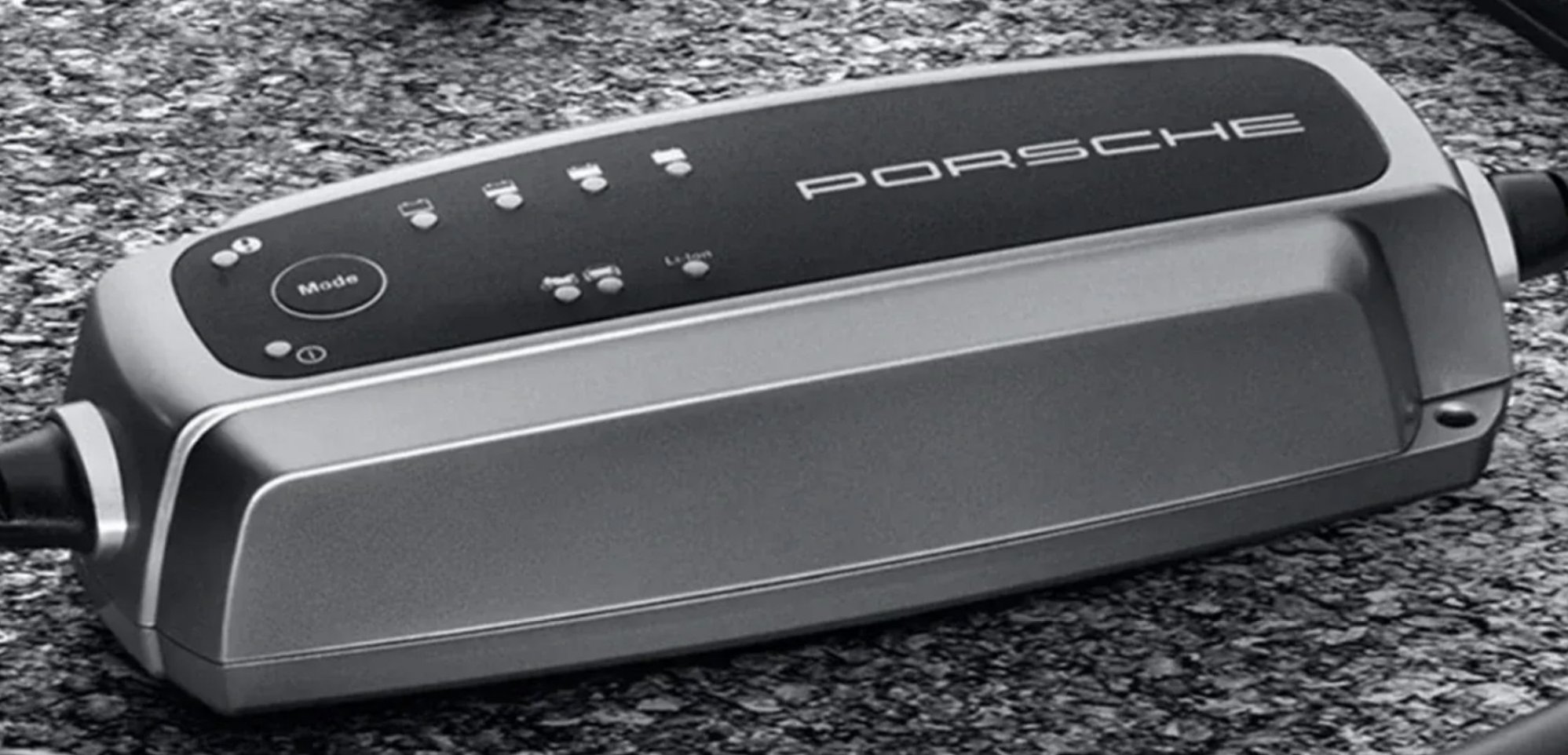

The Porsche Charge-O-Mat Pro is manufactured by CTEK and has the added benefit of having selectable charging profiles for both battery types. However, you will pay a lot of bucks ($260) for the fancy Porsche name on a CTEK charger.
https://shop.porsche.com/us/en-US/p/...91eaf987f40f18

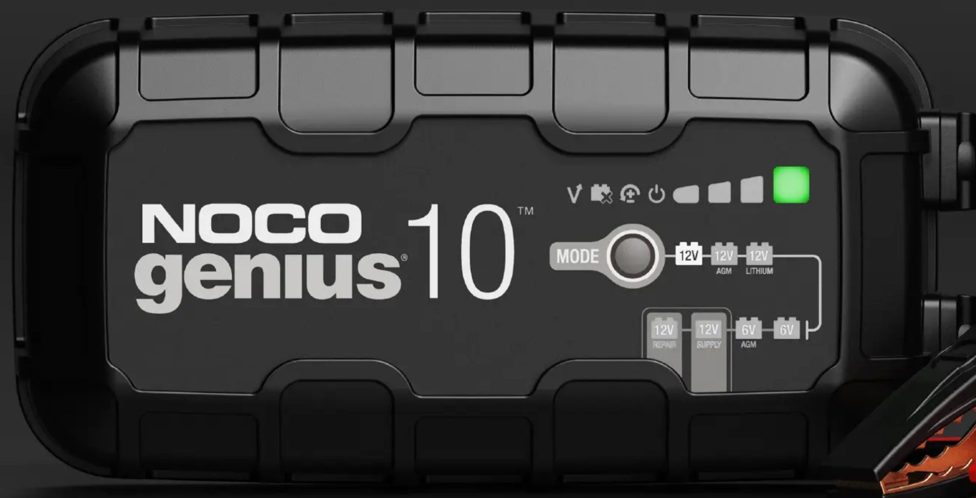

I switched to NOCO Genius 10 chargers and was pleased with the performance. Unlike the $260 Porsche charger, the NOCO costs just 99 bucks. It has over twice the amperage of the CTEK and has charge profiles for many battery types. One complaint about this and all the others above — it uses LED lights to give approximations of various charging stages.

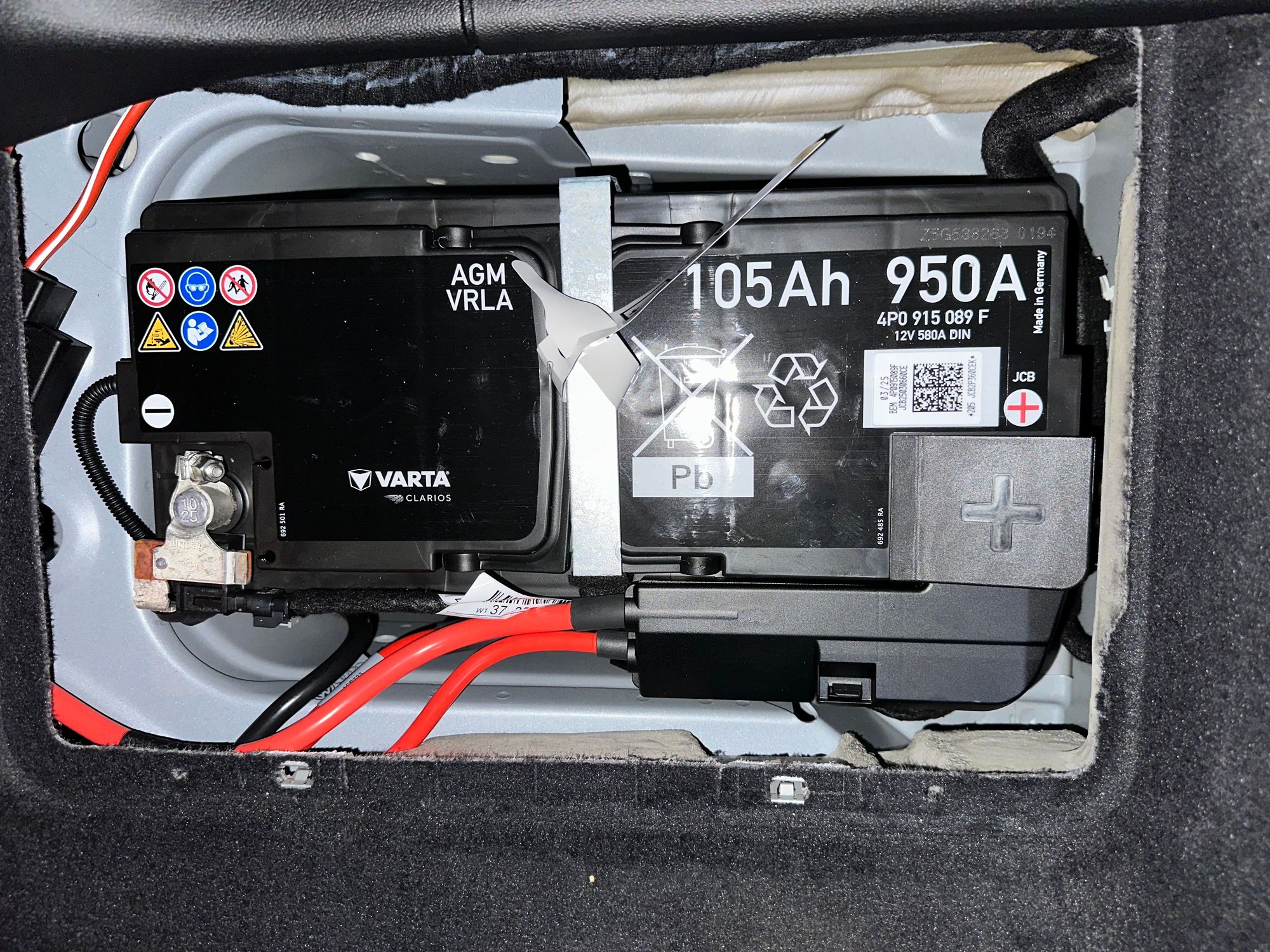

AGM
