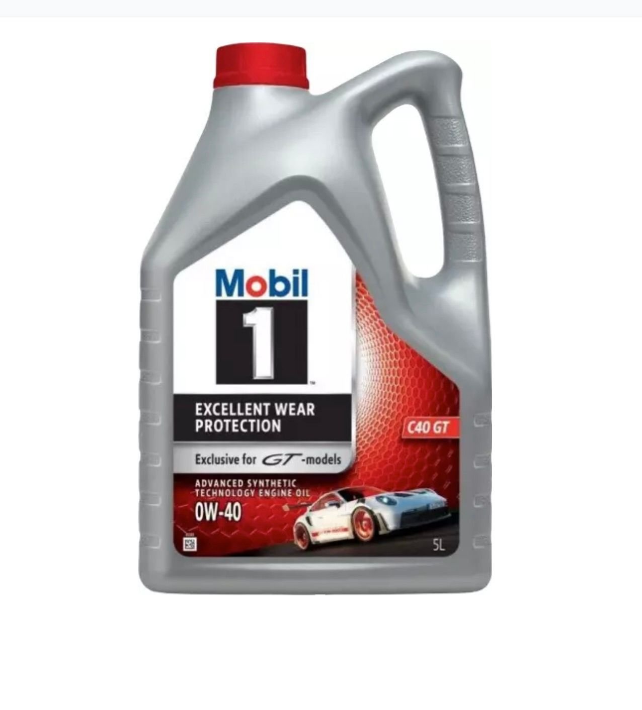

Originally Posted by pbon
Assuming you go back, ask the dealer if it actually makes any difference. I think many here don’t know much other than what they read in the owner’s manual. No, the VW 3.0L was not designed around C20 0W20 oil, but the C part of the oil spec is apparently intended to work better with OPF if your car has them and may be helpful in reducing the likelihood of LSPI. My car does not have OPF, but the anti LSPI properties of a C oil is appealing. As for 0W20 or 0W30 or 0W40 within the C spec, I am not convinced it matters except for fuel economy.
1/ Okay, apart from reading sometimes the owner's manual I have been involved in motorsports for many years. So I still remember a bit about how the engine is built and what oils are used for different engines.
2/ The OP's car is a car from the German market so it has OPF.
3/ I still believe that oils are selected to the engine specification and this should not be changed. As you would have probably noticed, 0W40 oil with the C40 standard is recommended for Porsche V8 engines in specification for the S, GTS and Turbo models, but a different C40 GT 0W40 oil is recommended for other Porsche models in the GT version. This is also clearly stated that C40 GT can't be used for engines with C40 specification. So despite both being 0W40 oils, they are definitely different and cannot be replaced. Also, C20 and C40, apart from different viscosity, are different oils for different engines.
