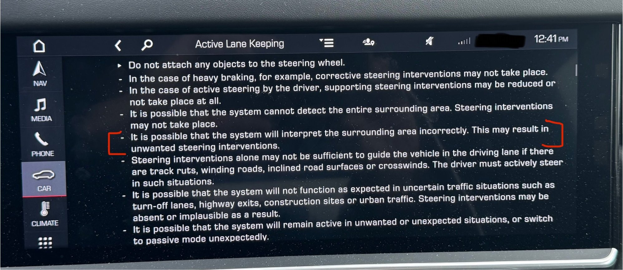

Check this hilarious comment in the PCM. In summary: it doesn’t work.

In short, Use at Your Own Peril and don’t blame us!

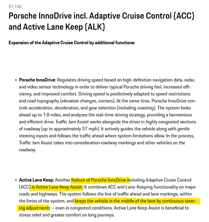

I think what people should want is now technically "Active Lane Keep Assist" (ALKA), which is a mishmash of both the terms you listed but the key being "active", and you get it by specing "Innodrive". Porsche should be clearer about these acronyms to help people select them, and they may have changed what they do over the model years. My '24 base didn't even list whatever lane keeping it does as a separate option on the Monroney - just "Adaptive Cruise Control". So it's whatever that lane keeping system was - "bounce you between lines and beep at you".
The bottom line is get Innodrive to keep you centered in the lane and solve the annoyances. Porsche describes this on the Monroney for the Turbo E-Hybrid as "Innodrive incl. ACC and ALK (upgrade)"
On the website, it lists "Active Lane Keep Assist" as a component of InnoDrive which it also just calls "Active Lane Keep":
