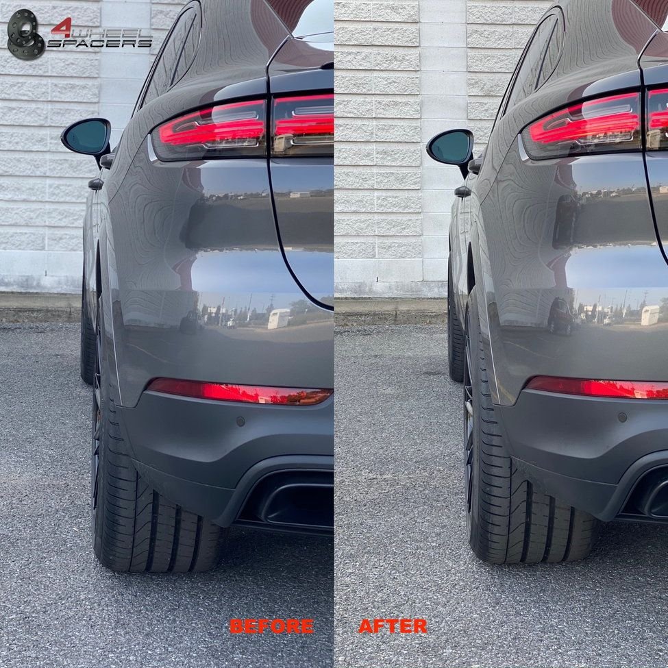

That’s a 14mm change. For reference, here’s what a 12mm change looks like:
More pictures and a great deal of discussion about offsets and the dark art of suspension geometry here:
https://rennlist.com/forums/cayenne-...-question.html

Excellent pictures and information in that thread! I think I'll skip these wheels and look for ones with the correct offset.. thanks!
