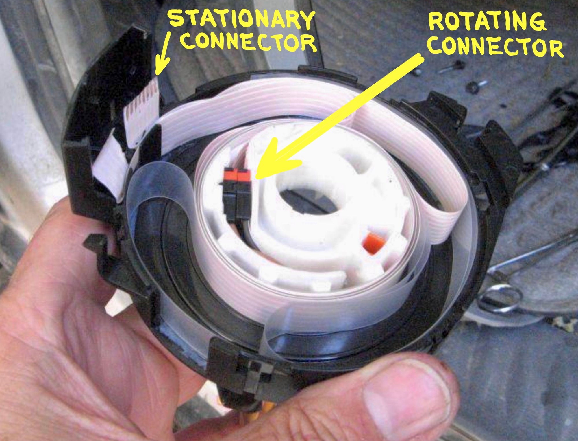

The clock spring is a wound-up wire (ribbon cable) inside the steering wheel that allows the airbag, horn, and steering wheel buttons (including the Sport Chrono Mode Switch) to stay connected as the steering wheel is rotated left and right.
The ribbon will need more pins to connect the Mode Switch than a similar ribbon without a Mode Switch. Not sure if the new steering wheel includes a clock spring.
I had the clock spring in my 993 replaced a couple years ago. Each time you turn the steering wheel, the wire ribbon flexes. Over the years, the wires eventually cracked and I received an airbag warning light.
Since the Cayenne is a computer with four wheels, a module to enable communication between the Mode Switch and the ECU is required. An additional module might be required. At a minimum, an existing module will need recoding.
