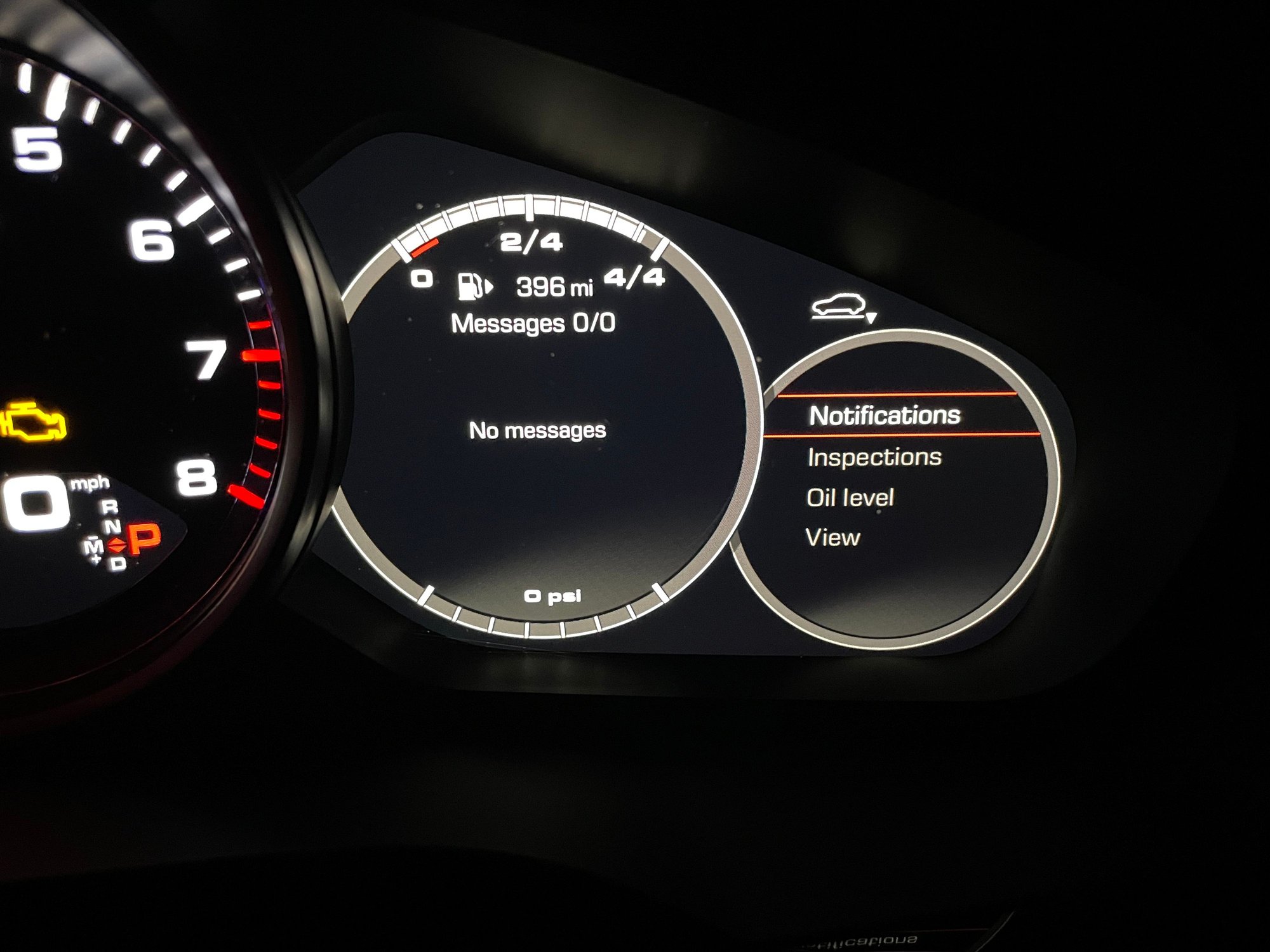

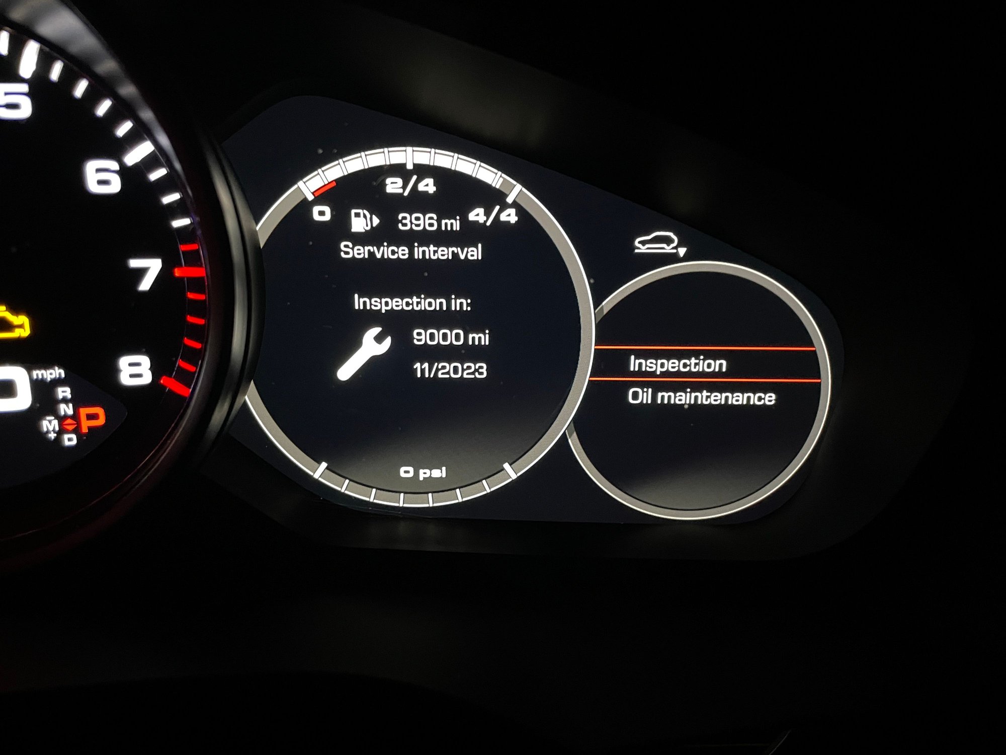

Sometimes, you may receive notifications such as PAS not available, high beam assist not available, ACC not available. After you acknowledge them, they don’t go away and can be accessed on the instrument panel.

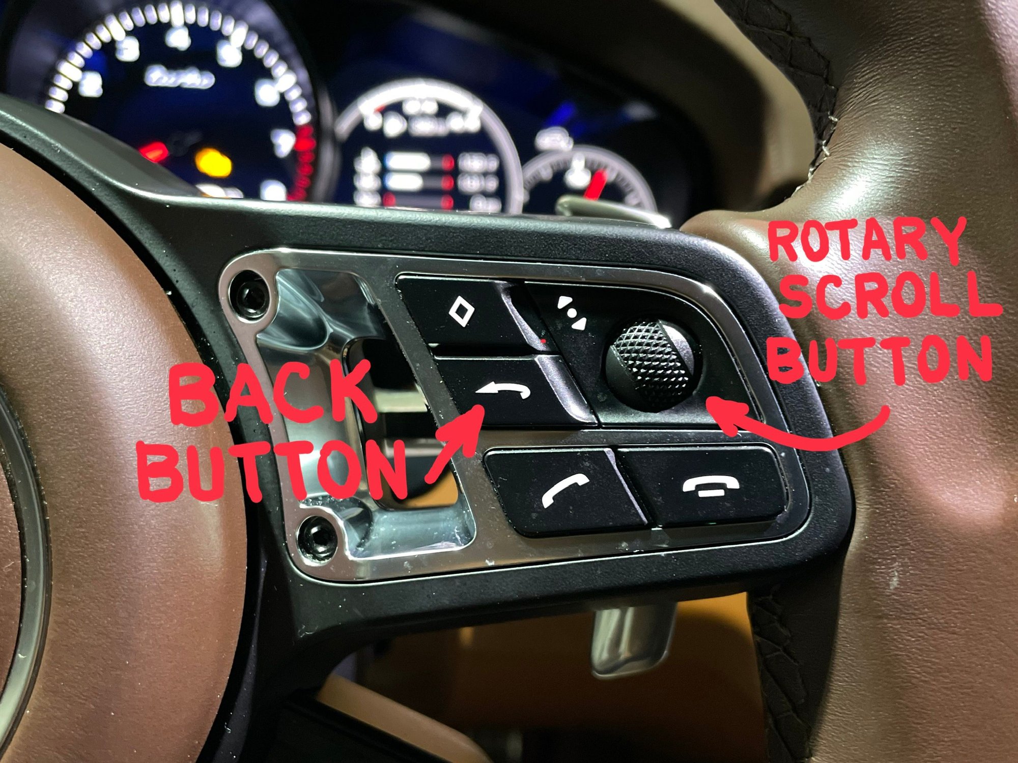

Press the right rotary scroll button on the steering wheel.
This will bring up the menu as seen below.
With the “Notifications” highlighted by the red lines, press the rotary scroll button again. The gauge to the left will display your notifications.

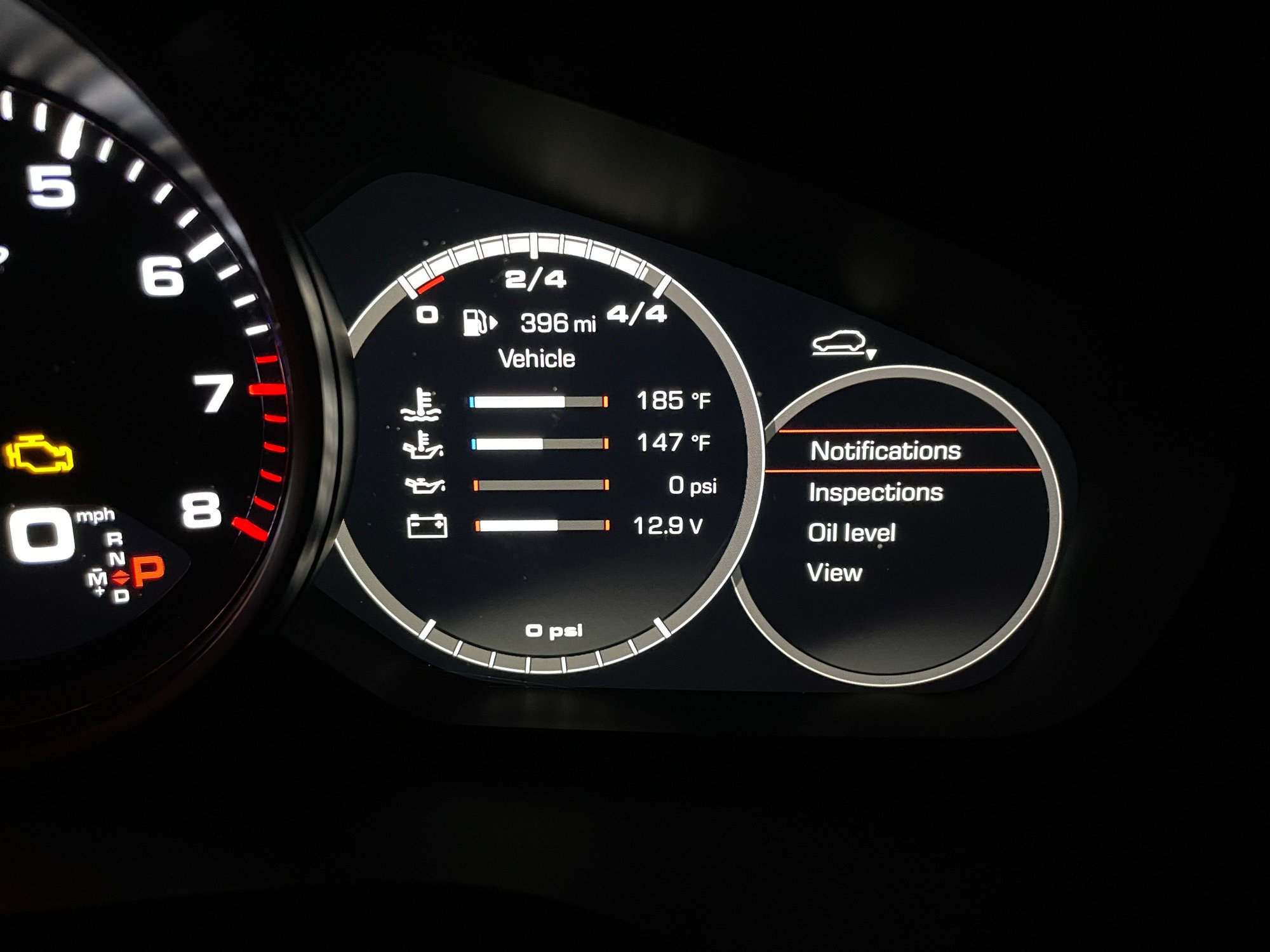

Press the back arrow next to the rotary scroll button to return to the main menu as shown in the first picture. Scroll the red lines down one click to highlight “Inspections” and press the button. Your next inspection will display.
30 days prior to your next inspection, you will get a notification each time you start your Cayenne. For instance, “Inspection due in XX days”. I call it the nag screen. Once the inspection date arrives, you will bear the shame of a wrench icon displayed on the instrument panel until it is reset.

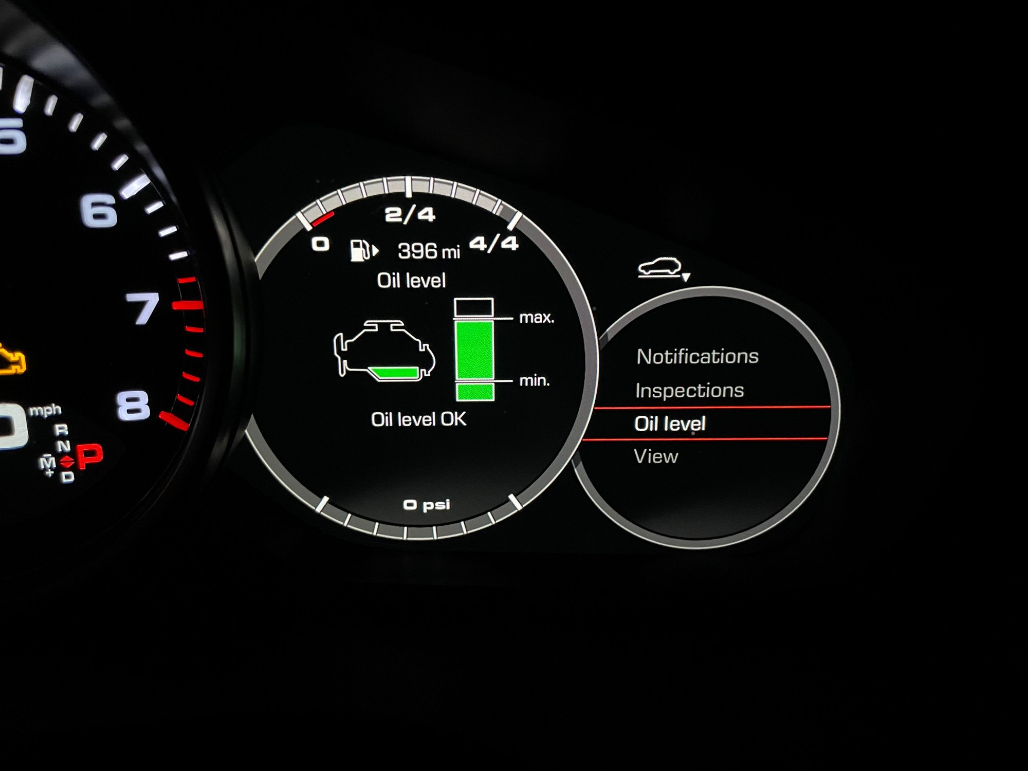

Press the back button again, go to main menu and scroll to select “Oil Level”. Press the button to display your oil level as depicted below.

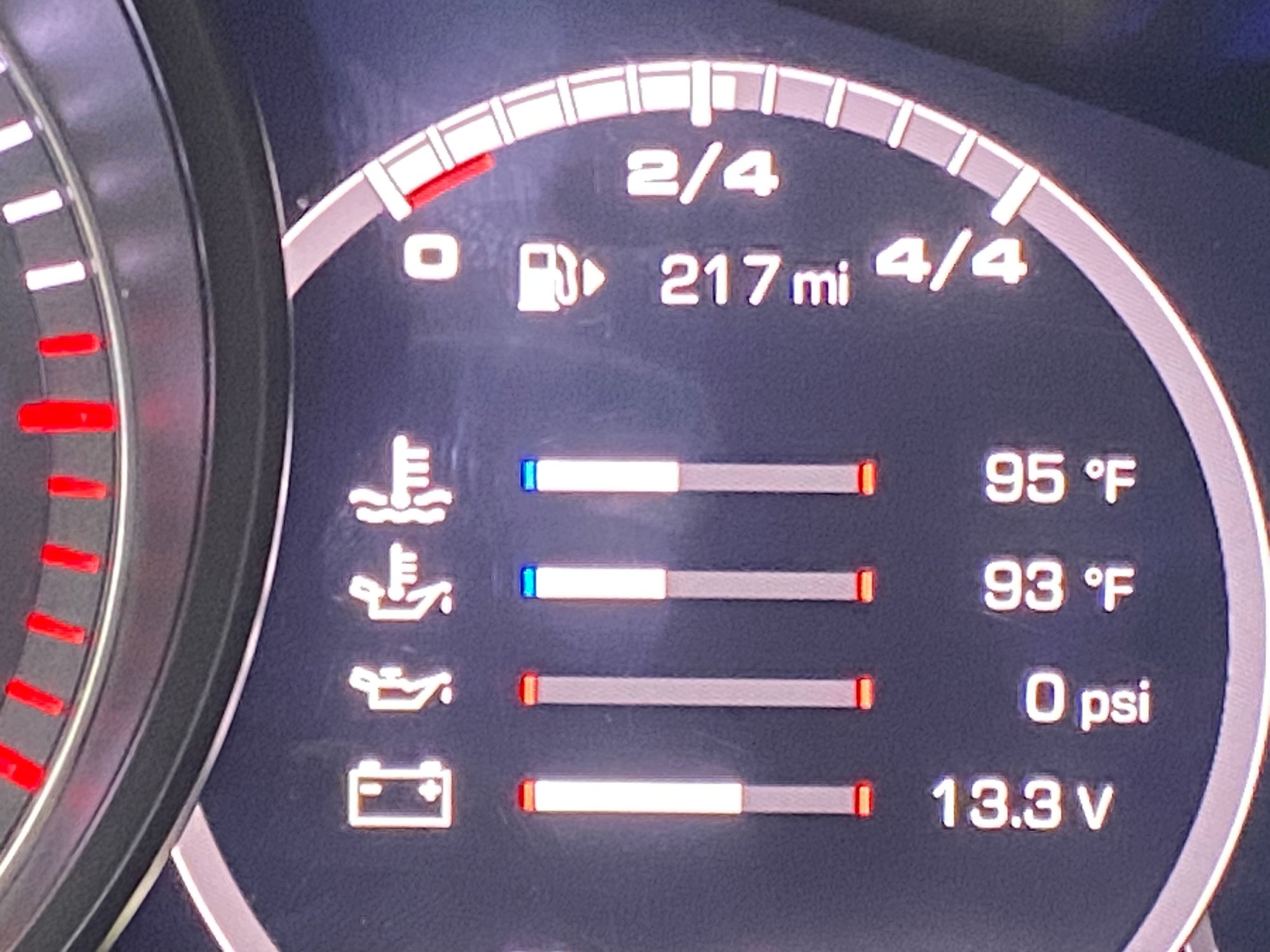

@Schnave surprisingly the light went away. So when I went to notifications there were no messages. Next time the light pops up, if I go to notifications, it will say what caused the light to go on? I was told sometimes emissions can cause the light to pop up and go away. I’m not really sure what emissions causes it. Weird.
On A separate note the battery reads 13.3v and is about 2/3 to the right. Is that for the car battery? How do I know when I need to replace it? I have a 2019 so I’d think 4-5 years is when it starts needing to be replaced?

A CEL will not necessarily trigger a notification. Use an OBD2 scanner each time you get a CEL. I carry a scanner in my glove box.

The lower bar on your instrument cluster displays your 12V Lithium starter battery voltage. Completely separate from your high voltage e-hybrid battery. 13.3 volts is a good value for when the vehicle is stopped. LFP starter batteries are supposed to last much longer than AGM batteries. Time will tell — several reports of these batteries failing early.

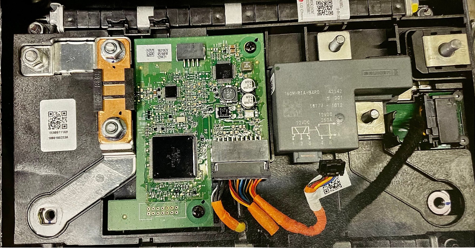

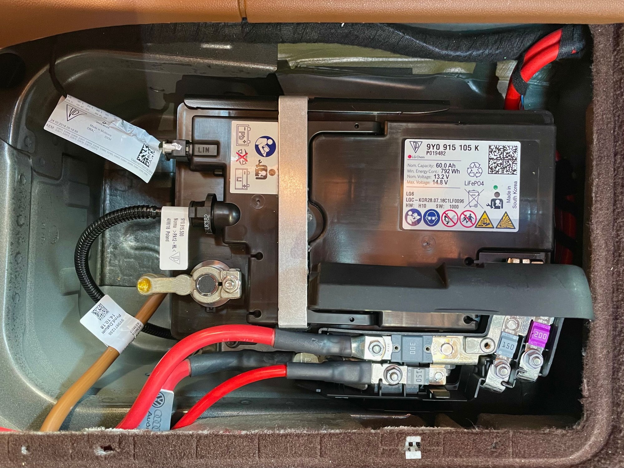

Easy choice picking a replacement battery because there is no choice. Only the OEM Porsche battery works with the Cayenne. And it costs about $2,000 plus installation. And it has to be programmed to work with your VIN. Have you ever seen a more complicated starter battery than this, below? I count 5 different positive cables, each with a fusible link, a negative cable, LIN bus cable, and a vent tube.
And if that weren’t bad enough, take a look under the cover at all the electronics for the battery management system. If this goes bad, you need a new battery.
If a standard AGM battery is installed in a vehicle originally equipped with LFP, a warning message will display and the power supply network switches to emergency operation. Quite the racket for Porsche and really bad for the owners.
Oh, did I mention that there is a shortage of these Porsche LFP batteries? Plan on several weeks to have it shipped from Germany.
It is difficult to determine the battery’s condition. It behaves differently from AGM batteries. Therefore, standard battery testers will not work. Porsche uses the PIWIS to determine battery condition. And don’t use 7 volts as an indication of a bad battery — Read on . . .
Don’t let the voltage drop below 11 volts, or so. If it drops below 10 volts, the battery management system will put the battery “to sleep” to prevent battery damage from under voltage. You’ll have to use a jumper cable or a battery booster to “wake up” the battery.
