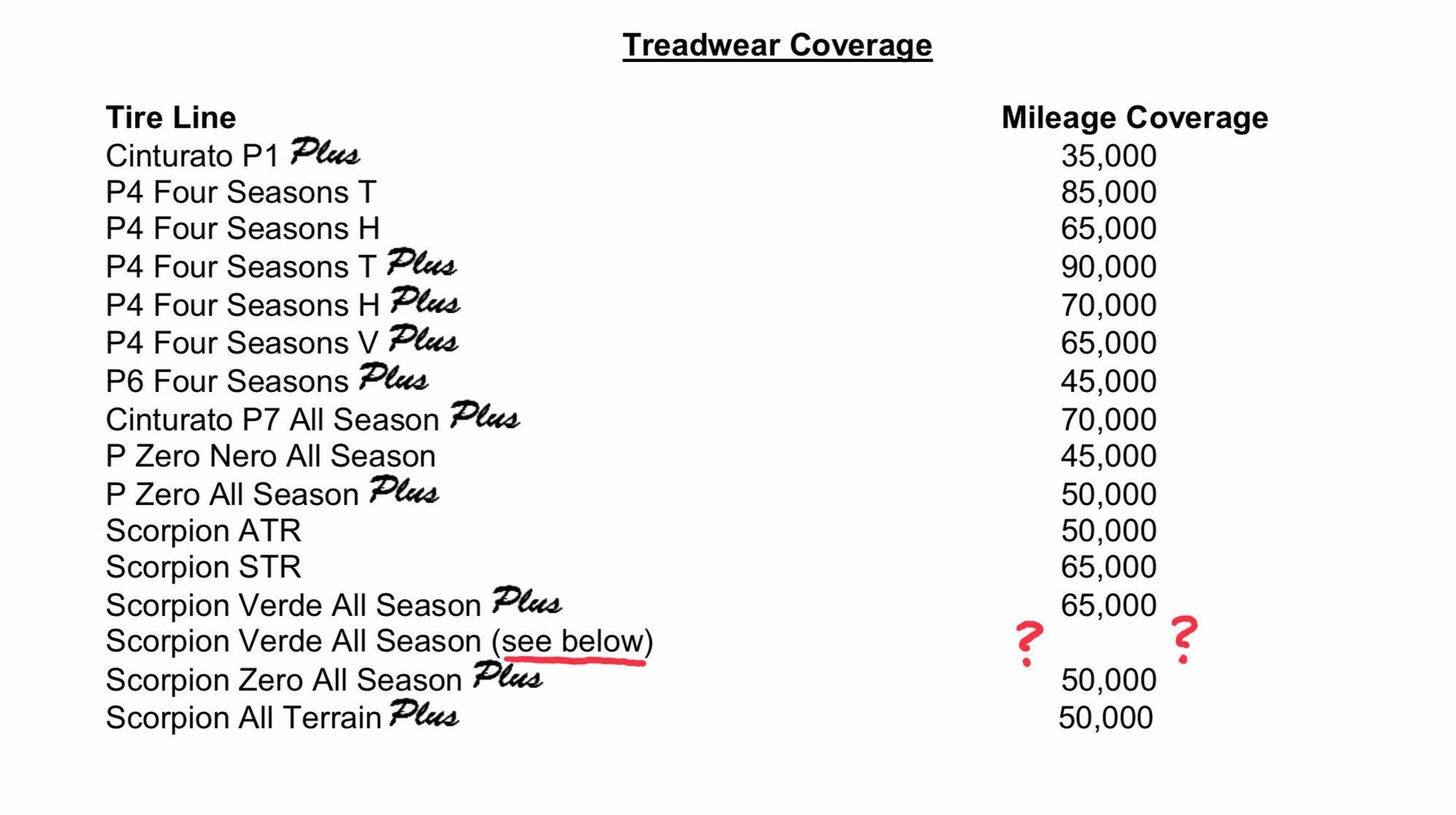

Scorpion Verde, you say? Aha! That’s the problem. Here’s an excerpt from my post in THIS THREAD where other Rennlisters suffered tread separation on their Scorpion Verdes:
There have been several complains of Scorpion Verde tread separations as documented here:
https://www.vehicletire.com/Consumer...rde-All-Season
Another interesting find: All Pirelli light truck tires are covered by a tread wear warranty except one — Scorpion Verde All Season. The plot thickens! Do these tires suck? When replacing these, consider getting the “Plus” version which is covered with a 65K mile tread wear warranty. Note: Since these were original equipment, they should be covered by warranty. Replacement tires will not be covered by tread wear warranty.
* All Scorpion Verde All Season Replacement Tires produced on or after January 1, 2014 are not eligible for Treadwear Coverage.
https://www.tirerack.com/images/pdf/warranty/PI0219.pdf
