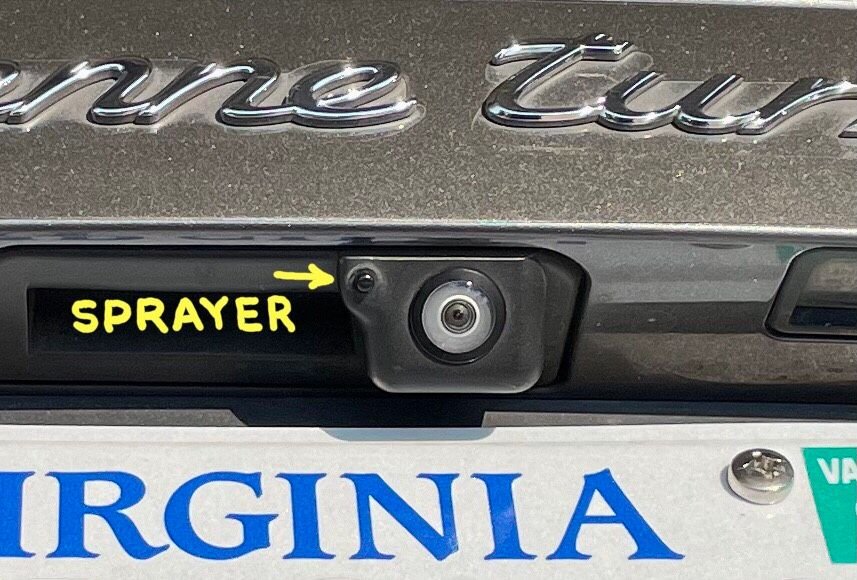

More trivia — when you wash the rear window, the rear camera lens is cleaned with a spray jet. A leaky spray jet valve will allow dripping and causes blue streaks running down the license plate and bumper as in this thread:
https://rennlist.com/forums/cayenne-...up-camera.html
