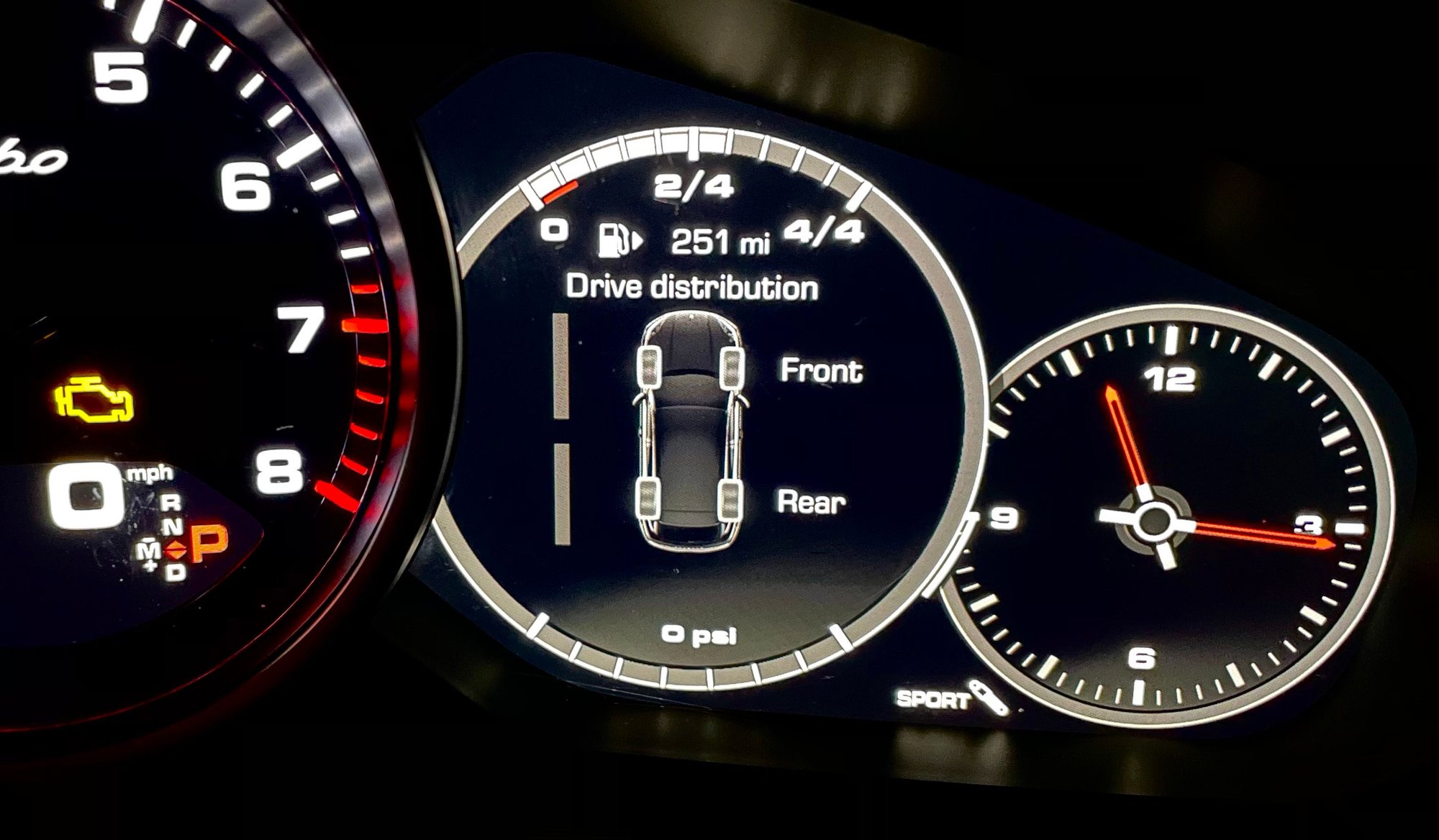

You can monitor your drive distribution in real time on the instrument panel. Use the right scroll button to select the drive distribution screen, pictured, below:

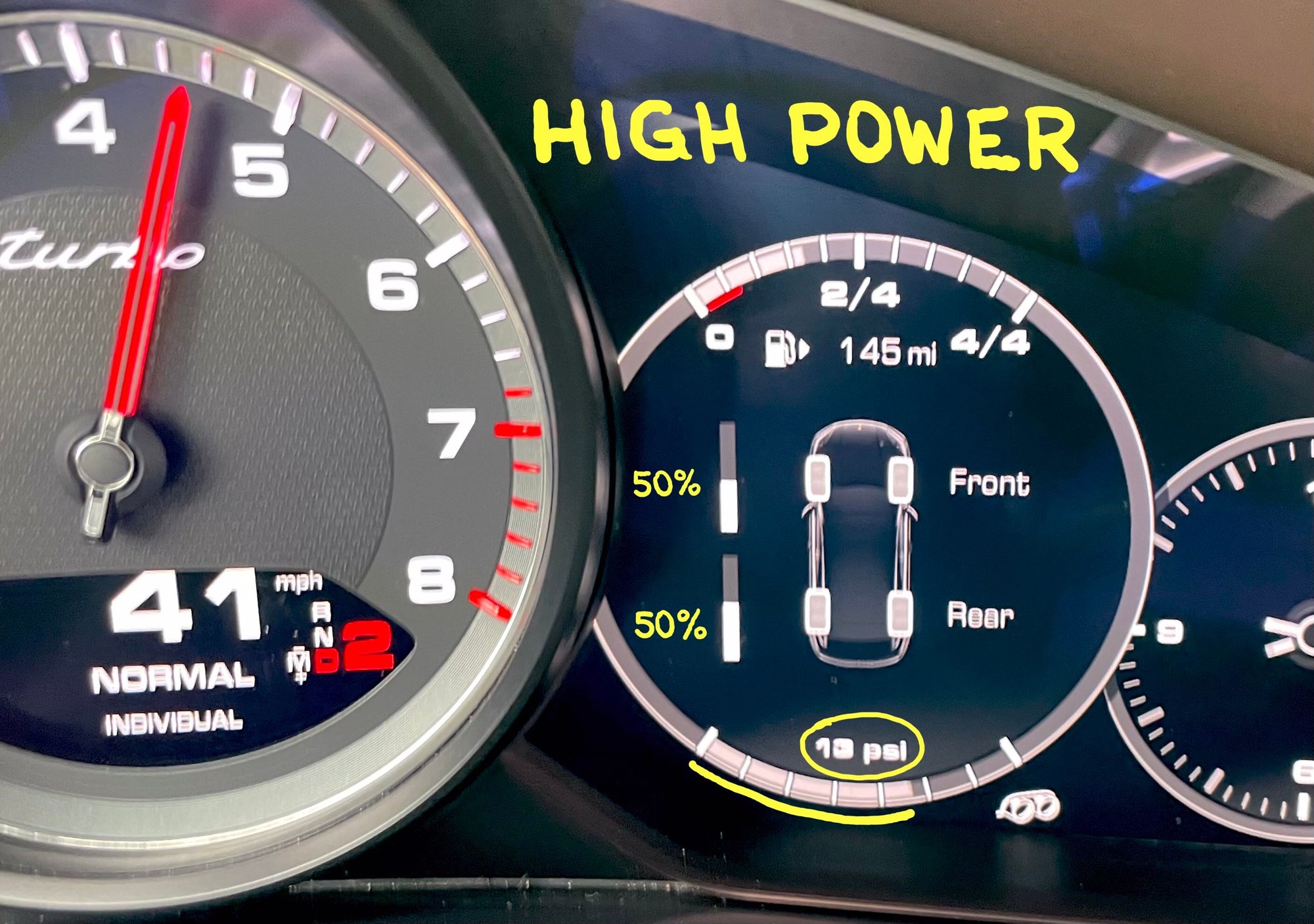

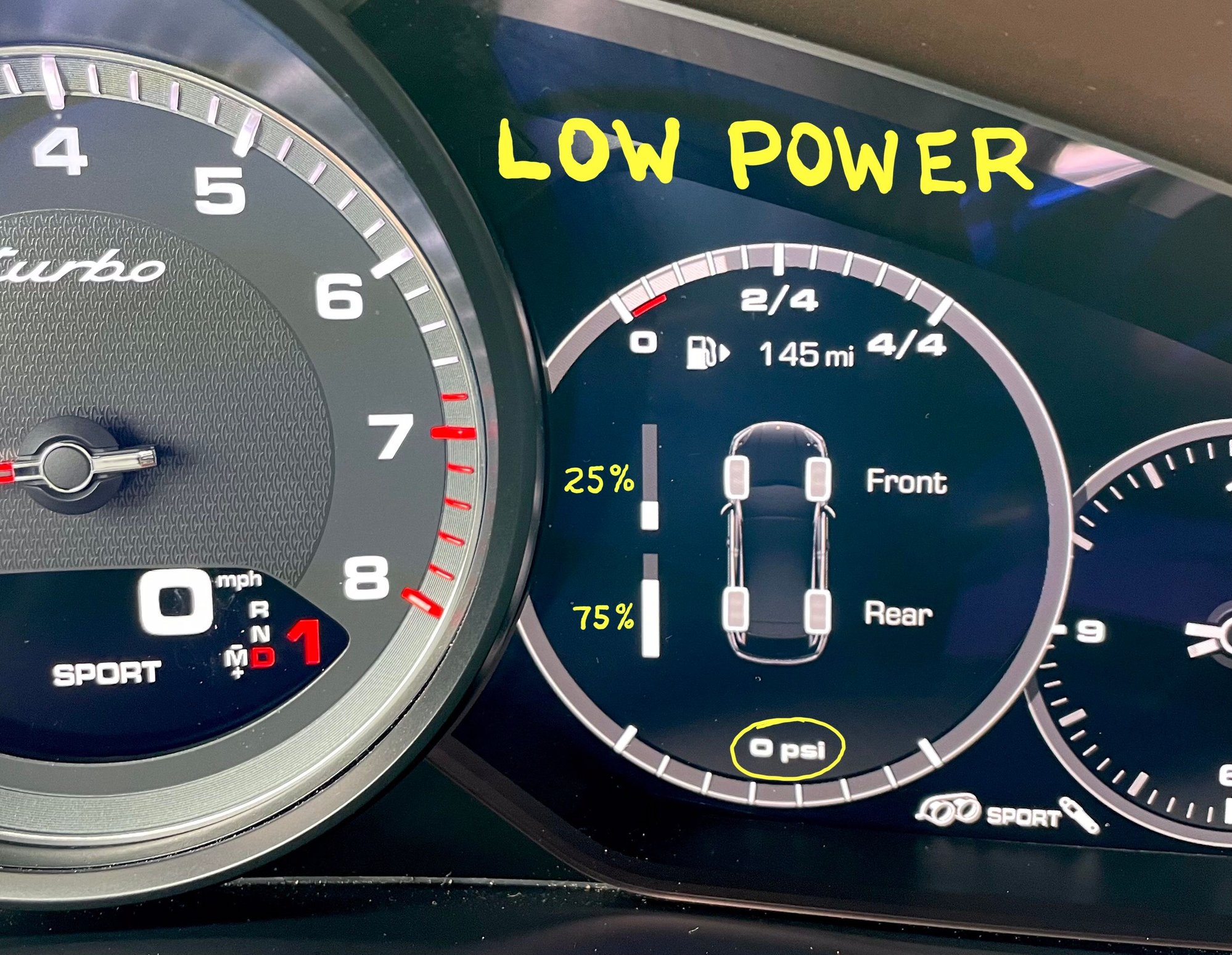

I ran a little test to see how power affects drive distribution. Conducted on dry pavement. Wet / Snow would presumably produce different results.
  • During low power, cruise, and engine braking, drive torque was steady at ≈ 75/25.
  • High power showed a torque shift to the front axle; about a 50/50 split. This remained steady from about half throttle up to full throttle.
