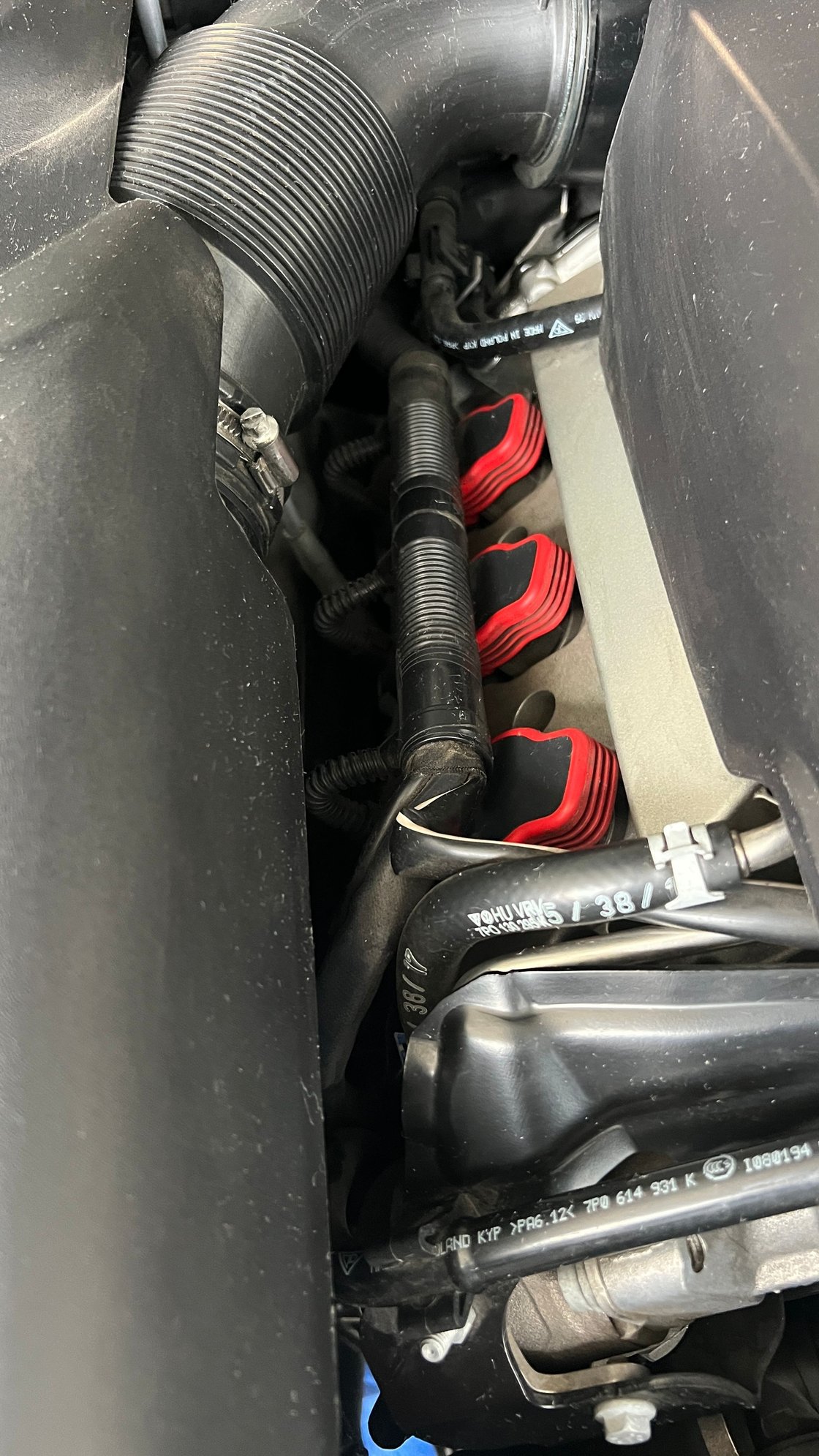

I'm at 45,000+ on my 2020 Cayenne e-Hybrid and well aware of the need for timely spark plug replacements on my V6 Turbo. So, I chose to start with an exploratory trip under the hood to see everything in 3D. Although I grew up rebuilding and replacing engines, what a joy this trip has been because of this thread!!!
One complication I'm presented with is I have the e-Hybrid battery cooling fluid reservoir riiiiiiight in the way of the driver's side cylinder bank. I haven't read or seen any posts where ​​​tricks to evade that bugger are described, so I thought I'd pose that question in this thread. Does anyone know whether that's going to be a speed bump, or a Mount Everest for me?
Driver's side cylinder bank. The hybrid battery cooling fluid reservoir is that white plastic tank.
