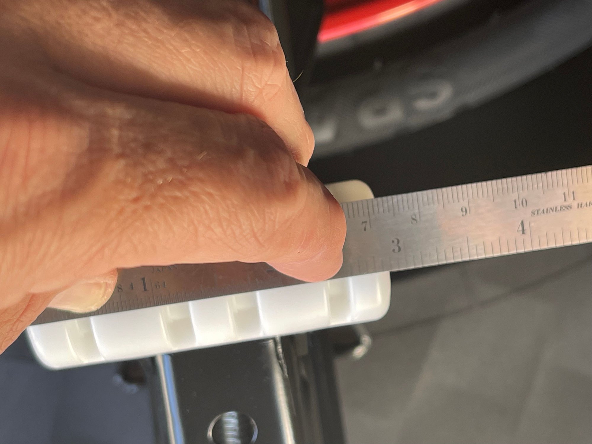

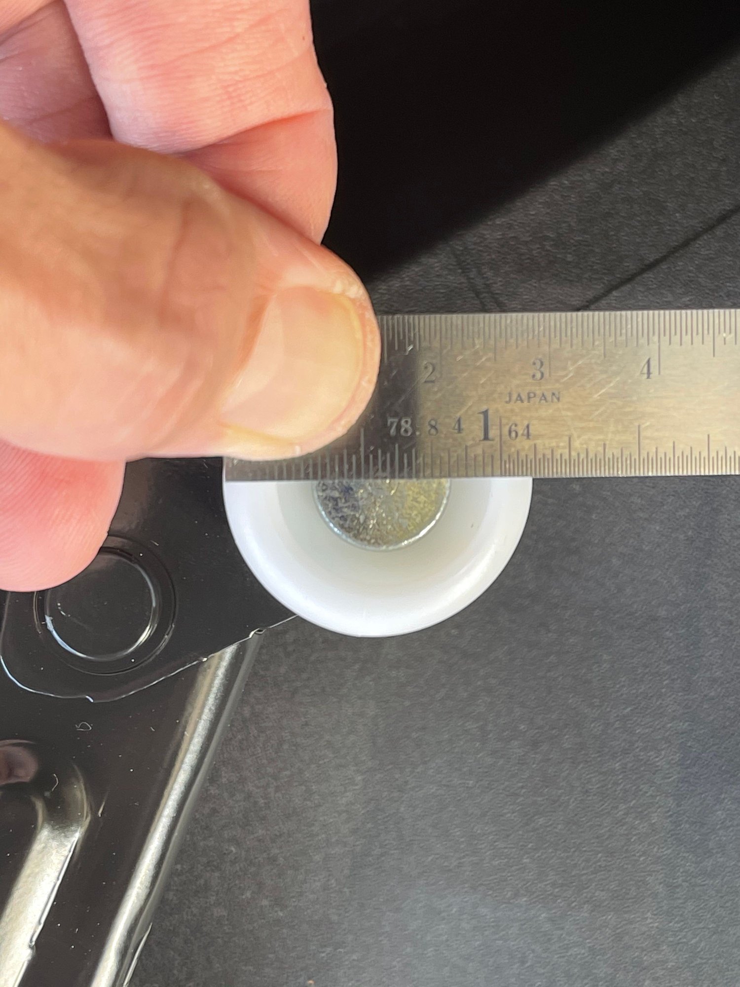

My "mostly accurate" pictures/measurements of the Porsche jack from my (wife's) 2019 Cayenne S:
2 7/8" in length
1 1/8" in diameter

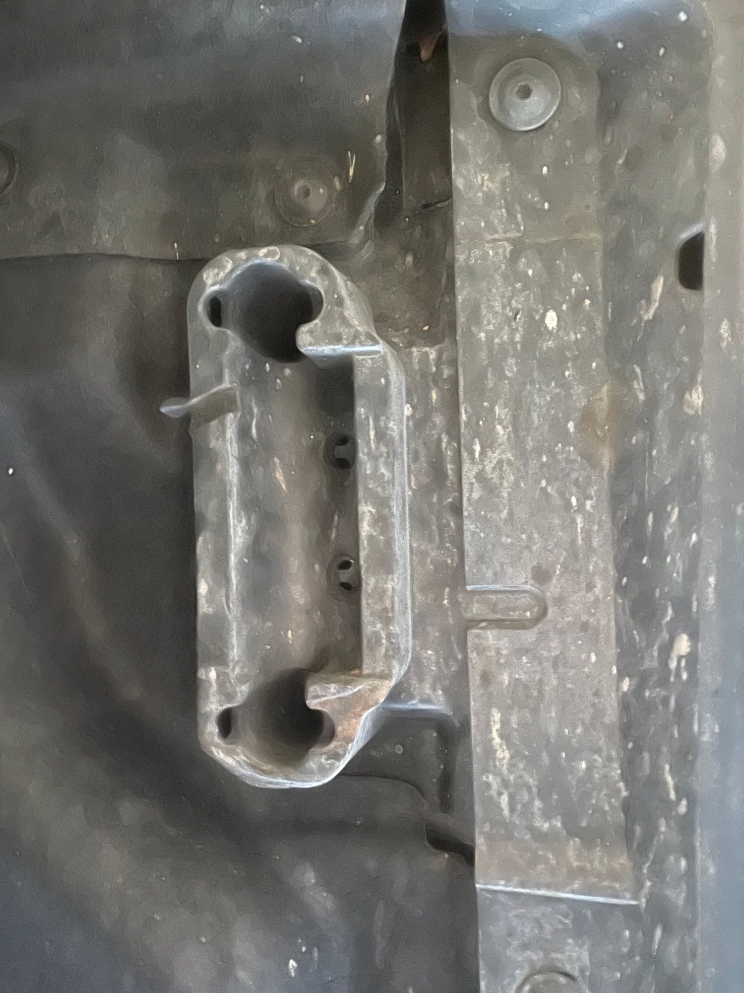

I'm looking to do the same thing. CSR from SafeJack yesterday told me that 2019 Cayenne has a pinch weld for jack point and that standard pads will work. Needless to say this didn't inspire much confidence. I think the Tesla/Porsche adapter (18M-P08) would work pretty well - has a 0.375 or 3/8" circular stud with a rubber cap on a wide base. Stud fits inside the jackpoint and weight of vehicle supported on flanges of jack point. The one they recommend (18M-P13) uses a 2.75" long piece of 1" square tubing welded to a base - weight will definitely be borne by inside surface of the jackpoint, but it is fitting square tubing into a radiused receptacle, which I am not sure if that is a problem or not. The Audi R-8 adapter (18M-P13) looks to be the best fit using a cylindrical piece welded to the base and from your measurements and mine, is pretty close to the included Porsche jack. Again the contact is the inside surface of the jack point, but with a convex curved surface articulating into a concave curved surface. I think that one is the best option, and was hoping someone else here had taken the plunge.

This is most definitely not a pinch weld.
