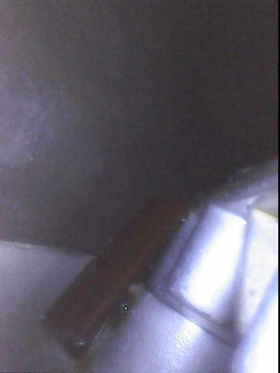

I tried to poke with my borescope towards center and I see this orange/brown plastic piece. Not sure what to make out of it. When you say the middle guide, are you referring to the guide on the main chain (crank-to-center) or the bridge guide between the banks?

Seeing an orange-brown plastic piece is good news, provided it's still hooked onto the frame of the guide. I'm talking about the guide for the main chain that runs between the cylinder heads. The chain travels from the cylinder with the oil fill cap (I'd say passenger side cylinder if I knew you were in the US) towards the other cylinder head. The chain moves clockwise when looking at the front of the engine. Between the heads is a large, horseshoe shaped guide with an orange-brown plastic liner piece that the chain rides on. That plastic piece can fail by breaking up into small chunks, so that the chain ends up rubbing on the metal frame of the guide. When the plastic liner is gone the length of chain needed between cylinder heads is shorter, causing the mismatch in cylinder timings.
I'm having a hard time orienting myself with your picture. There are 3 main guides that are plastic lined. You want to look directly horizontal, towards the engine centerline, across the top of the sprocket+chain right there inside the oil fill opening. You should see the start of the liner for the big chain guide where the chain starts it's downward path to get over to the other cylinder head.

Here is a video I made, I tried to follow the chain path down towards the center of the engine:
Your guide is toast - it has no more plastic on the visible area.

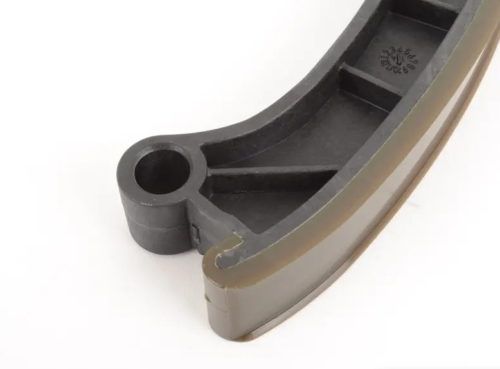

Yeah, your liner has failed. At :09 the metal piece that the chain is touching should be shrouded in plastic. It should look something like this, but since your plastic liner is missing you are only seeing the metal part supporting where the plastic hooks over.

So, I was able to sneak my camera deeper and snap this picture, plastic guide is completely missing!!! I got metal on metal situation. I don’t know how this car can even run like this - no CEL, no chain slap noise, absolutely zero symptoms.
