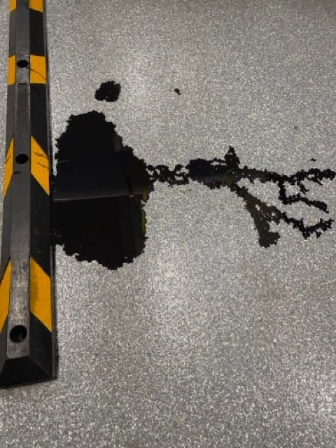

I'm pretty sure that's exactly what happened to me yesterday. Lost a quart in 120 miles of driving, most into the splash pan and then onto my garage floor.
Usually I change my own oil with an extractor from above, but occasionally I like my mechanic to go through the car. And...it had a CEL that wouldn't go away.

it sounds like the dumbest thing in 2025 between me, my independent and even the dealer
but basically it's luck of the draw between drain plugs and washers, stupid car is so sensitive but now I've learned to just to keep my independent stocked with 10 pcs of ea of my personal inventory although he and I both have fits when we even think about dropping the oil from below
the drops collect in the splash pan, till it reaches the volume that it can over flow and and dirty the hell out of the floor and the rest of the under tray of the car so off to the DIY car wash with my 104 degreaser
