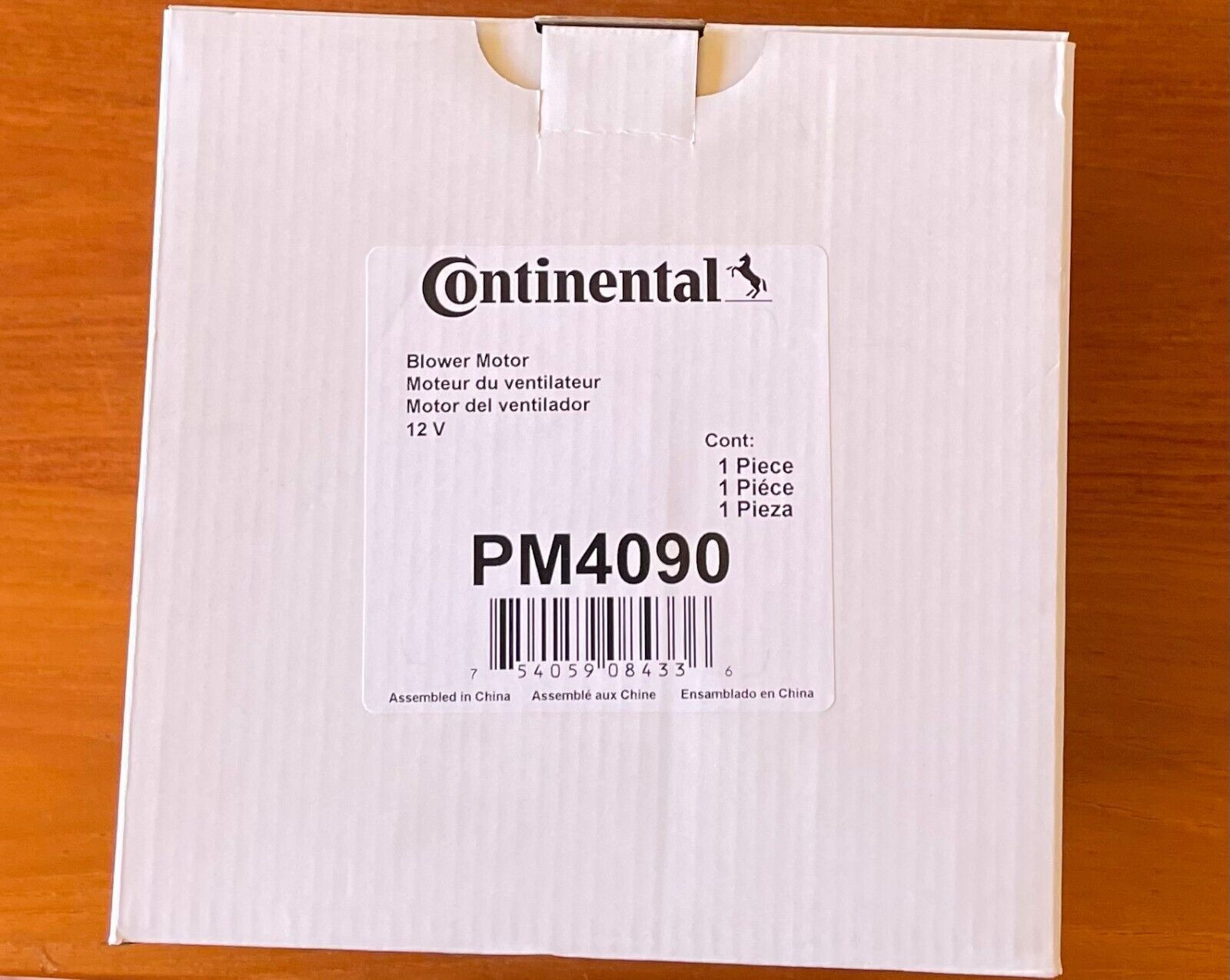

I just installed the latest PM4090 revision in my 12 CTT. Continental acquired VDO and this part is now made in China. I believe you'd need to go OEM VW or Porsche for a European made unit at this point.
The casting is exactly the same as shown in threads here but there were fewer labels on my Continental unit. Replacement unit works great nonetheless. At top fan speed you can hear the motor now. Pretty sure my old unit didn't work at top speed so I have nothing to compare it to. I never run it at top speed so I don't care.
For a little over $100, perfectly happy...

Can you you provide some more substance to your position that the part is now made in China? There certainly could be some sub assemblies built there. I just do not know their supplier network.
Continental AG is based out of Germany. https://www.continental.com/en/
VDO is still a brand but is now obviously owned by Continental.
Now, here is my speculation - as of 2020/2021 Rennlist members were ordering the VDO PM4090 from RockAuto and receiving a rebranded OE unit, made in Hungary
My Continental PM4090, with its 2022 manufacture date, is clearly made in China. The OE labels are not there. But I'll be honest, the plastic/metal castings as well as the fan itself look identical to the VDO unit in older photos.
It is therefore plausible that with the 2020 announcement, and as part of the rebrand, VDO/Continental began off-shoring manufacturing for some aftermarket parts. So whereas previously ordering the aftermarket VDO unit got you an identical made-in-EU OE blower motor, this may no longer be the case. I didn't order mine from RockAuto but I'd be curious to see a PM4090 ordered more recently.
The last thing I'll say is I'm not the biggest critic when it comes to made-in-China auto parts. I rebuilt the whole front end of my Audi with unbranded Chinese made control arms (purchased thru Europa parts in NJ) and they've been great for 3 years with no signs of abnormal wear. As is the case with my Continental blower motor, if it works, it works...
