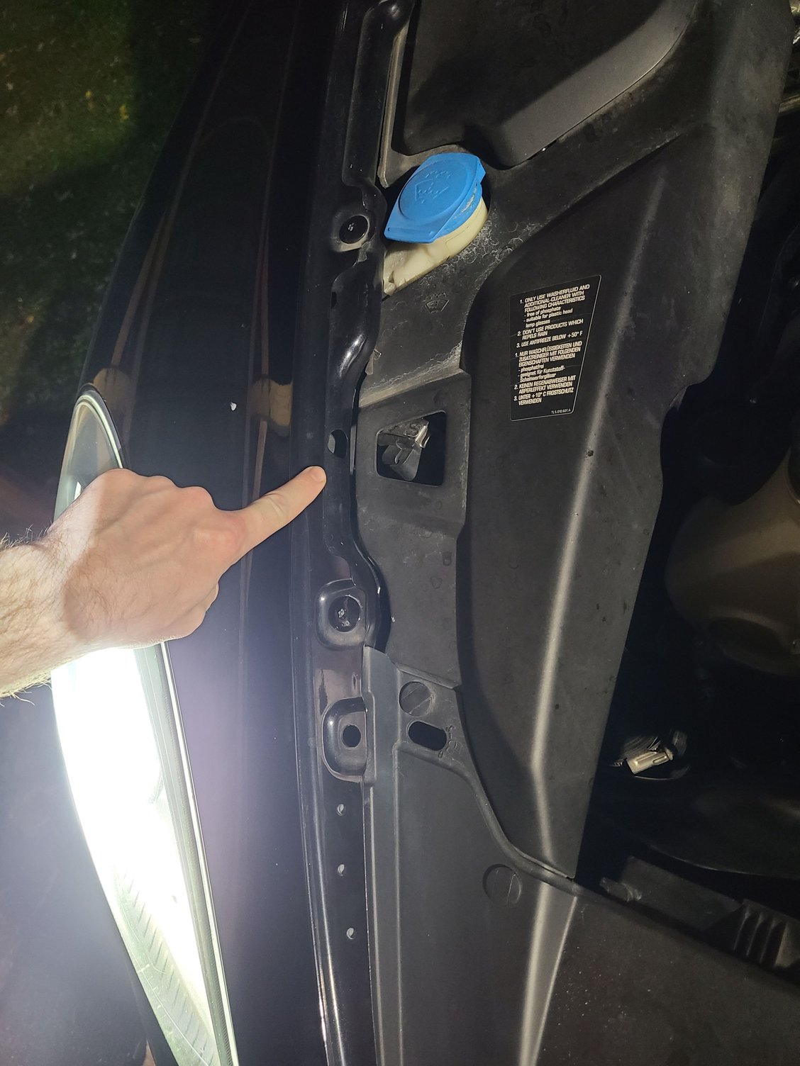

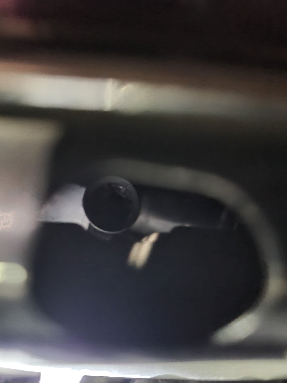

Here is the headlight vertical adjustment port entrance
Looking through it you can see the UN-capped adjustment screw

Are you sure thats what the recall is talking about? That's the head light release thing. You use the tool in the trunk and do a quarter turn to pop the entire headlight assembly out.

you are correct, I was in a rush and didnt realize it. these should be correct
Vertical adjustment port hole

The recall is for horizontal adjustment, not vertical.

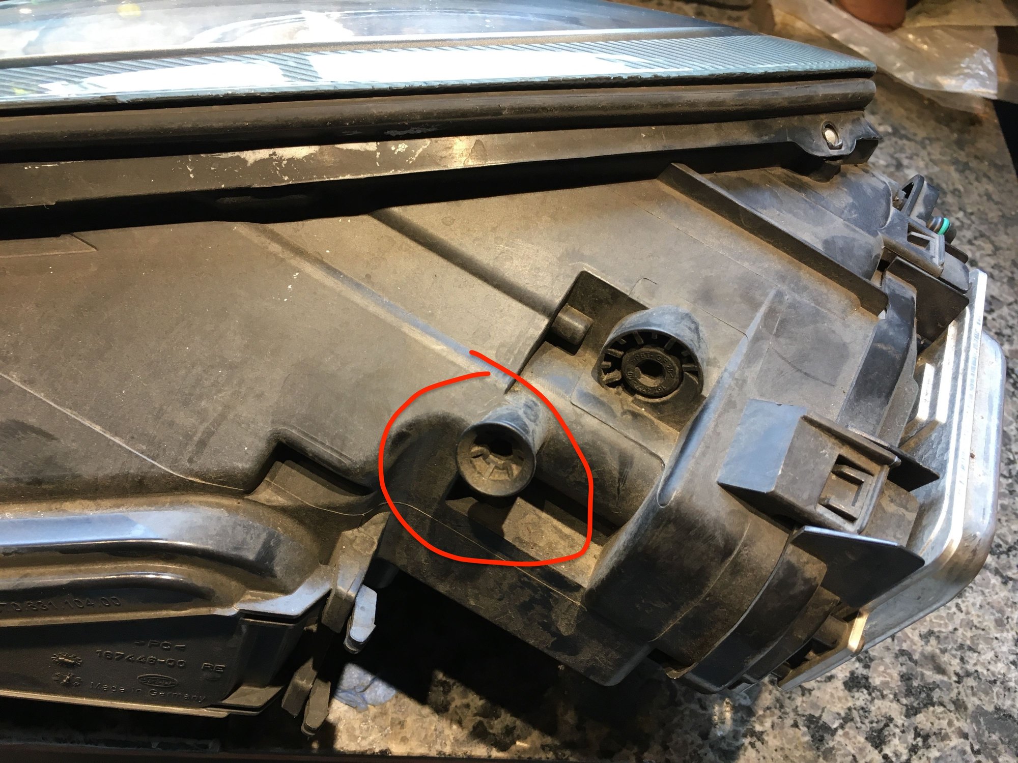

Default is this the adjustment in ANB4?
Is the circled thing the adjustment? Is it missing the cap? What does the cap look like?
No way I'll waste hours taking it in for something so ridiculous, but maybe I can get some caps from them. This is a 2011 Pana4 but nothing is on Pana forums.

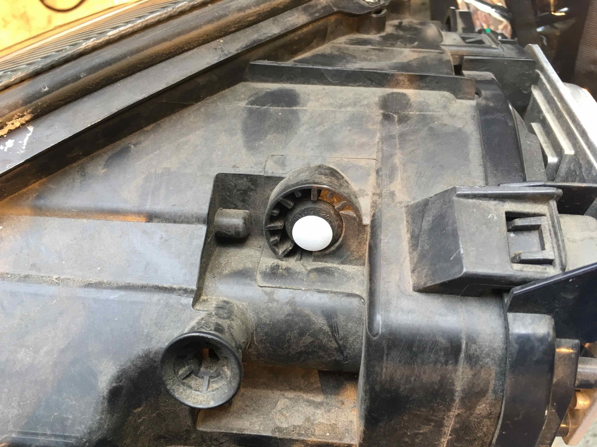

Default Headlight recall ANB4
I was not going to waste time on this recall, but a very knowledgeable Porsche person told me it was more about water leaking into the headlight than beam alignment. He said it happened on Cayennes more than Panas, but he had seen on both. When I took to the dealer, they also said it was primarily about water leaks. Here is a picture of the white plug they added. I don't know if they did anything else, but it took an hour.
anb4 recall plug on 2011 Pana4

Perfect. McMaster Carr for the plug
