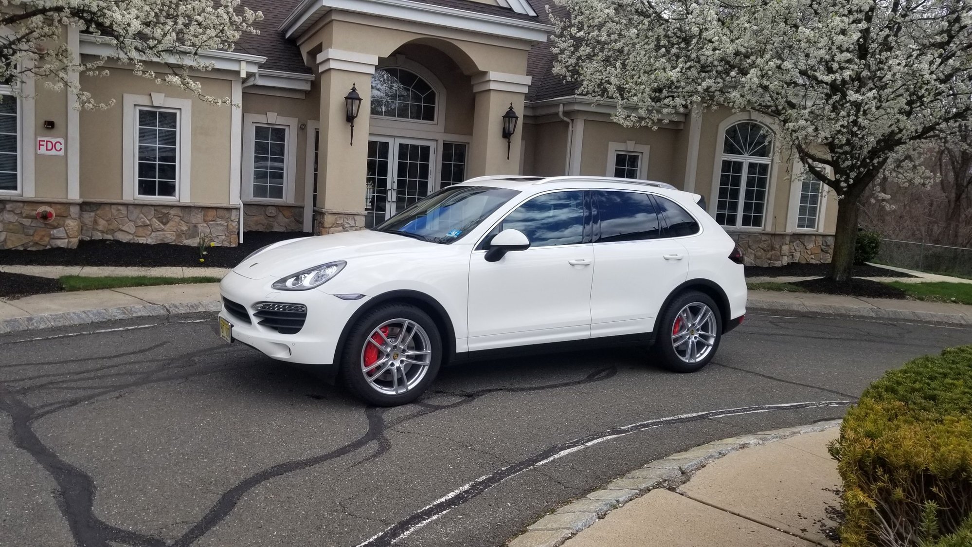

Hello fellow Cayenners (if thats even a word lol) have the 21" Turbo II wheels on my rig now but toying with the idea of going aftermarket maybe 22"
Can you guys post up your wheel set up if you've changed it up?
thanks in advance!

I have Victor Equipment Zehn in 22x10 et50 with 285/35 Continental DWS06+ and lowered on Bilstein B6 and H&R Springs.

2019+ cayenne sport something or other
