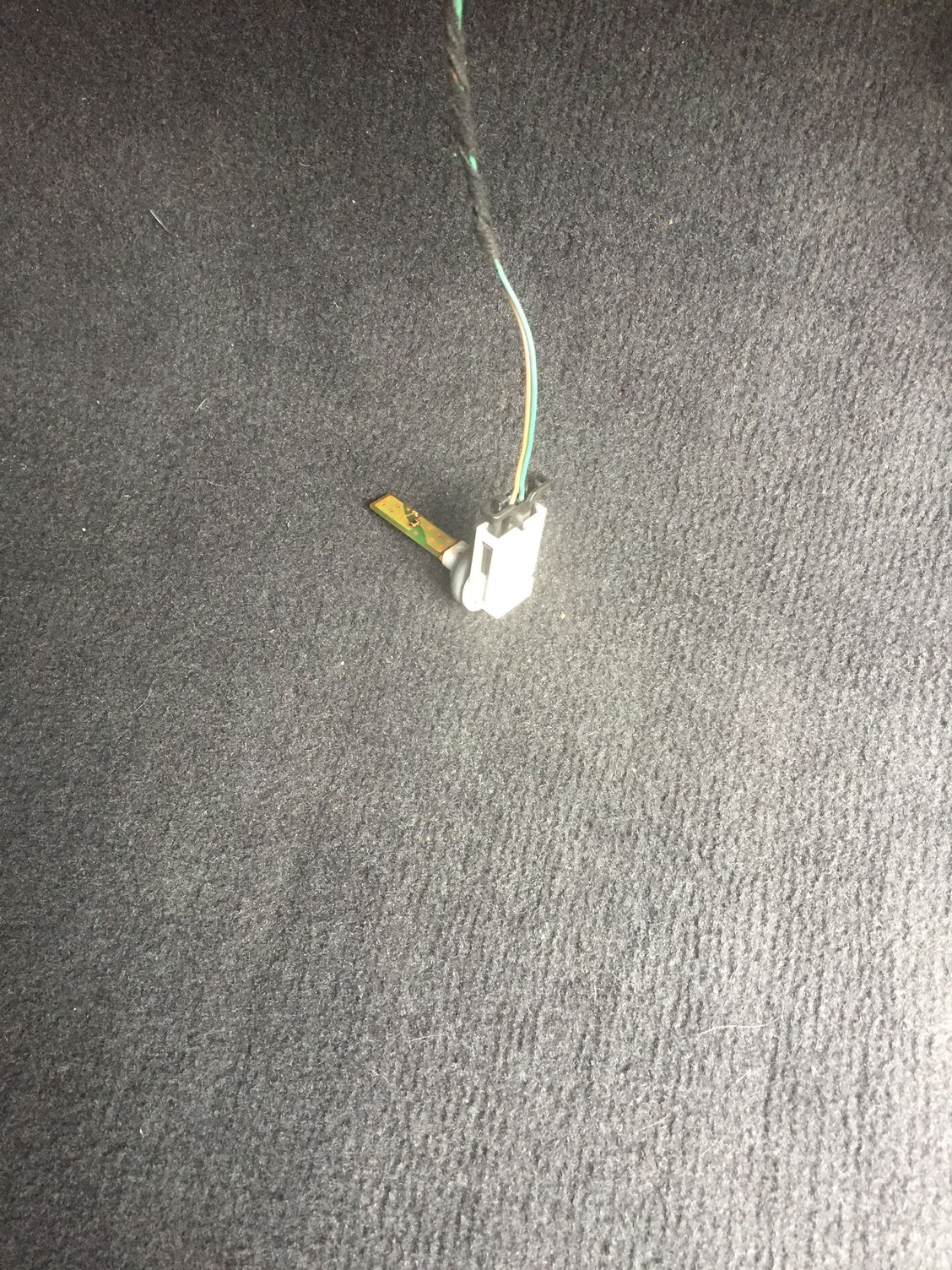

please help,I Found this plug loose when changing cabin filter i can't locate where its belong to ?

Plastic plenum underneath...there’s a hole there. Goes on the top side of it, temp sensor I believe

It's a temp sensor from the A/C vents. Fits in a hole in one of the plastic a/c channels under the dash.

Temperature (?) sensor that plugs into the left end of the duct that’s right under the glove box. That plate below the glove box that you removed to get to the filter, it’s the duct right above it.

Thank you Guys, I will put it back
