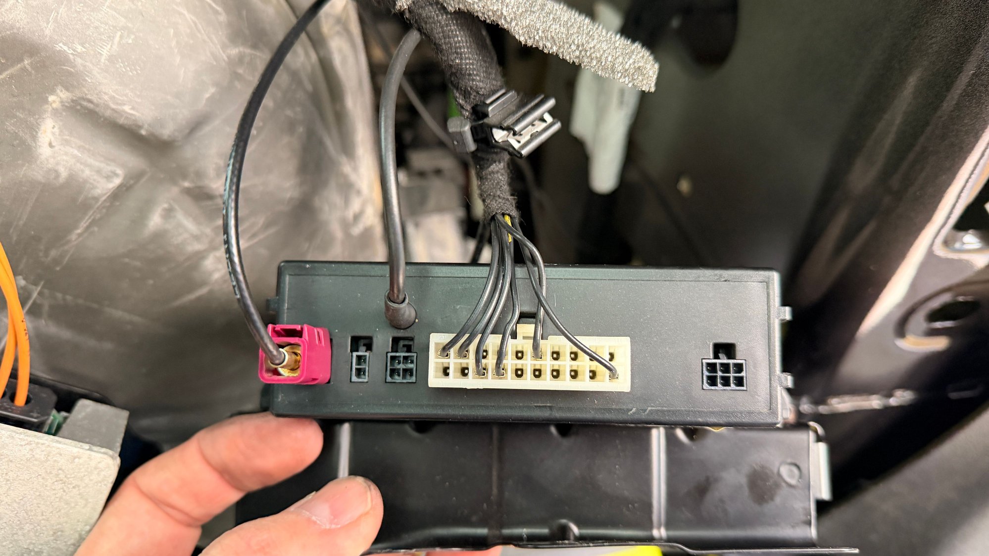

As you may or may not know, some Cayennes were fitted with the Porsche Vehicle tracking system by the dealerships before being delivered.
This system used the 3G network and a GPS antenna, accompanied by two driver tags which should accompany the driver whenever they are with the car.
If you forget the tag, the system alerts Vodafone (the system operator) and they can track and remotely disable the car by cutting out the starter circuit.
These systems have a habit of failing - don't forget they are sixteen+ years old now and they have batteries installed in them for backup, which can seemingly explode.
When they fail, they can leave you stranded as you'll no longer be able to start your car.
I decided that was not for me and set about removing it, especially as they also contribute to battery drain, due to being energised the whole time.
Here's where the unit is and how to remove it and not leave your car bricked.

When I unplug the unit the car wont crank, so there is definitely a starter inhibitor somewhere.

Having done some testing with a multimeter, I've managed to find the immobiliser circuit. All bypassed and VTS removed.
