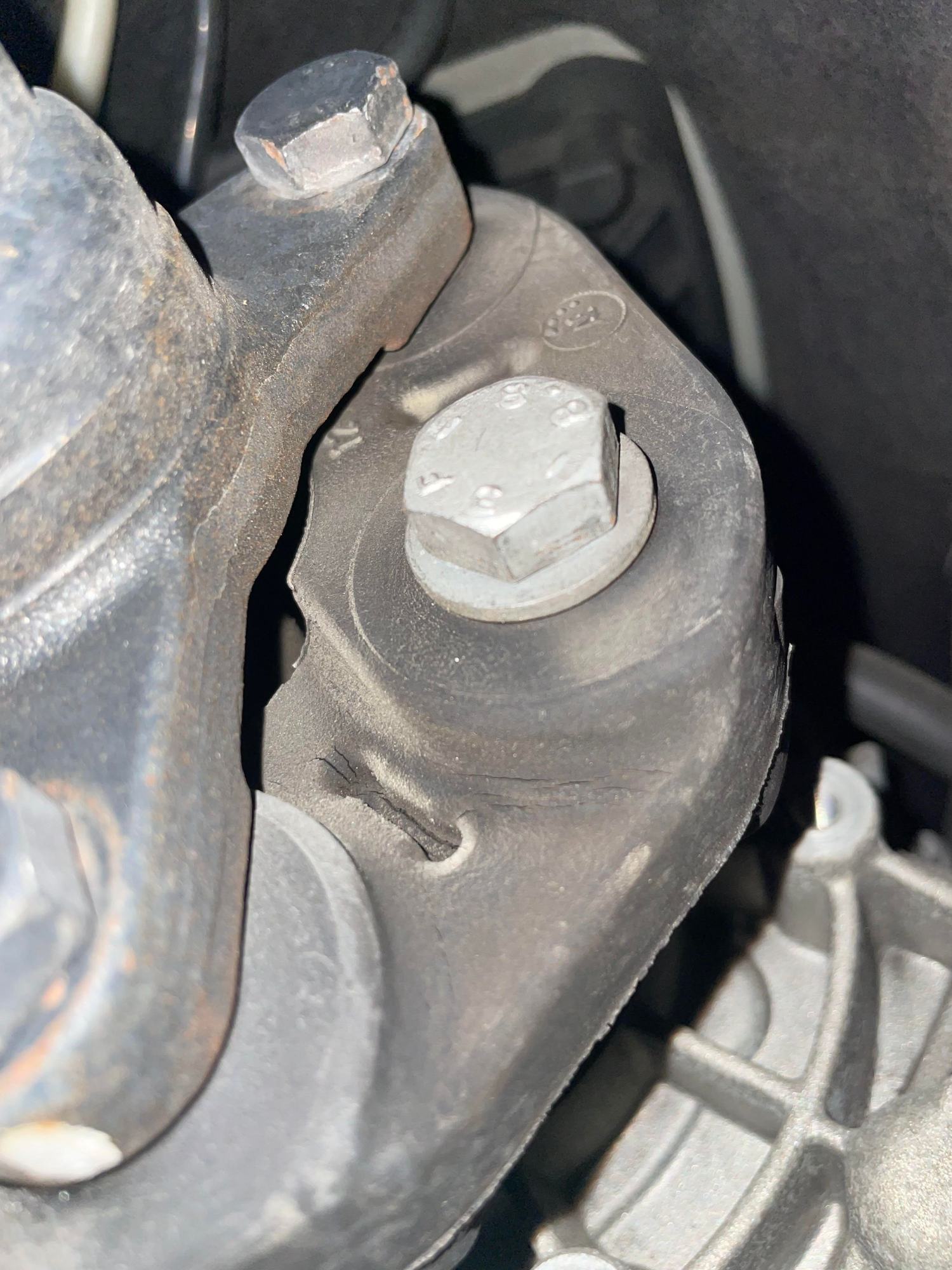

Yesterday an intermittent vibration began coming from what feels to be the center of the car. It will stay for a few minutes then disappear for about 20-30 minutes before emerging again. Putting the car in neutral, and switching between gears does not affect the vibration. I did bearing checks on all the wheels, then removed them and hand inspected every bolt I could find around the control arms and CV joints, but the bearings felt fine, and I could not find any loose bolts.
Since it appears to be coming from the center of the car I wonder if it is the transmission mount? Would any one have any advice for how to further investigate this vibration?

Originally Posted by waybomb
Driveshaft center bearing
Thank you. This looks like a much bigger job, I was hoping it was some other wear part on the drive shaft like the transmission mount. It appears to me that these pieces has been changed by PO due to rounding on the bolts. But they still look fairly worn. Perhaps he used cheap afternarket parts? IT does say KOREA on the Trans mount..

Originally Posted by Brian Pines
transmission mount
That is not replaced by most folks ...unlikely yours was either
And yes OEM mounts are South Korean ...Lemforder
Read on about angry midgets
As noted, most likely the center bearing on the drive shaft. Easy and inexpensive to fix. Many have done the jimi fix, some replace the drive shaft assembly, I went with the EPS bearing mount. 60k miles later, no issues
