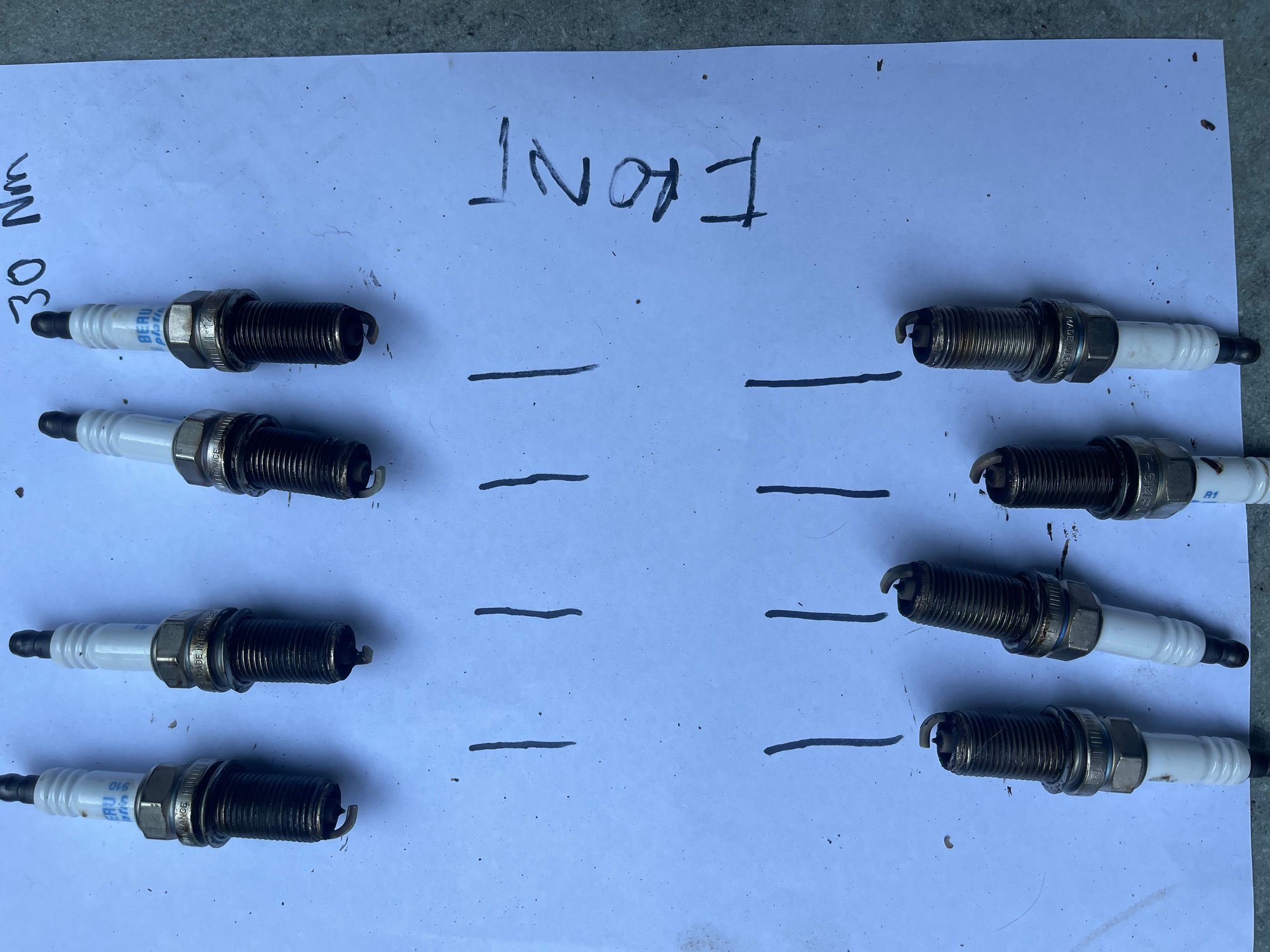

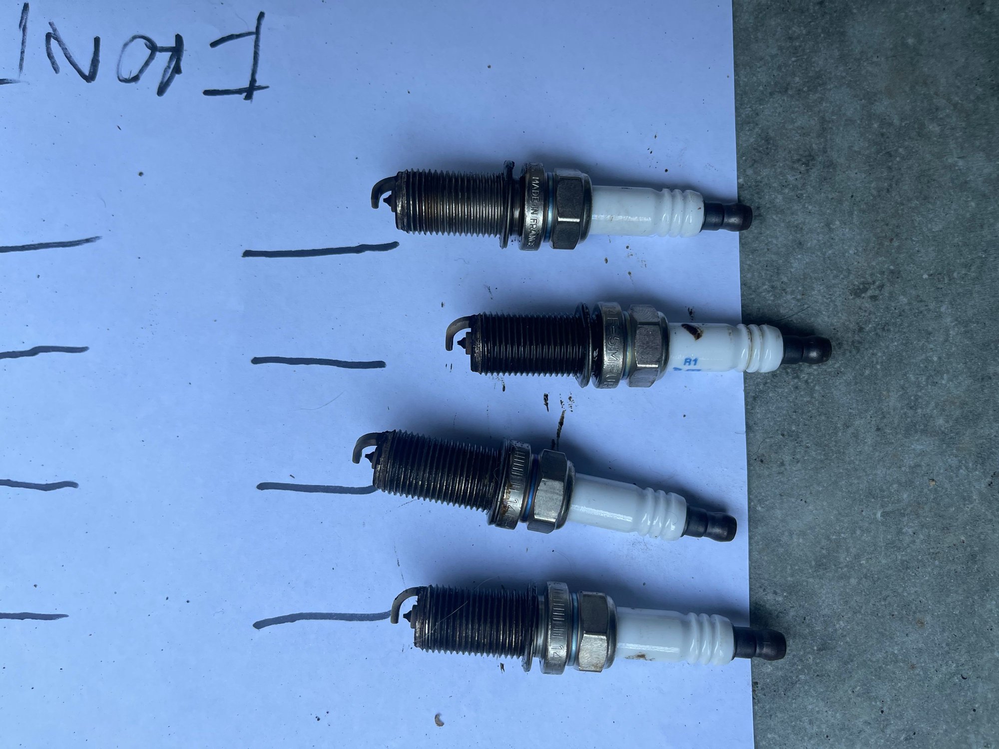

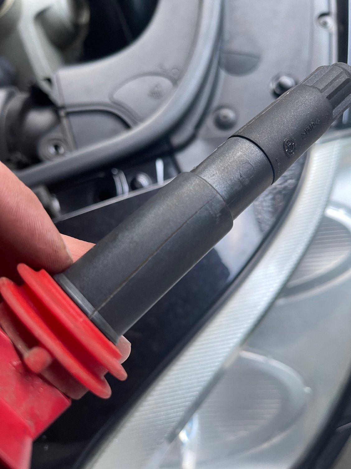

Well after looking at walking past unopened parcel from Pelican Parts near the front door for the last month, I finally decided to swap out the plugs and coils yesterday. Glad I did. Every coil had at least one huge crack a couple of inches long. Im guessing they were original (128K Kms). Plugs had typical oil on the threads suggestive of valve cover gaskets leaking but the tips all looks good. The result is a smooth idle now. Throttle response is better too. Very pleased overall.
