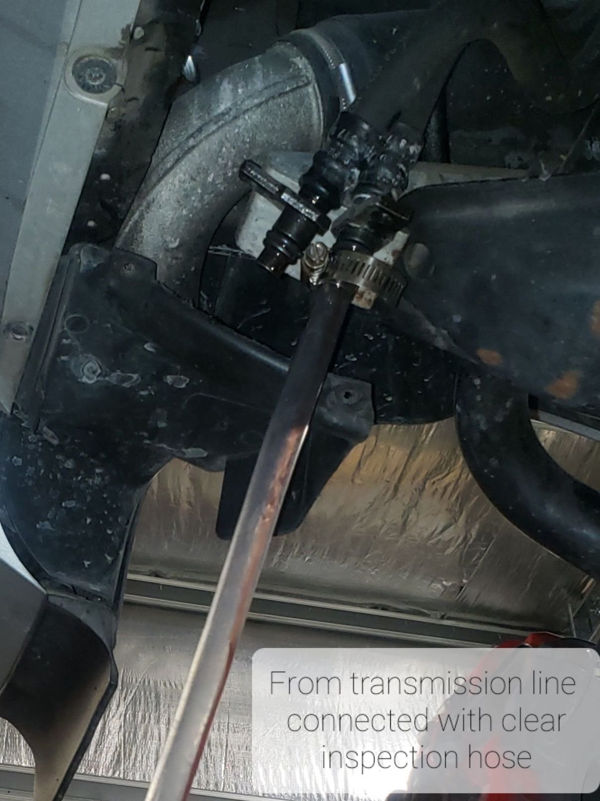

I then located transmission thermostat at front right of vehicle.
Thermostat located at front right of vehicle
Step 3
Remove green bolt and pull fittings out of thermostat housing.
Lines removed from thermostat housing.
Step four
Attach clear hose to the line from transmission and place into a bucket.
My helper started the car with hand brake on and foot firmly on brake pedal then moved through gears whilst pausing in each gear for 5 - 10 seconds.

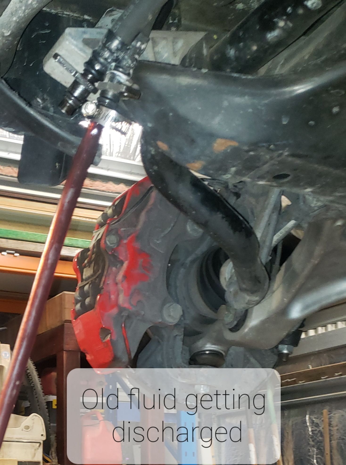

whilst doing this I was monitoring flow to bucket and at same time pumping new fluid in through fill port. When discharging fluid transitions from old to new ( you will see it )
Old fluid discharging
Have helper stop engine. reconnect lines back up then fill transmission back up and follow previously posted methods for filling to correct level.
