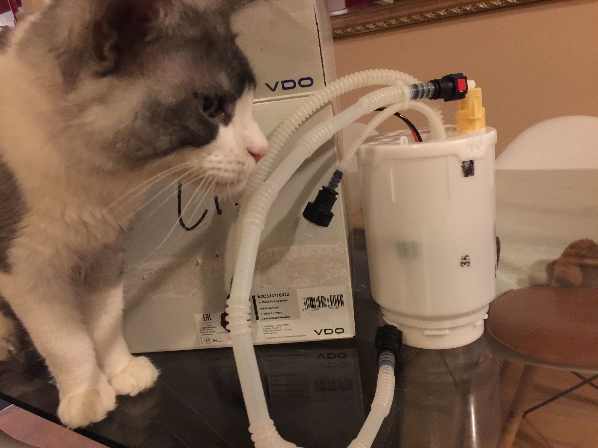

inside is a pump which looks different from the new one i had already .
the new one is a VDO which according to PELICAN is matching the car.
please check the pictures .
the old one has a edge and is not plain on top / red marks
the old one has a hose connection / red mark - which the new one dont have
i am confused.

the left pump inside looks the same like the one which is displayed on the DIY write up from a friendly Rennlist Member.
https://rennlist.com/forums/cayenne-...p-routing.html

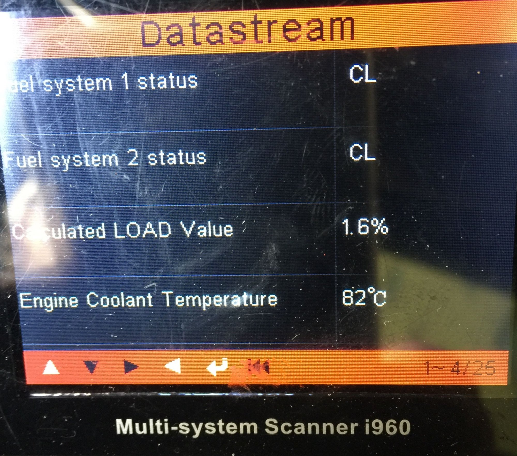

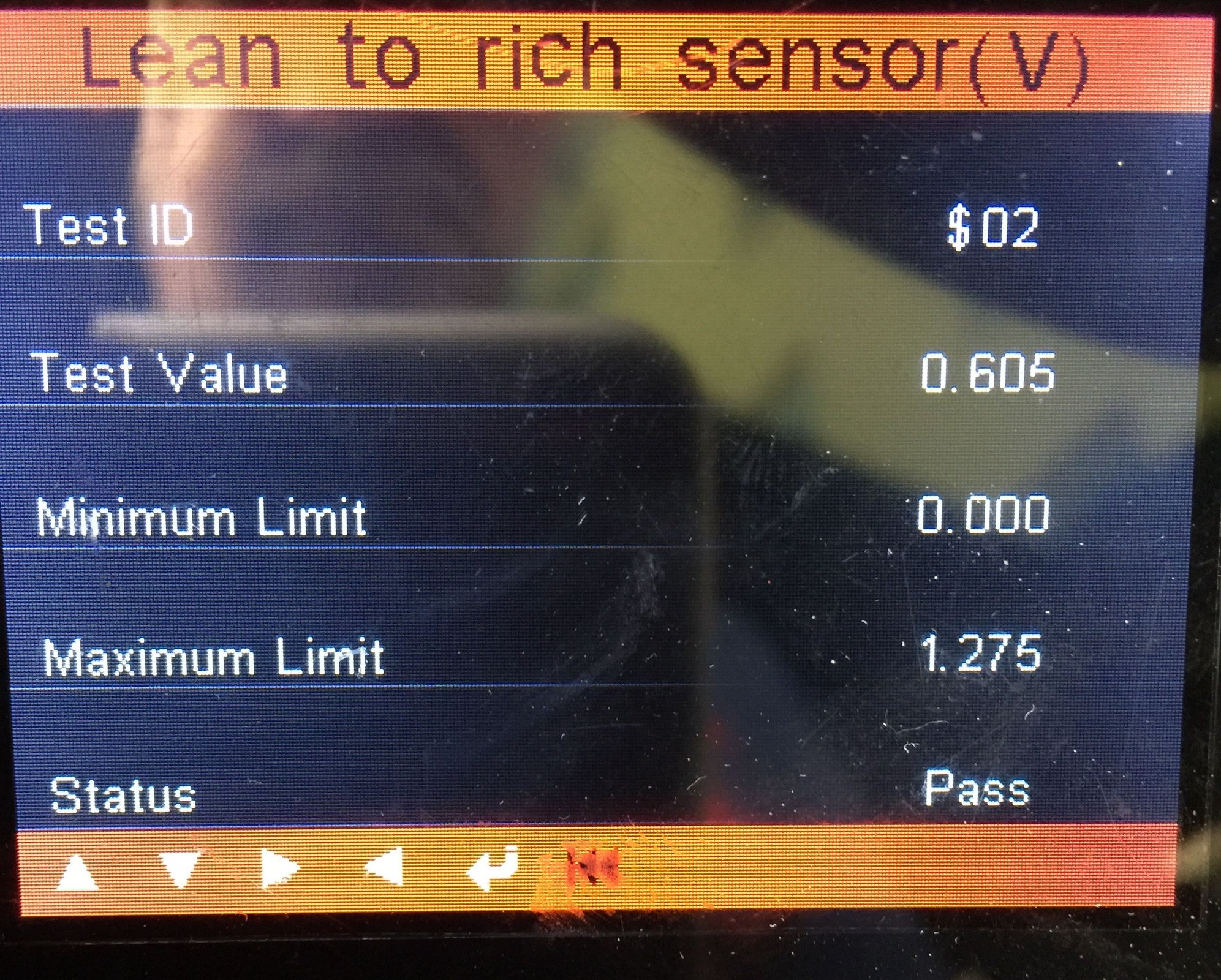

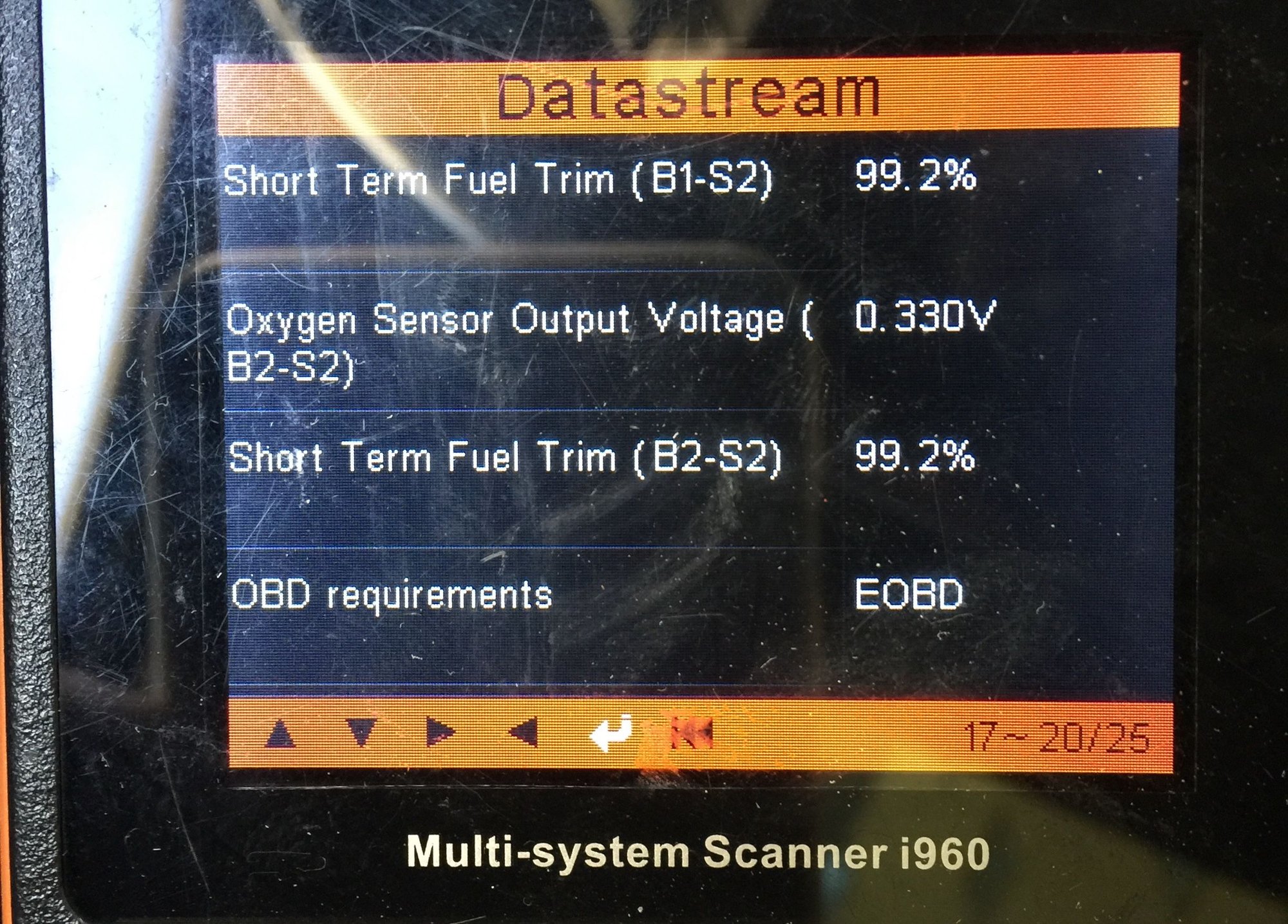

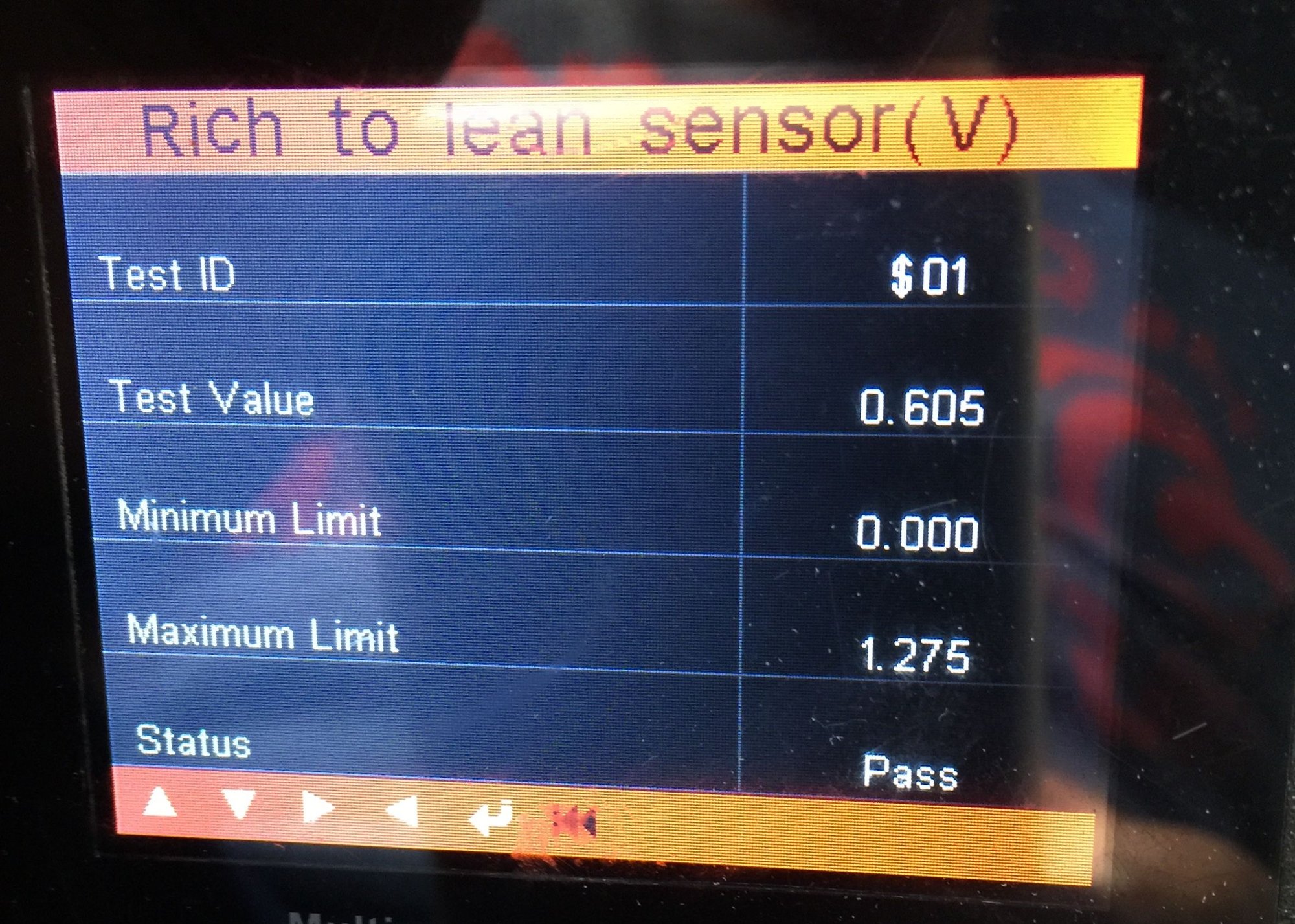

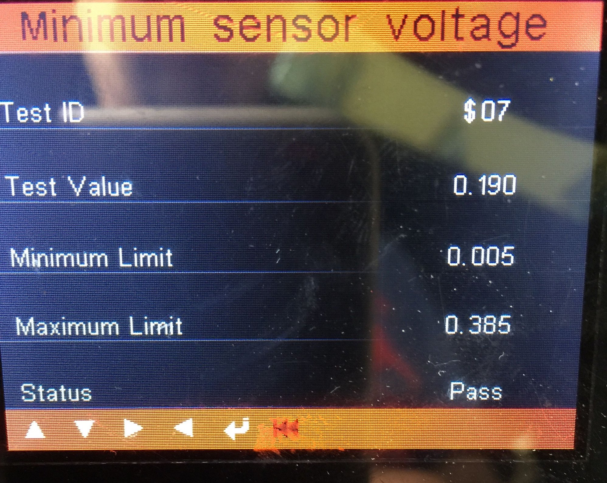

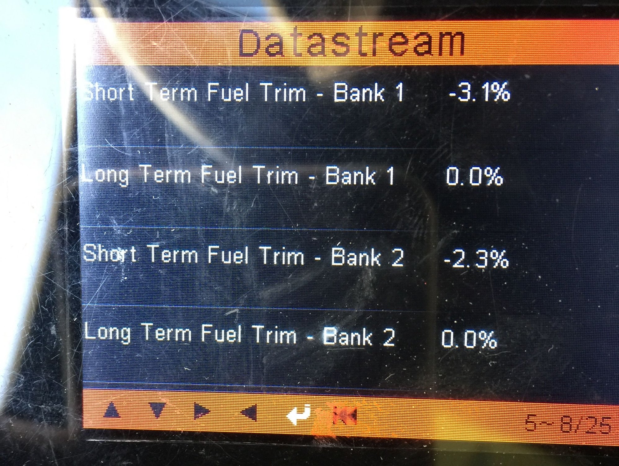

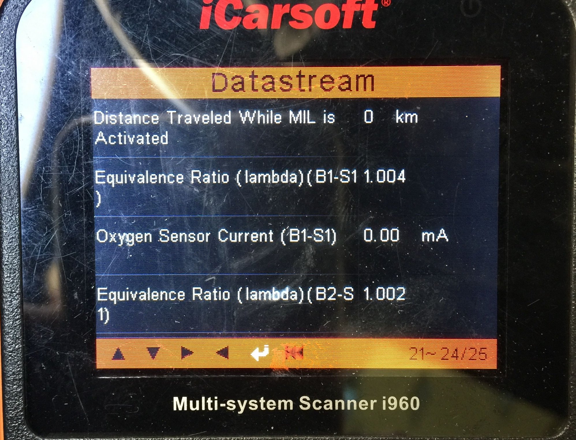

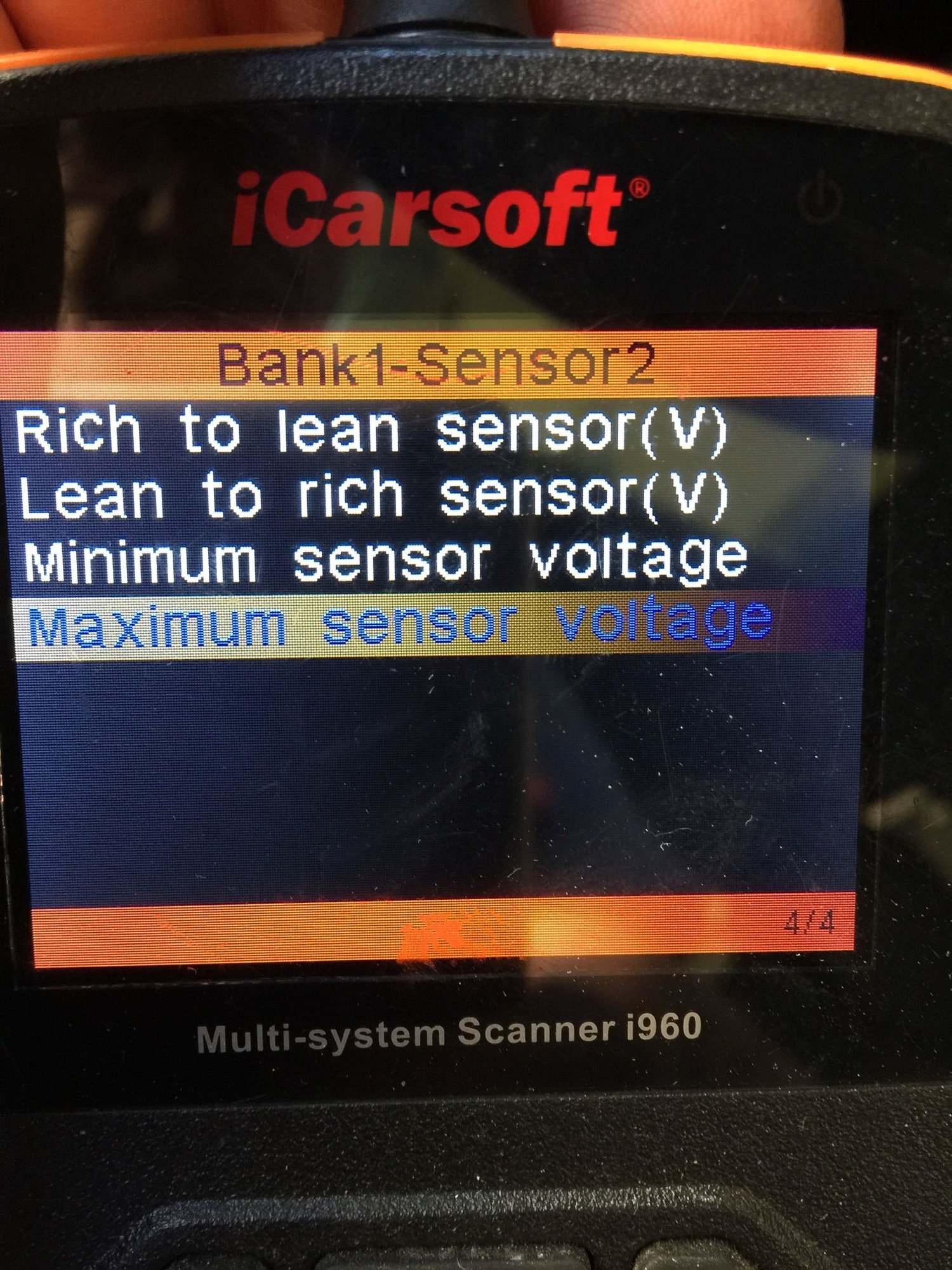

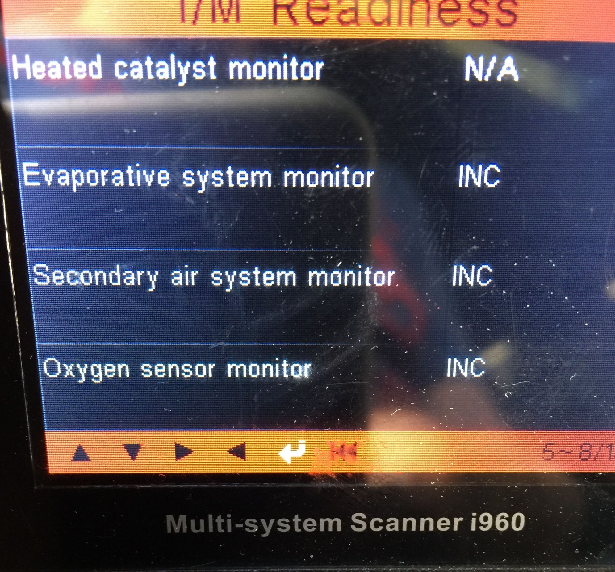

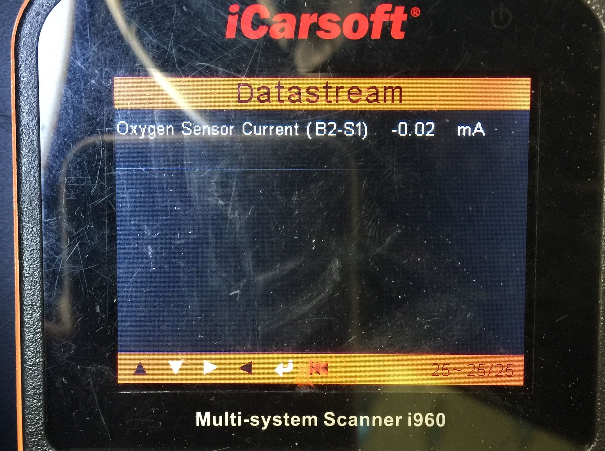

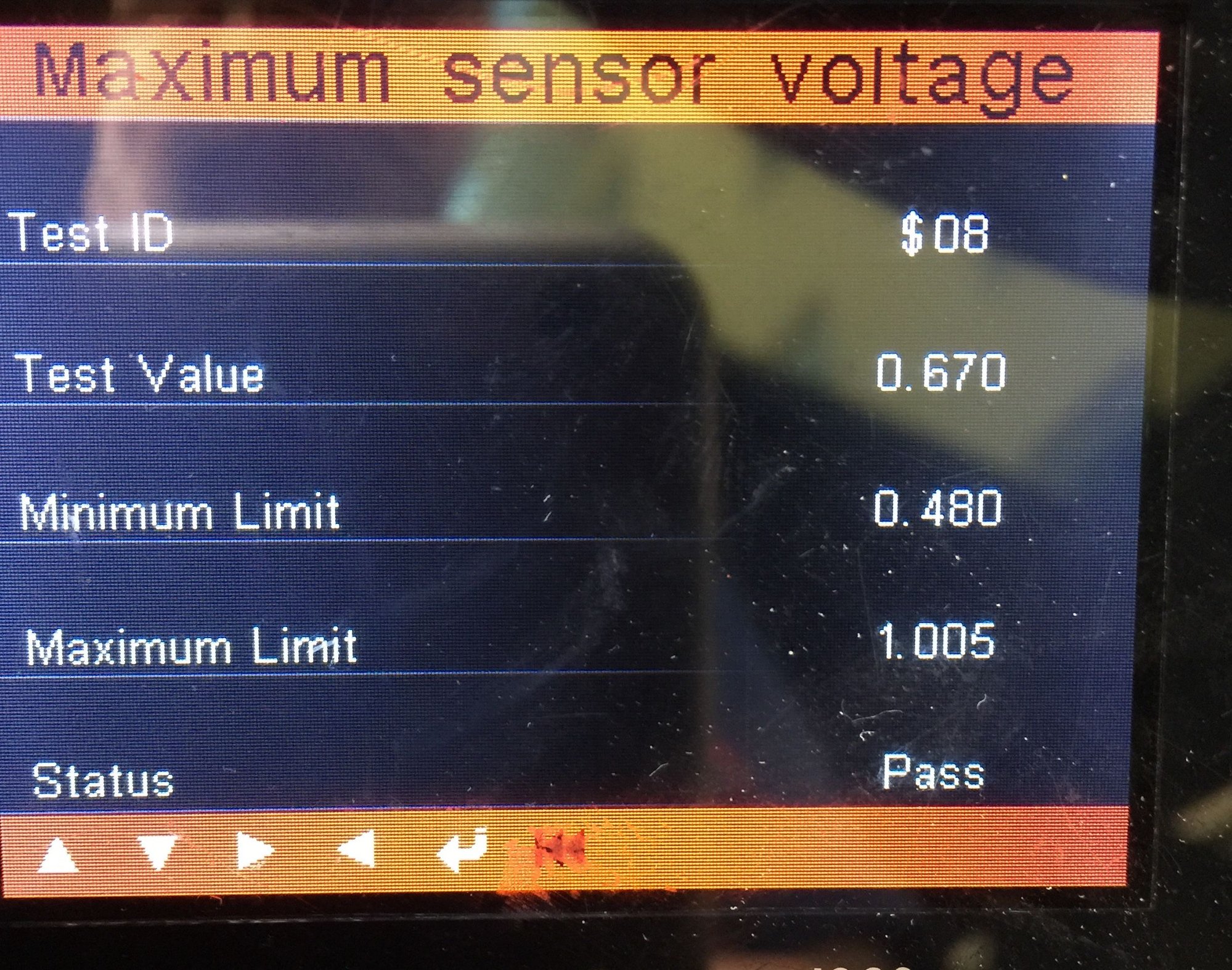

Sorry to bother you with this problem. I am going to show you the reading from my OBD tool. Maybe somebody can read something out of this numbers.
