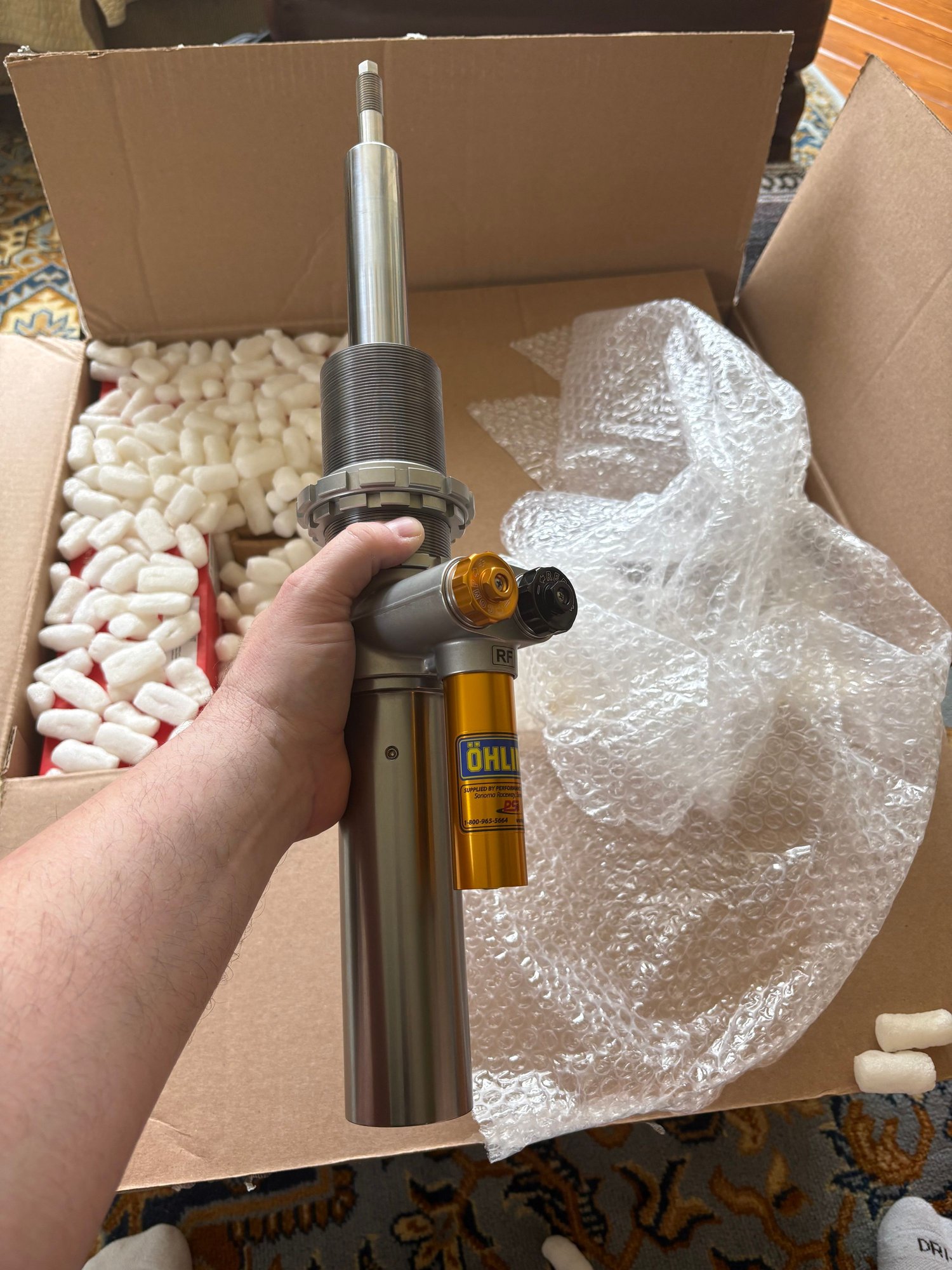

You could end up pretty sad specing an ohlins damper with their DFV if the tuning doesn't match your driving style. Compression and rebound adjustment on one **** would be a non starter for me at that price point. I just received a set of Ohlins TTX for the GT3... I bet they're even more pricy for the 718, with strut front and strut rear.

At a quick glance it looks like ohlins only makes the TTX for GT car applications. For really trying to be competitive you'd probably be best off with just getting some MCS or similar. Like I said I like the R&T for my low effort, still street driven 981 SST car but they're going to become a liability fairly quickly if you're going high effort. Plus something that uses 2.25" springs will make front tire fitment a bit easier. The ohlins out of the box configuration actually has less tire clearance than the stock struts/springs which was super fun to figure out how to work around.
The tire clearance thing is interesting, especially if that plus real camber would allow a 275 on a 9 or 9.5 to be tucked in front.
I'd probably not go a high-dollar damper route myself... probably do what I'm doing for the CS Cayman: a non-adjustable system where I just get the damping done to my spec (with bump rubbers instead of coil-over springs) and call it a day. Rain? Too bad. Not quite perfect for any particular driving style? Adapt! But, literally hundreds instead of thousands.
