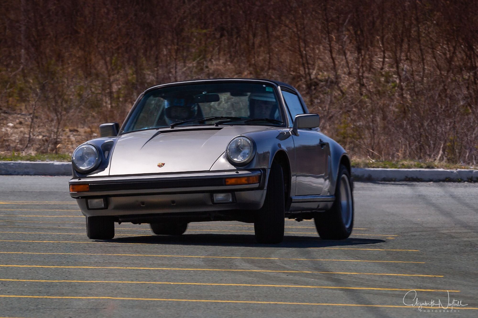

I have adjustable shocks on my car. Left them on full soft for my first autocross. Should I start playing with them a bit for the next event?
I'm unsure what the car needs.

It looks like it needs torsion bars and sway bars! There's no harm in playing with the ***** you have. I assume rebound only adjustment? if you get the rear cranked up too high, it will likely increase the feeling of tendency towards lift off oversteer. If you get the fronts too stiff it will probably make the transition to push quicker when you get back on the throttle. If you end up wildly over damped on both ends of the car, it will end up getting stuck down on the bump stops because there isn't enough torsion bar to overcome the damper. Likely you don't have that much range of adjustment. As you bring the dampers up in stiffness look for some benefit in the transition / slolom feel. If the stopwatch tells you you're not making improvements then you can always go back to full soft. My aircooled car has the konis on the rear where you need to push a button and twist to adjust, but you really needed to take it all the way off the car to accomplish the adjustment. I ended up cutting off the lower part of the metal dust cover so that the adjustment could be made with the top of the shock still installed.

Anyways, as noted above, the photo means nothing - terminal condition is dictated by springs / bars. The shocks are what's doing the work in transition. So they don't control how much your car rolls, but instead the rate that it rolls at. Shocks are most at work at corner entry and in a slalom. In sweepers / mid corner they aren't doing much.
