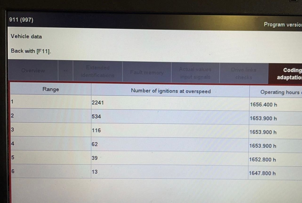

Can someone help me look at this DME report on a 997 turbo with 43k miles I’m hoping to buy.

current operating hours? Not shown on the above
Several threads about how to read the reports

Need total operating hours...

Im going to guess that current hours is really close to the Range 1 hours. The average speed at 43k / those hours is like 25mph. Most I’ve seen are more like 30.
Chris.
