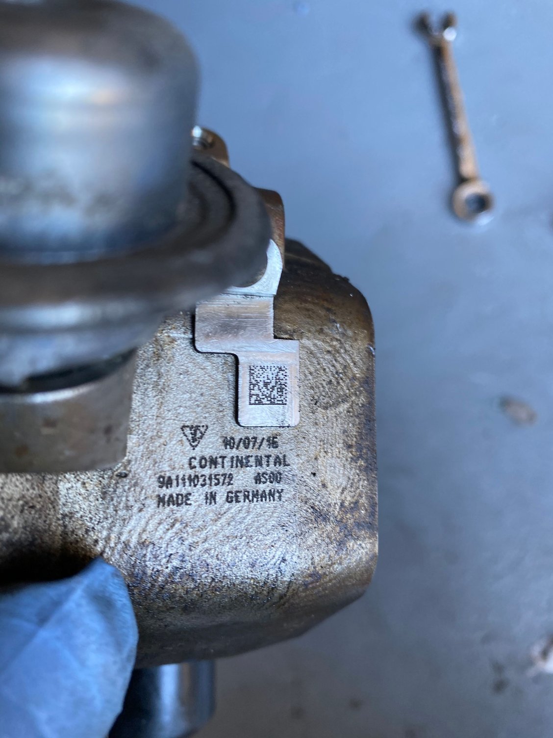

Hi, yes I repaired it using a used high pressure fuel pump from a newer 991.1 turbo (2015) that had about 12k miles on it. It still cost me $1500 for the part but that was better than $2500 they sell them for new online. There is a good DIY article from the 997.2 non-turbo forum that describes how to do it yourself. How many miles on your 997.2 turbo? Do you have a chip tune? (Possibly chip tune wear out the pumps?). I still have the old pump laying around and would like to know if someone does repair these. Let us all know how your situation gets fixed!

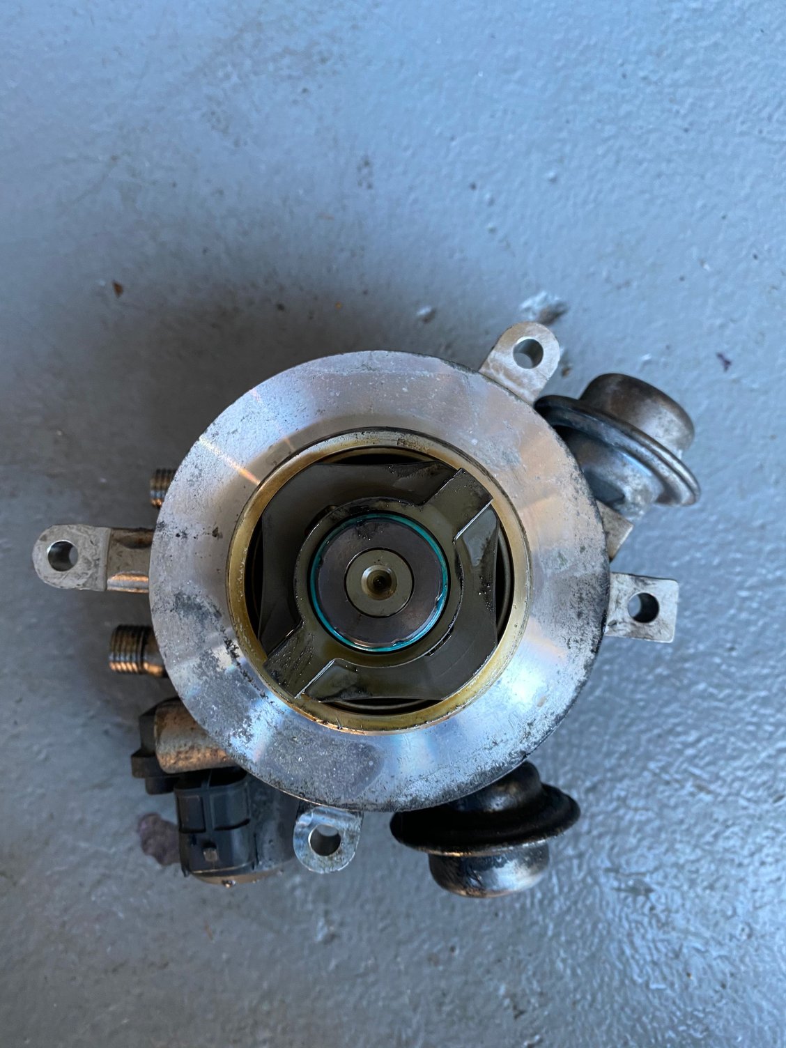

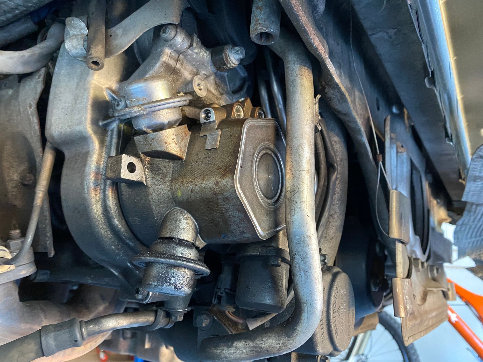

No related codes at all, no delayed start, no idle issues... just a simple leak I found last Summer around the hpfp housing. The leak didn't even hit the floor, although I think sitting in winter may have accumulated on the ground (outdoors so hard to tell with all the snow in PA). This is why I thought simple gaskets as a fix. I believe there are two gaskets 1) hpfp to camshaft 2) some inner gasket.
I thought I read someone's hypothesis that the inner gasket fails leaking oil internally mixing with fuel and eventually leads to pump failure.
Where did you source the pump? I've only seen $2K+, most are $2.5K.
Wet pump
Old Feb 23, 2021 | 05:50 PM
mateush's Avatar
mateush
Joined: Jun 2014
Posts: 18
From: Poland
The small oring is just a seal between the camshaft and the pump rotor. The big one is a seal between the valve cover and the pump body. In my opinion they have nothing to do with the pump and its internals at all.
In your case looks like the big oring is leaking and you have some engine oil mist on the pump and area around. In my case there were also some oxidation between the valve cover and pump body which may also lead to some leak if the pump wouldn't fail first
My suggestion is to clean the pump and leave it as it is.
Although I'm from the other side of the globe the cheapest place to buy the pump was here Shop OEM Porsche Parts Online | Delaware Porsche Parts
