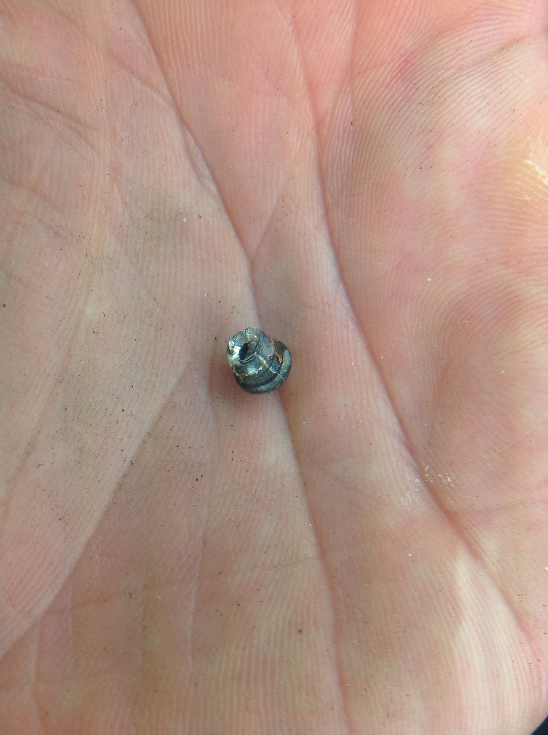

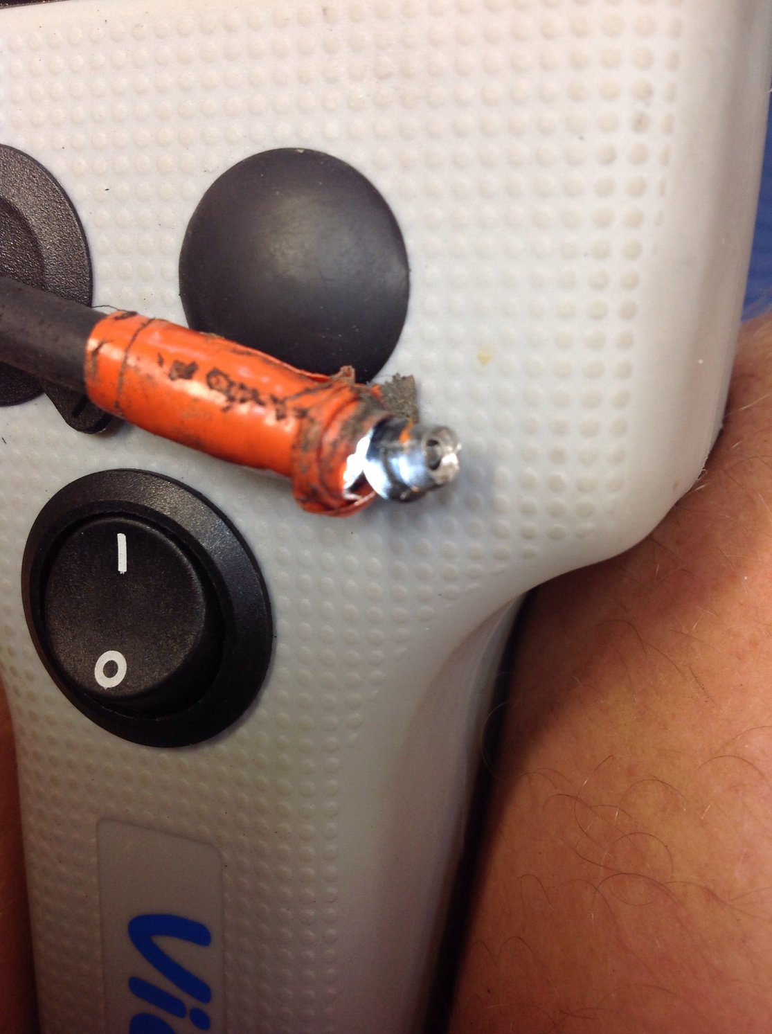

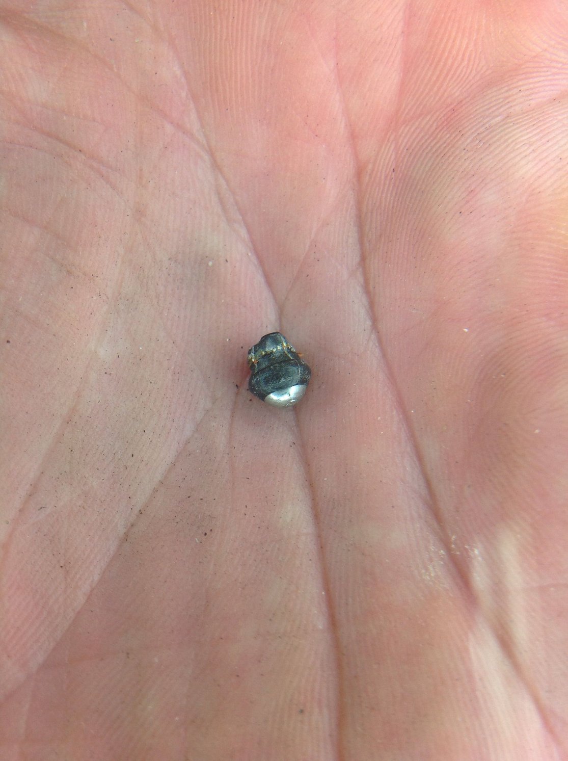

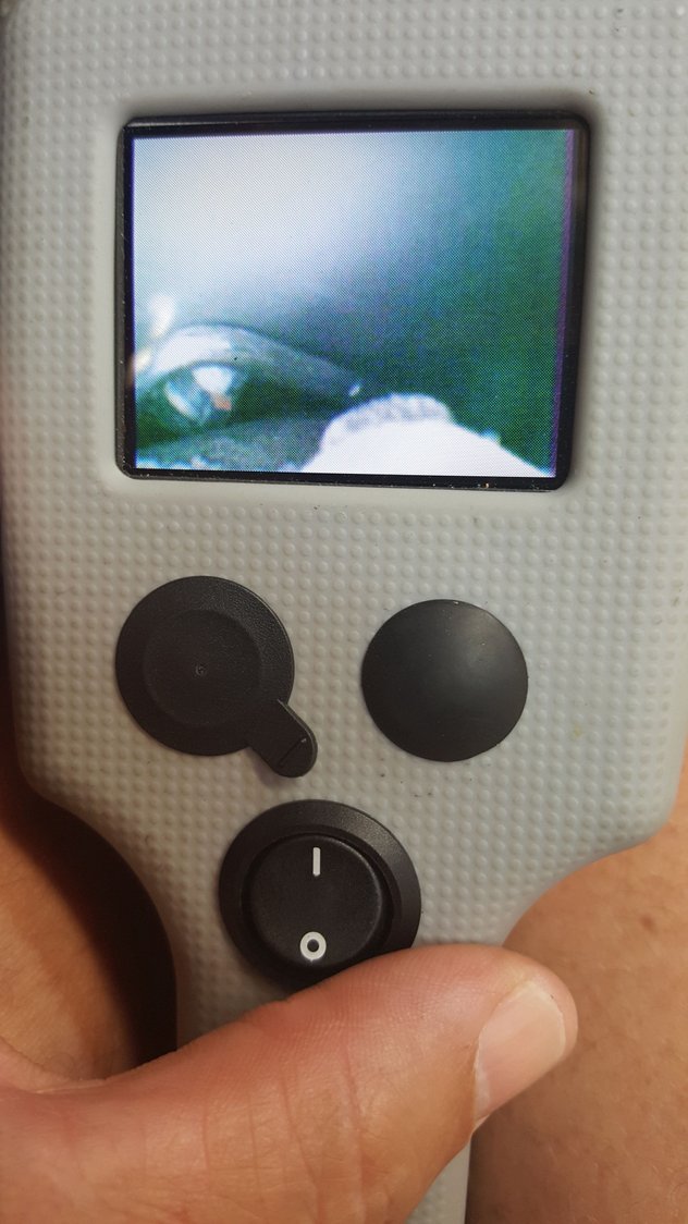

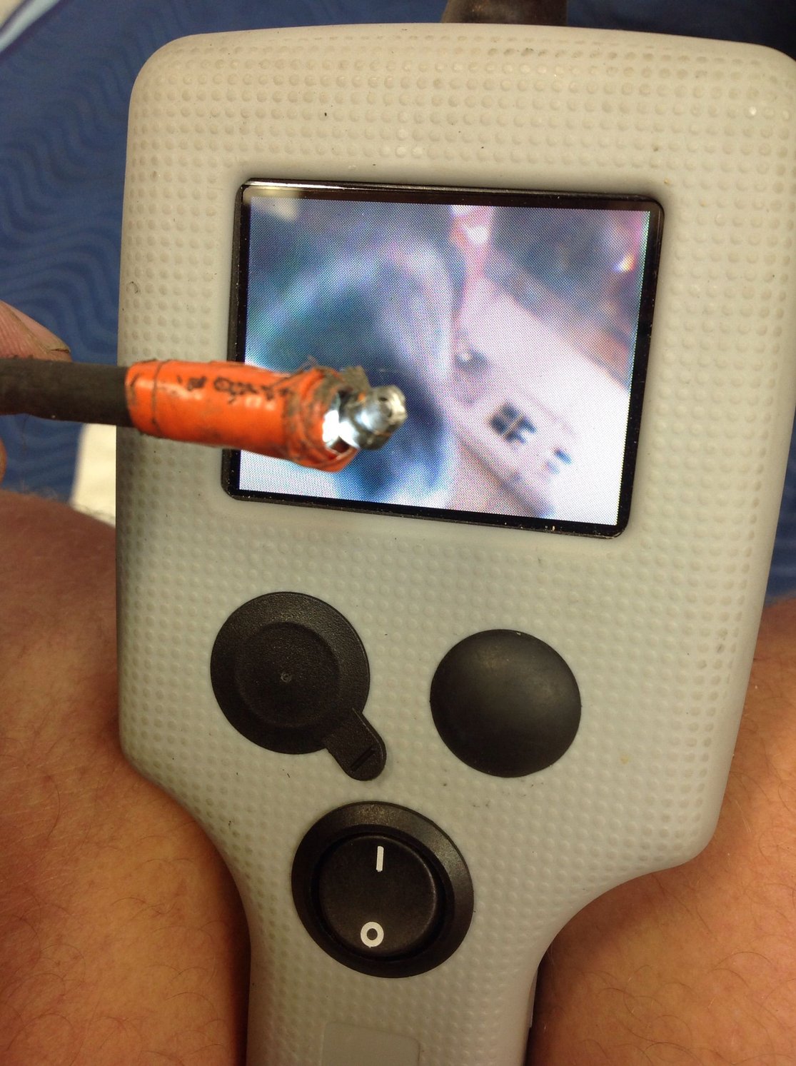

I am becoming practiced at working with the camera and implements so I can try a second career as a surgeon. I was able to hook it and drag to the back.
I had to drop the bumper and the black x-grid brace to pull another body plug which was easier to work toward. Taped a magnet to the camera and got it.

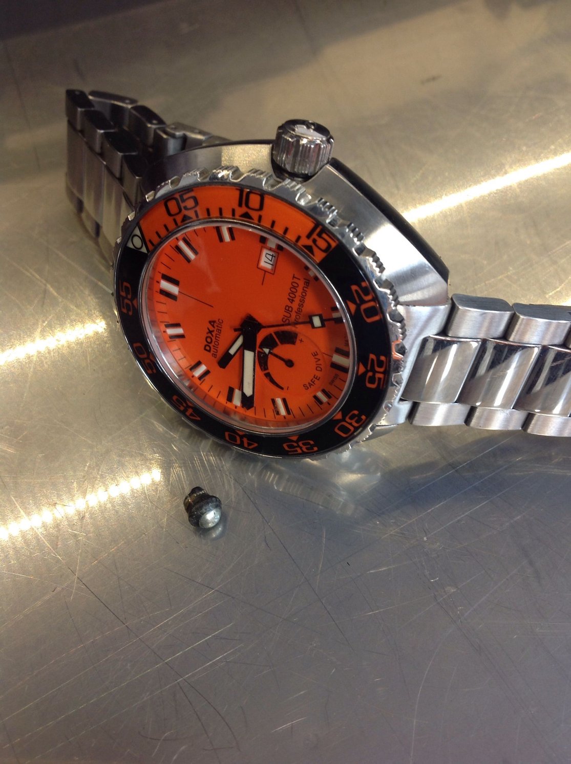

Much smaller than I was expecting! Watch for scale:
The bad news....there is at least one more on each side.

Last photo, where its in your palm, look like the head of the rivet has been drilled off?
Seems to have some of the black plastic of what ever it was holding in place on the shank?

Wow. Hard to believe something that small could cause sheet metal to warp. I am not sure, did you say some parts of your rear window were removed to re-paint your car? Something for the rest of us to be aware of should we note such a bulge or have work done on our cars. And how useful the video system you used can be. I don't have one.
glad you were relentless and resourceful enough to get it out.
