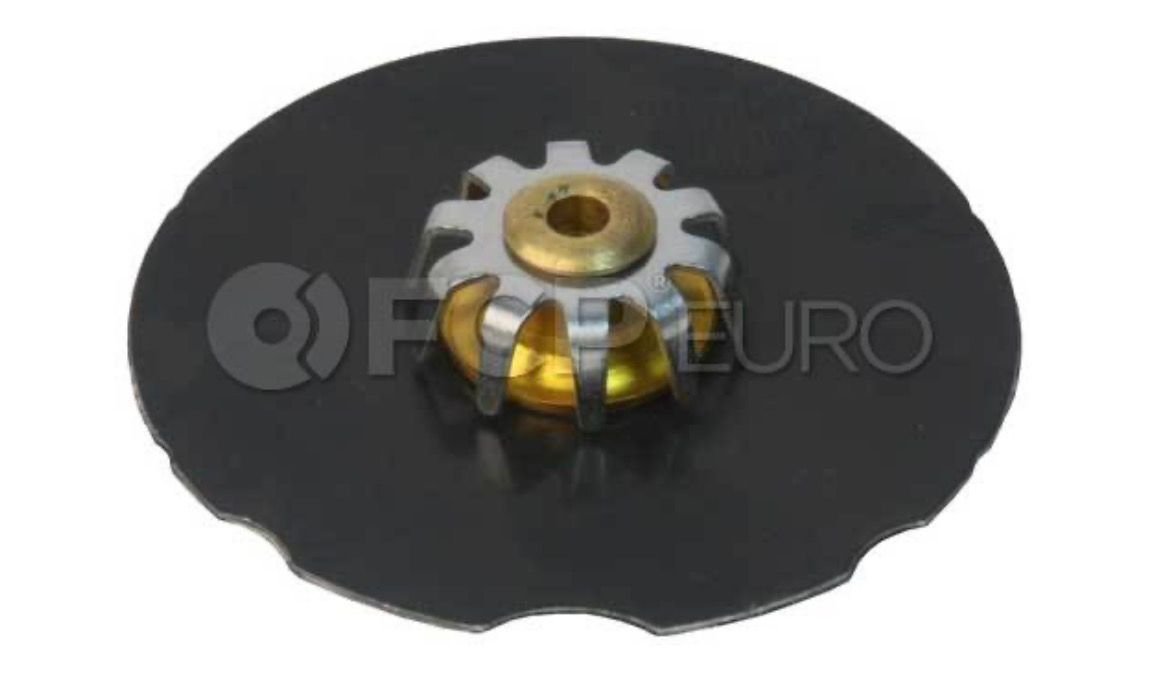

I’m wondering if the problem is not coming from the set up :
- I assume there is a plate behind the pads ( oem) that had been removed.
- The antisqueal Shrim ( spider) are also missing
Do these two parts play a fundamental role in the retraction of the brake pads.

Your pads pull back from the brake rotors by a fraction due to the nature of the caliper piston seals which have a little "springiness" to them. When you step on the brakes, the piston push out a tiny bit and the seals flex. When you relate the pedal the seals pull the pistons off the rotor by a fraction. Your camber has ZERO to do with any of this. The way the wheels spin in the video is perfectly normal.
The anti squeal shims play no part in any of this.
