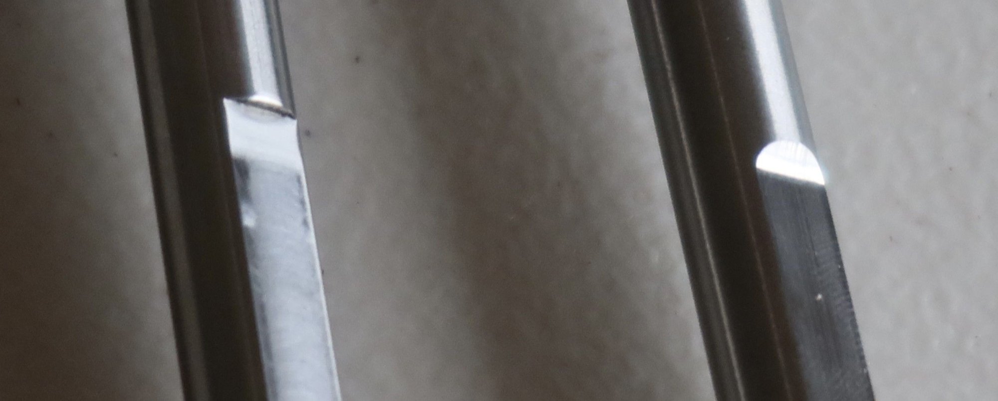

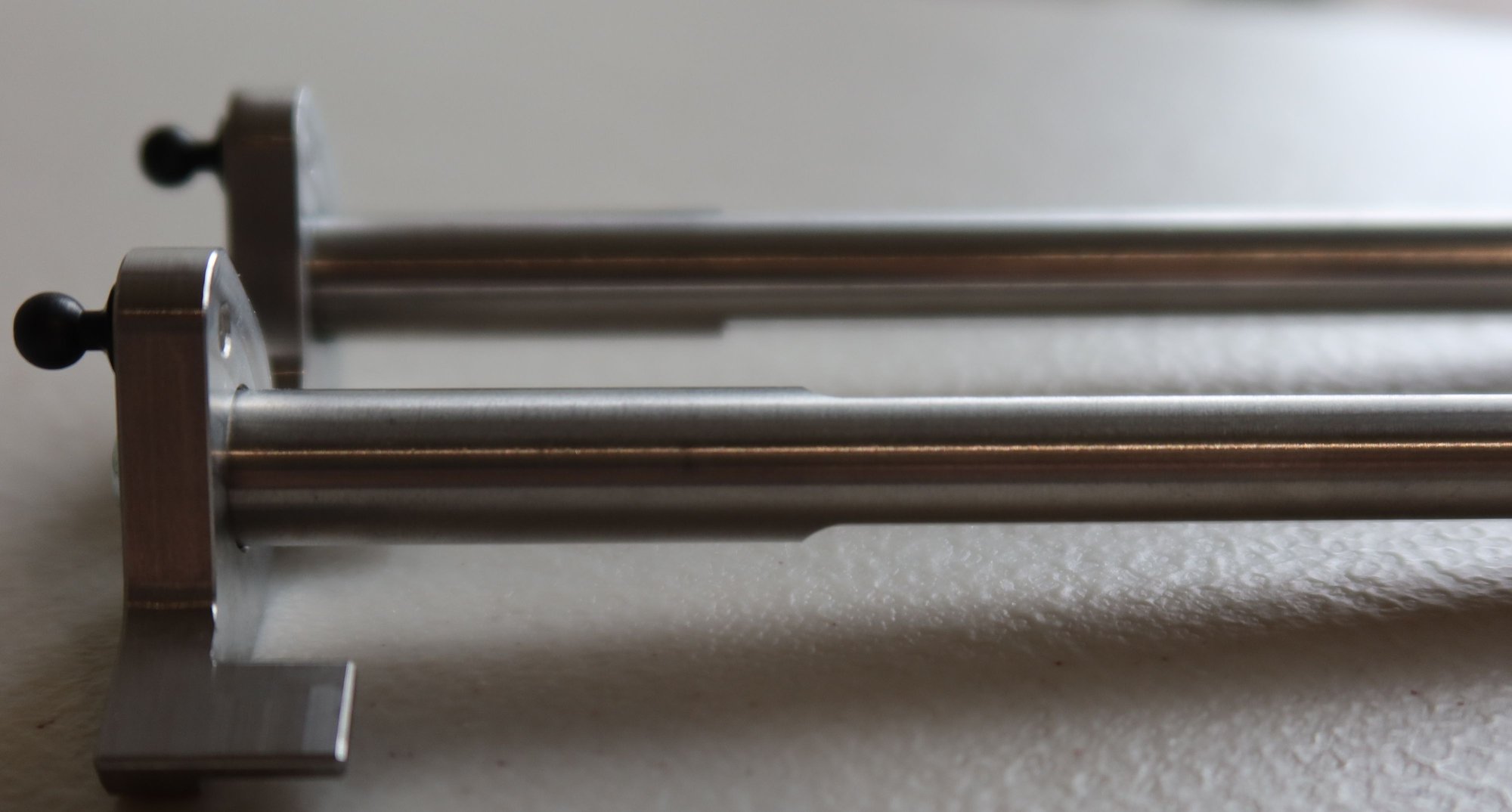

While the prototype in our 997.2 GT3 RS performed flawlessly, we used the final development phase to "over-engineer" the production units even further. We made two refinements to ensure this is a "set it and forget it" fix:
  1. Stress-Concentration Elimination: We’ve implemented a softer, more gradual radius on the flap stops. This removes the sharp "stress risers" where fatigue often starts(prototype left production right)

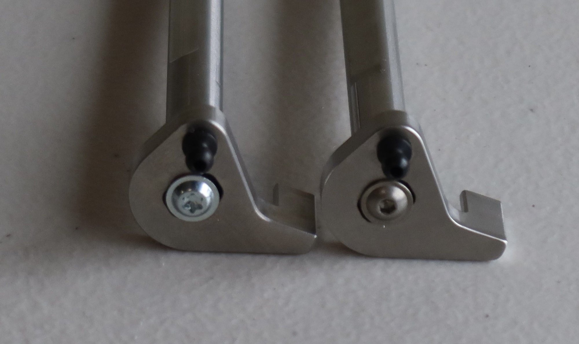

  2. Fastener Evolution: We’ve upgraded to specialized, high-grade assembly bolts with double the tensile strength of our initial prototype hardware. (prototype right production left)
    Grade 10.9 Fastern
    Grade 10.9 Fastern

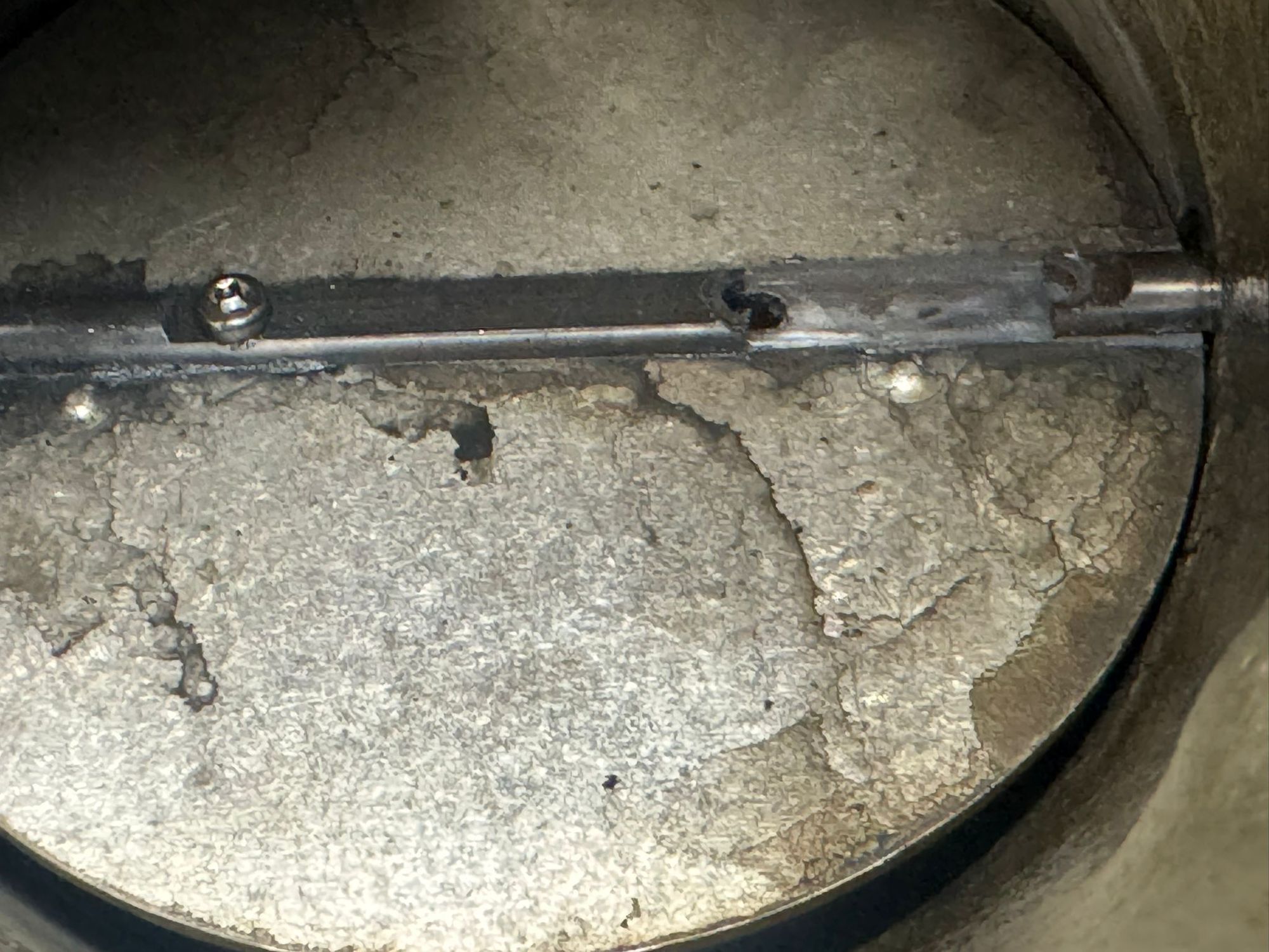

A Reality Check: It’s Not a Matter of "If," but "When"
We recently received a sobering photo from the renowned GT specialist shop in the UK, RPM Technik. They had a 997 GT3RS towed to their shop. Turns out another intake manifold rod has failed, and this engine is being rebuilt.
UK based 997 3.8 RS Rod Failure
As these cars age, the OEM Intake rods are reaching their fatigue limit. This isn't an "isolated incident" or a "track-only" problem—it is a mechanical reality of the factory design. When this fails, you aren't just looking at a bad afternoon; you're looking at a $40,000+ rebuild and a 6–18-month wait for parts and repairs, as many 997-era parts are back-ordered without an ETA. We are happy that the owner and RPM Technik are upgrading their manifold as part of the rebuilding process. But ideally, these failures never happen.

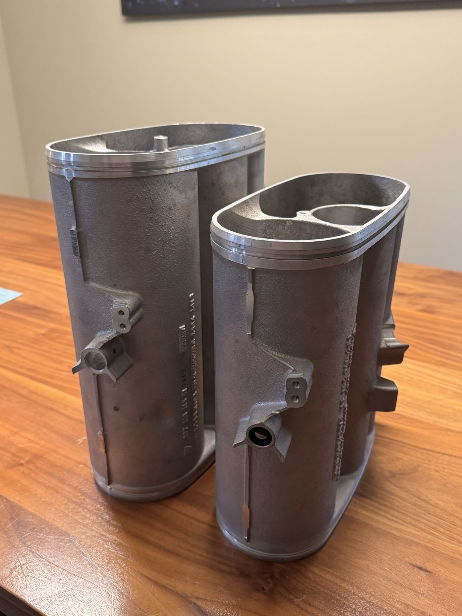

Did we ever confirm whether the latest .95 part being sold for all 997 GT3 variants is the old 3.6/3.8 non RS tube size or the larger 3.8 RS/4.0 size?
If it’s larger, I’m wondering if it would be beneficial to upgrade to the larger diameter tube on a 3.8 non RS? Since the tube is only a grand or so, seems like it would make sense to go bigger first before considering Elliot’s retrofit given that the tube isn’t super expensive.

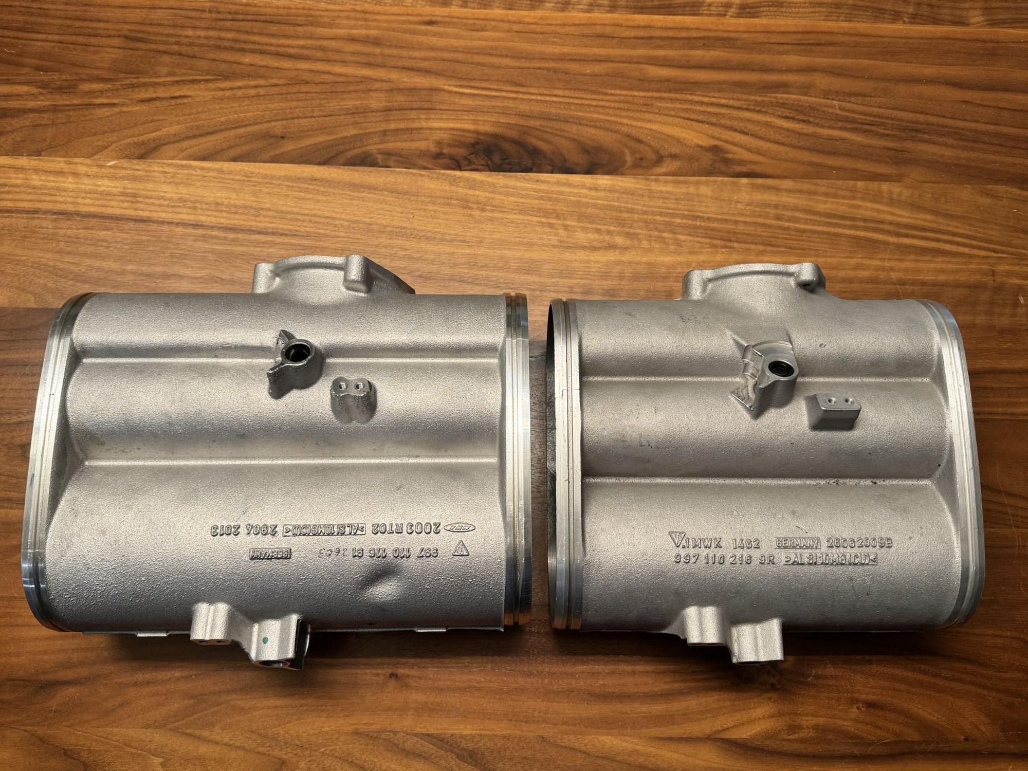

The 95 ending part is for the 3.6 GT3/RS and 3.8 GT3. The centers aren't compatible. You would at least need to switch the side manifolds as well. See this part listing here
Photos of a 3.8/4.0 RS center next to the smaller 3.6 GT3/RS & 3.8 GT3.

Thanks for the info. It looks like with the side runners the swap is a bit more expensive. Maybe I can luck out and find a used complete manifold setup. Not sure if the juice is worth the squeeze at new parts prices.
