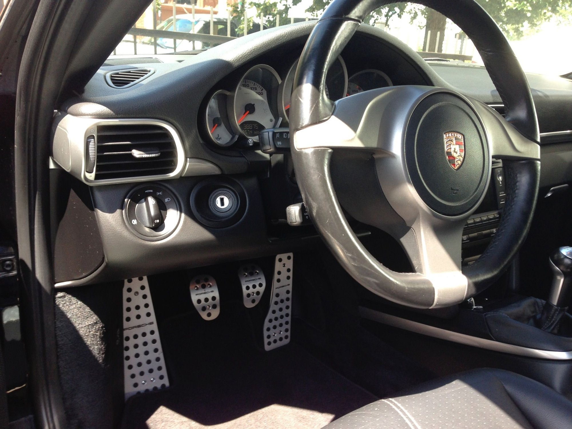

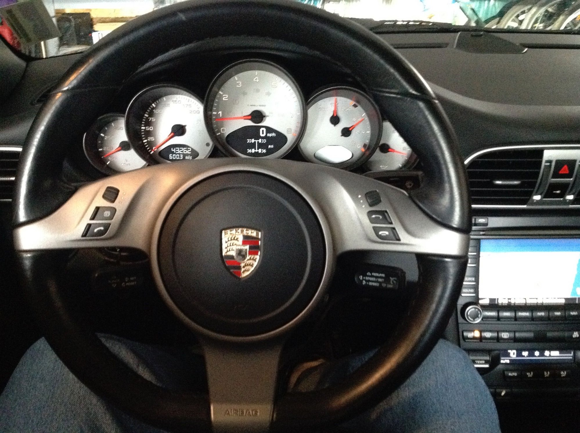

I've got a 2010 C4S Cab MT, which I bought CPO'd in 2013. IIRC, 2010 was the first year with the round steering wheel, and it was available in the standard or Multi Function format, with heating also an option. Mine came with the standard wheel with the heating option, but I converted it to MF by simply buying the MF faceplate and getting in installed by my local P Dealer. I think it was about $575 for the wheel and an hour install at the Dealer. I think all of the wiring is Pre-installed for the MF option, you just need to buy the faceplate (I bought mine from Suncoast) and get it installed and programmed with PIWIS. All in, I'm really happy with the change as this has been my DD for the last 4 years. Here are my before and after pics of the swap:
Originally-installed standard (but heated wheel)
The updated faceplate for the MF controls
