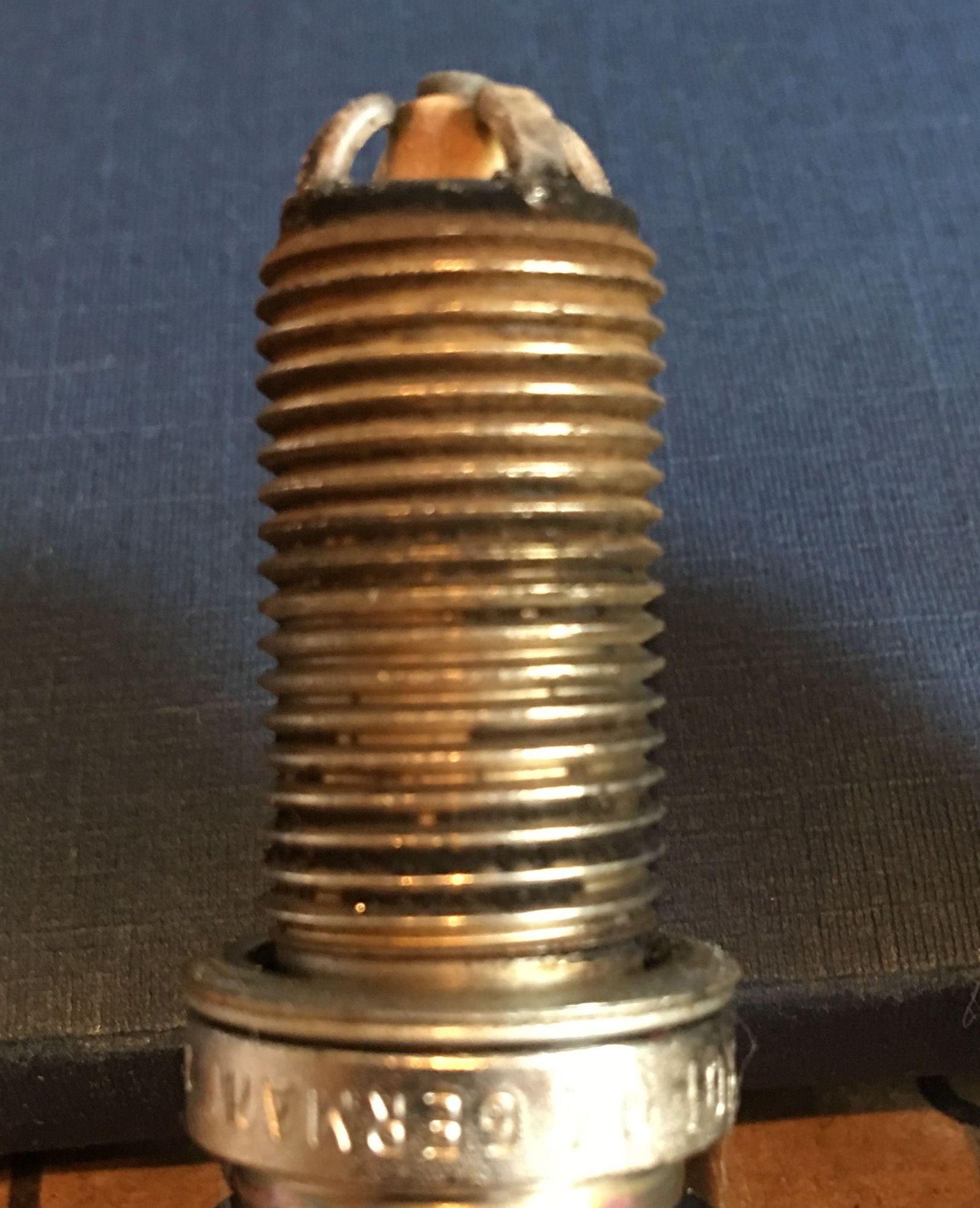

These are the plug threads after just 15K miles over four years. (crappy iPhone pic )
That doesn't look bad at all.
Old 03-21-2017, 06:05 PM
Lvt19672
Lvt19672's Avatar
Join Date: Sep 2011
Posts: 922
Received 14 Likes on 8 Posts
Looks like a barely used plug.
