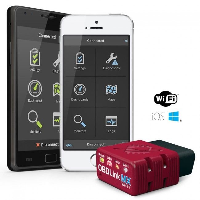

I've used this for about a year and a half on all on my cars for reading and clearing codes. It works with my iOS phone just fine and supports Android and Windows smartphones as well. They have other versions too, such as a Bluetooth one. It can read all of the standard ODB-II diagnostic info including accelerometers and other sensors, RPMs, temps, etc, but not anything that is specific only to Porsche . It doesn't do the special Porsche-specific things a Durametric Pro can do though and you'll need to look up Porsche-specific codes on the web using the numbers it reports. It's reasonably priced though and does everything I got it for.
https://www.scantool.net/obdlink-mx-wi-fi-scan-tool/
