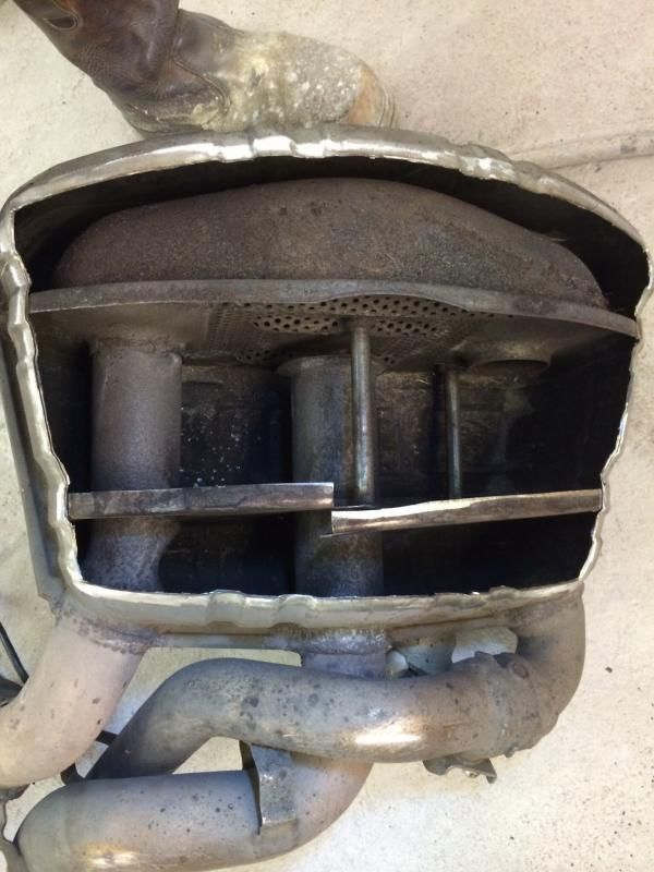

A closed PSE is virtually the same sound as a stock muffler. In another thread I recently posted a photo I'd seen in someone else's post of a broken PSE muffler cut open. I'm reposting it here. Note that it must be a 997.1 can though since the PSE outlet pipe is smaller:
You can see that the PSE has the extra outlet that takes sound from the first chamber. A non-PSE muffler still has the outlet position used by the PSE cast into it but plugged, another indication that they muffler cans themselves are likely the same.
The center muffler on both a PSE and a non-PSE are the same on US models. (I've seen some hint that Euro models have a different center on the PSE... PSE conversion kits for Euro models include a center muffler that has the same part number as the US models).
