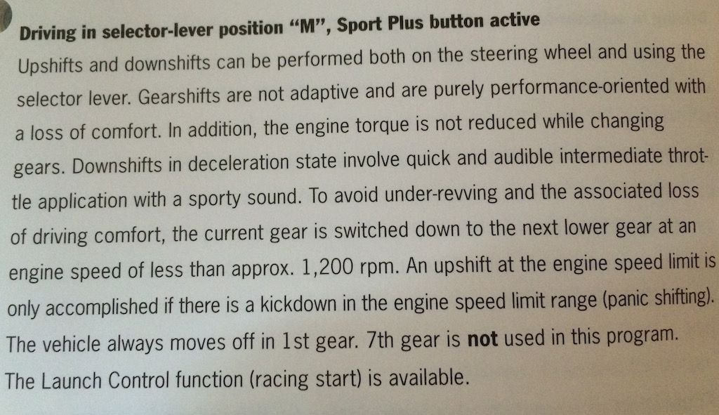

Yep, good to shift anytime as all of the others have stated. I'm also fine with the existing shifter embedded in the wheel EXCEPT for having to learn not to accidentally press the upshift with the heel of my hand in the heat of the moment of an autocross. I've had more traditional paddles on BMWs as well so I'm familiar with both. It did take a while for the shift direction to become natural though, but stick with it and do it while just driving around for additional practice and before long it your brain just does it right.
Here are a couple of interesting excerpts from a technical book I have on the 997.2 with respect to the PDK's behavior in Sport Plus. Note that in Sport you can also get behavior very similar to Sport Plus if you are driving very aggressively (since Sport mode is adaptive and even Normal mode to some degree), however, Sport Plus firmly locks in the most aggressive mapping.
