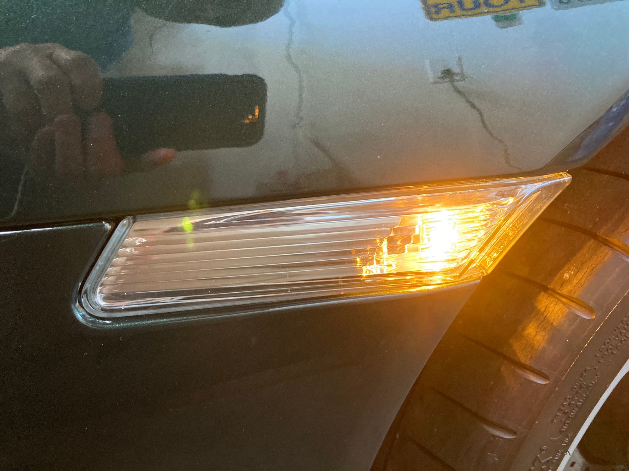

Old Aug 2, 2021 | 11:47 AM
Dr.H's Avatar
Dr.H
Joined: Jun 2019
Posts: 130
Likes: 53
From: Bay Area, CA
Originally Posted by LμL
Thank you Dr H! I already tried 3 different 'canbus' bulbs for my sidemarkets on my 997.2 with no luck. But seeing you're tested this set I've put in an order. Do you photos of them illuminated?
Another option I found, I think looks really slick is this: https://www.fvd.net/us-en/FVD6319970...972-clear.html
Doesn't work on my RS which is a shame due to the tacked on front fender flares. but it's a better LED design side marker.
here’s one illuminated.
