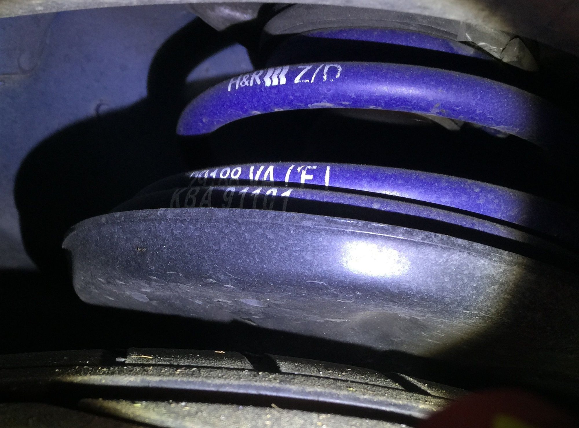

The front springs appear to be H&R Z/D 29188 VA (F)

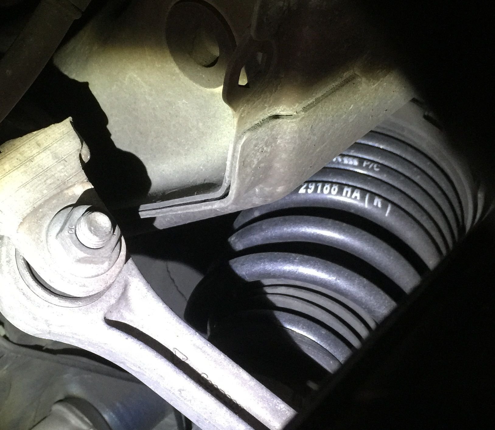

And the rear springs appear to be H&R P/C 29188 HA (KorR)

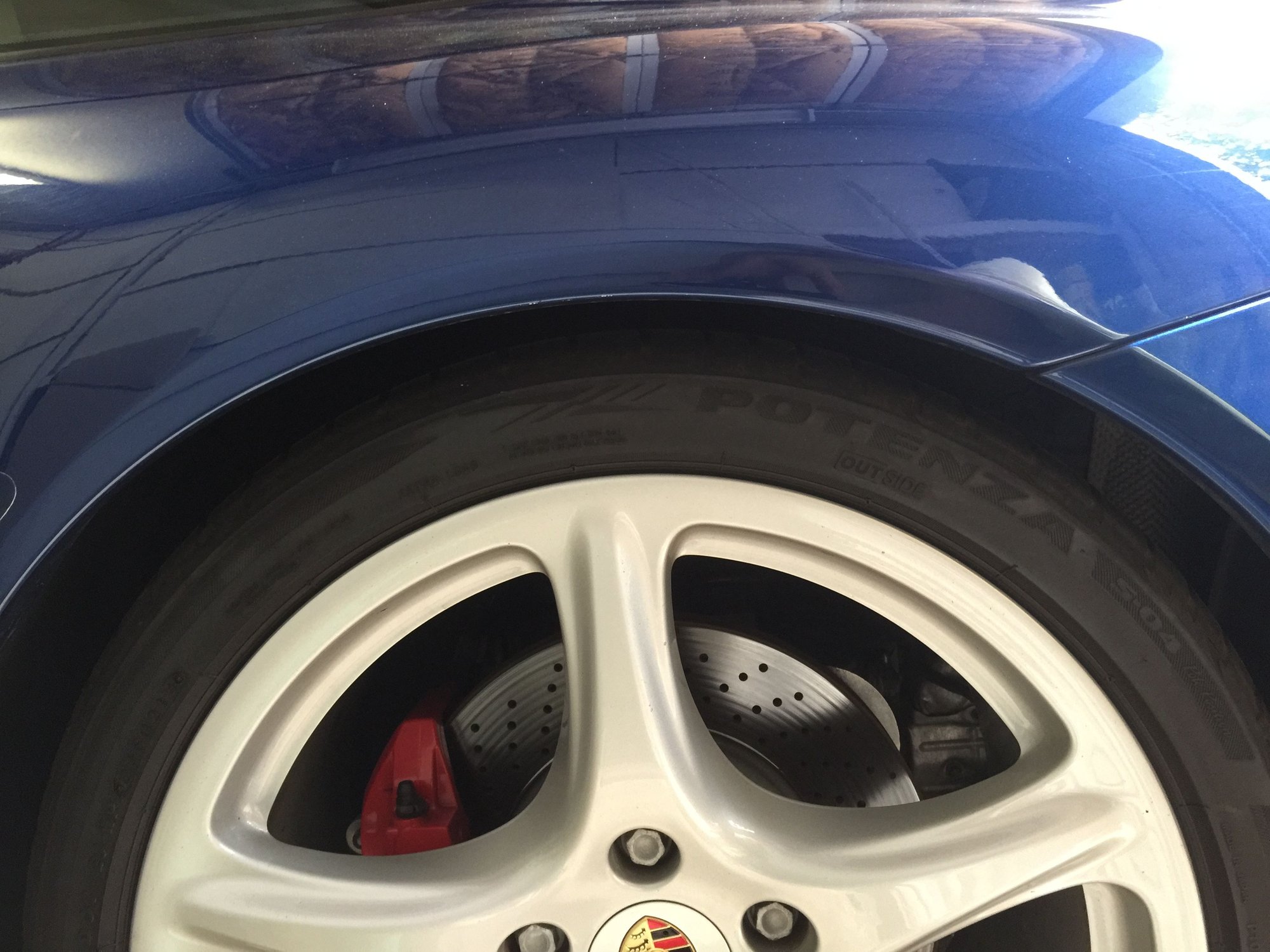

top of tire is about 5/8" below the apex of the wheel arch opening on all 4 wheels
It appears that you have the H&R Sport Spring Set.
Tire Rack H&R Springs
