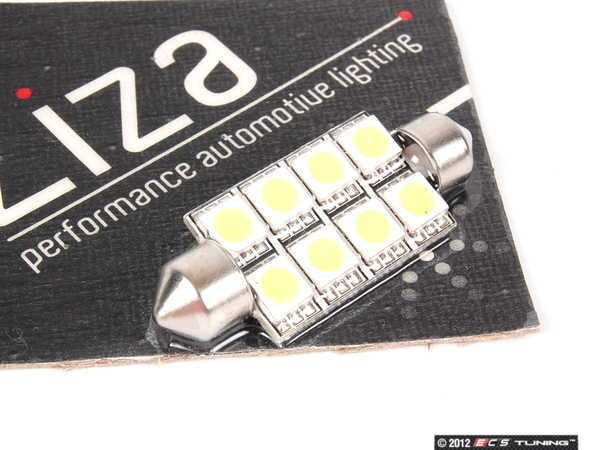

The correct bulb you'll need is a 8 chip 42mm, like the one shown below.
For more information on the bulb and kit Click Here.
For the PDF instructions Click Here.
The PDF instructions are very helphull. Thanks.
