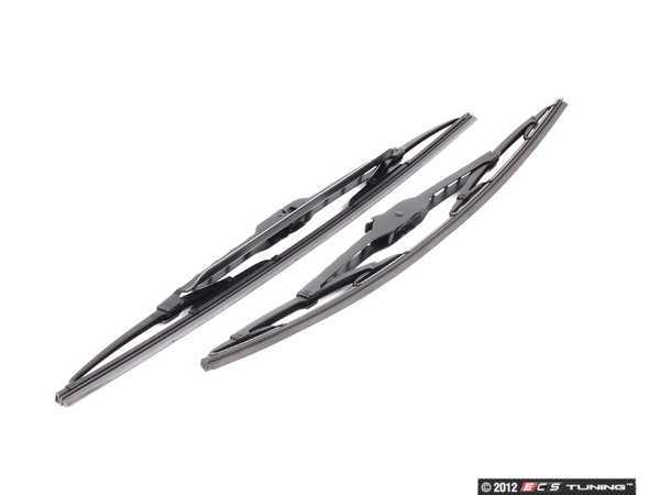

I agree, get some new Wiper Blades would be the first thing I would do. Then report back and let us know if that fixed the problem.

Thanks all.
Have ordered a new set of blades, thanks for the link!
In the iterim I have cleaned the windshield several times with windex with amonia and used a scoring pad on the edge of the rubber on the blades.

I had the same exact issue. As others have said, you need new blades. After I put on new (OEM Porsche) blades, the wipers sweep so smooth, you'd think the windshield was covered in vaseline!
