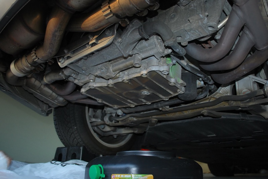

See the drain plug & filter in below picture.
Used the 8mm Hex bit for drain plug. Get a Oil catcher with big opening for catching old oil from the engine belly. I used 10 qt oil pan here.

Cover your garage floor for any spillage. Unscrew the drain plug with 8mm hex. Unscrew the oil filter with oil filter wrench
