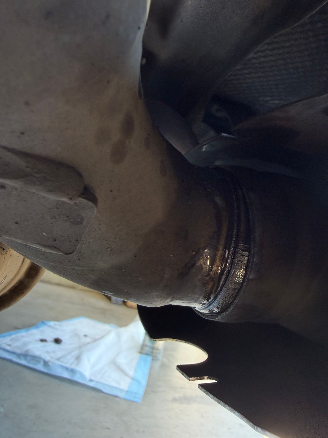

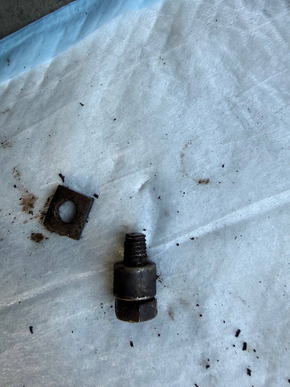

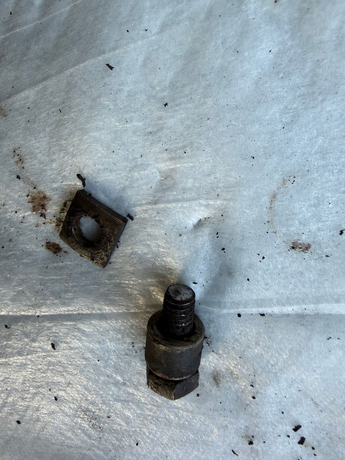

Old thread, same problem and I could use some help. On the driver side I've loosened the bolt pretty well after spraying WD40 this week, on the passenger side unfortunely after a few more twist the rusty bolt broke of. If think it's the part below the lower sleeve but I'm not 100% sure. I'll have to deal with that but first, for the driver side, although I think it should be loose enough I'm having a hard time getting it off. I just sprayed WD40 in the gap and can try again tomorrow but is there any other new trick to this? See in the picture how far I can pull. It wiggles really well now that it's a bit lubricated but no dice pulling it out.

It'll come just wiggle it as your pulling back, lean your weight back a little, dont try to just forearm it. Change the hardware to stainless too.

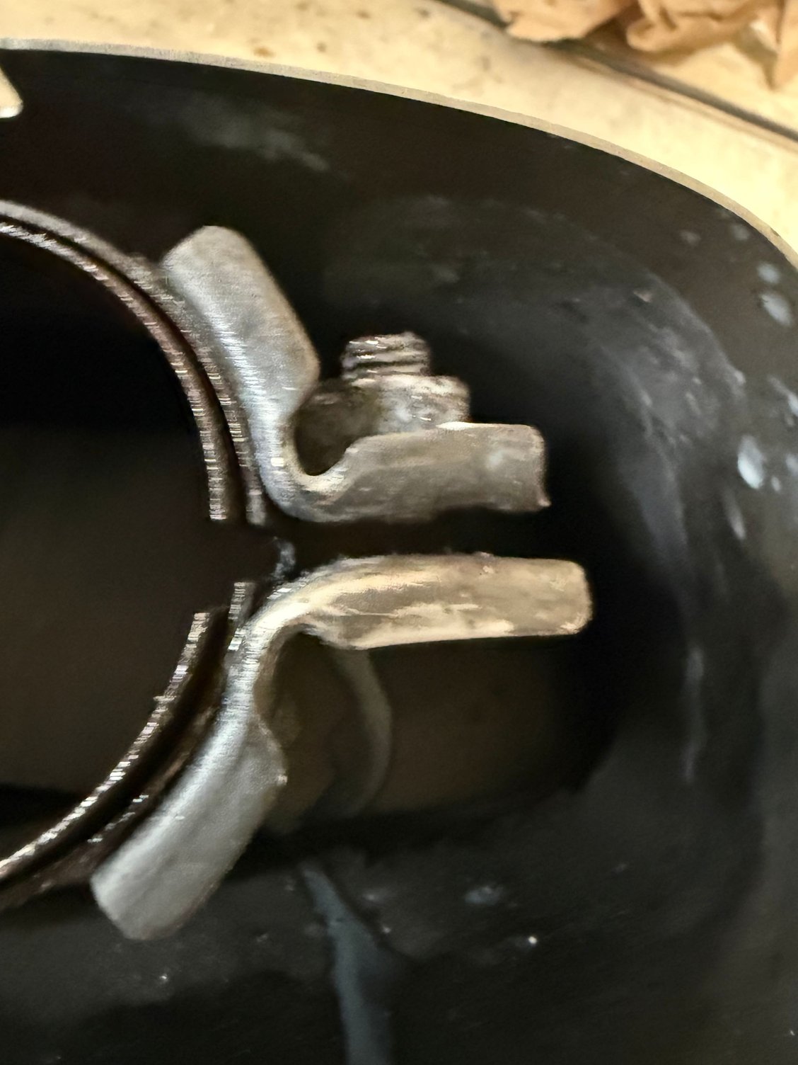

I think the inner sleeve (olive) is stuck to the pipe so probably gonna try a cold chisel and hammer

Ok done, what did it was the cold chisel and hammer. It wasn’t too bad once the inner sleeve started moving, I could also tell looking inside the tips. Now I gotta fix that one side where the bolt broke off, I need to remove the tail somehow. I’ll also need to find a replacement bolt. From a video I found for supposedly 996/997 (though it was a 996 tip) it seems to be a M8x35 with part number N01-033-57: https://www.pelicanparts.com/More_In...Yo6VZipWn8c-wT
