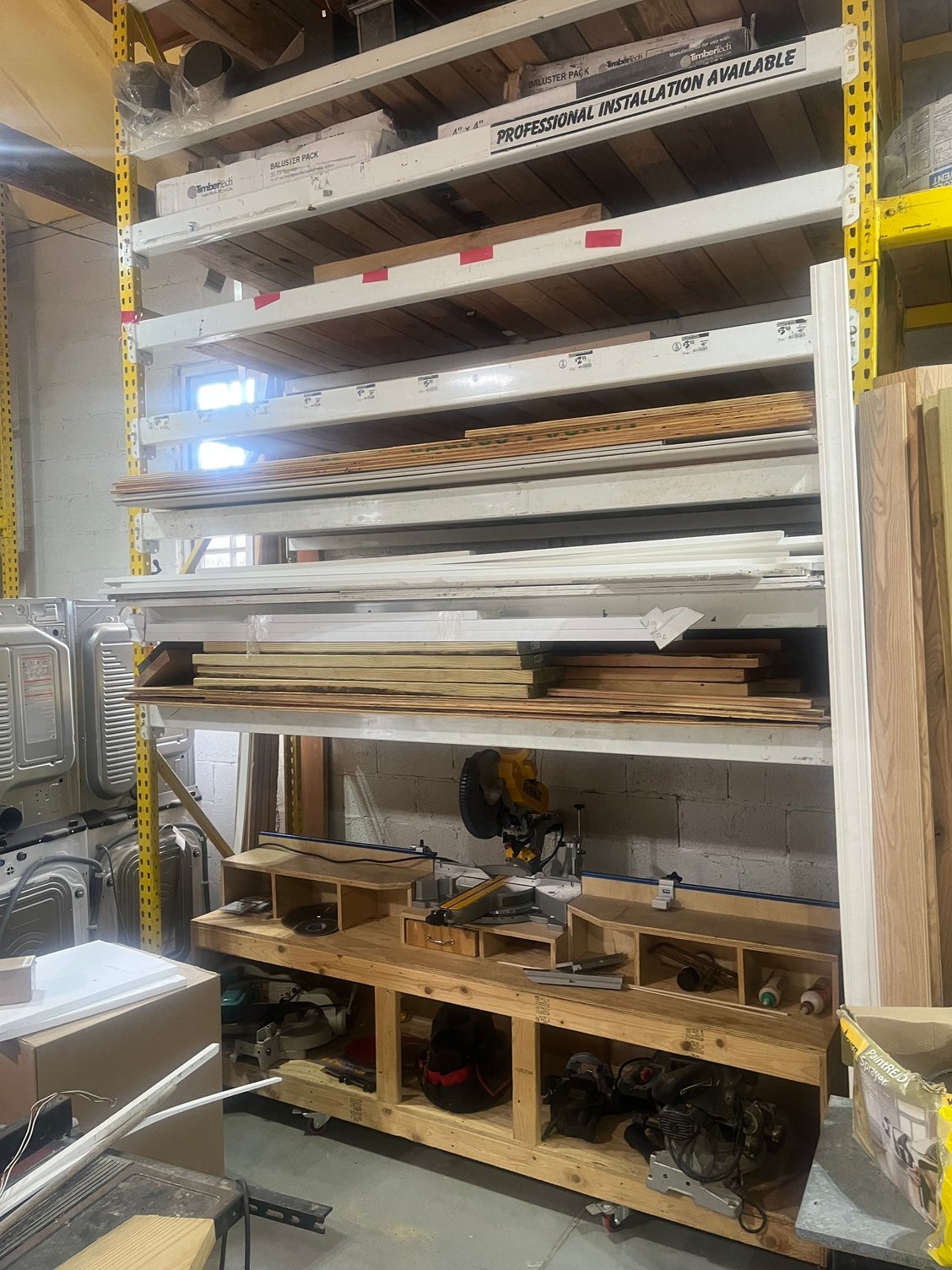

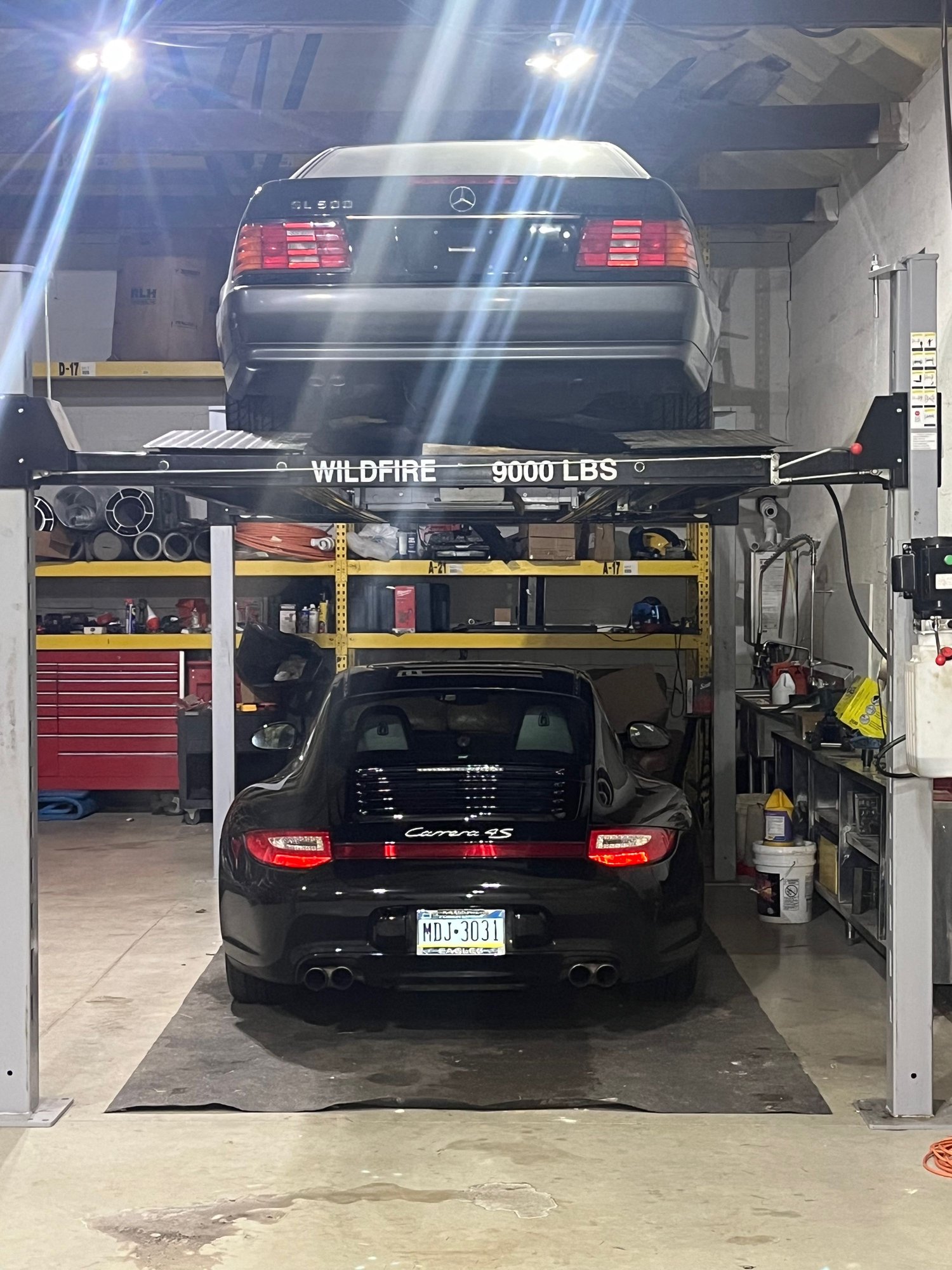

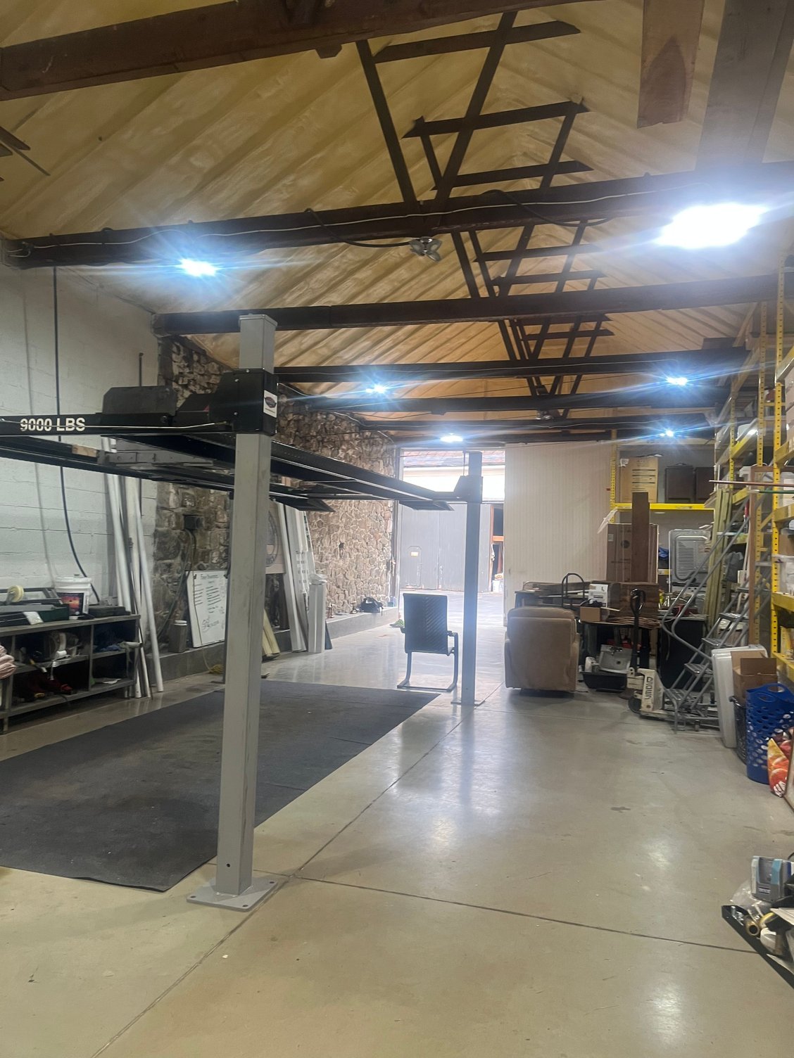

I have a highbay garage with a four post lift on one end and a basic woodworking station (miter on rolling bench) at the other. For storage I use old steel Home Depot pallet racks - the shelves used in every store, which you can find online practically everywhere. If you're in a cold climate, I highly recommend floor heating. I keep the space at 55* during Winter. I'll be out there later today working on my truck and will snap a few shots.

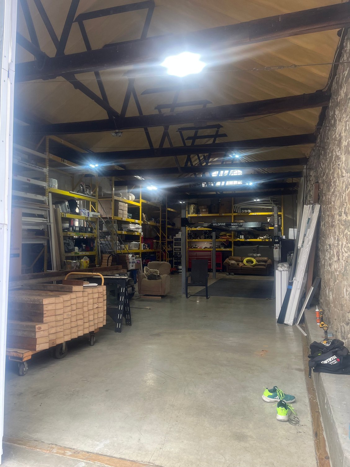

This is an old shot of the back half. Will take some more later. Maybe it will give you some ideas. The sink in the back right corner is nice to have too.
