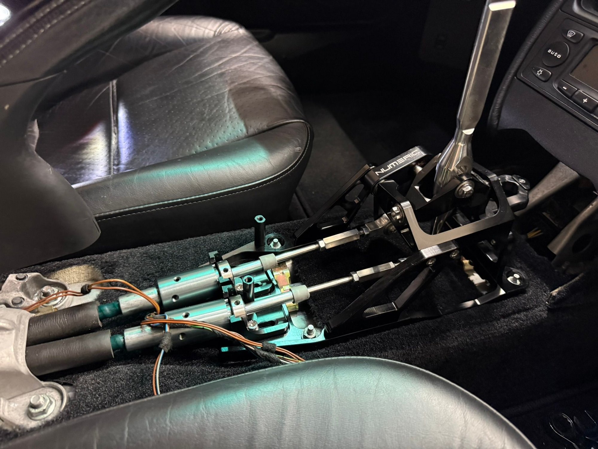

I really like the Numeric in case you change your mind. Installed it a couple months after I acquired my 997.2 in 2019. Been enjoying it ever since. Had the intention of doing the cables as well but still running the stock shifter cables.

Numeric shifter with Numeric or Function First Green Cables... 100%
Loved it so much on my 996 I also got the same setup on my 997

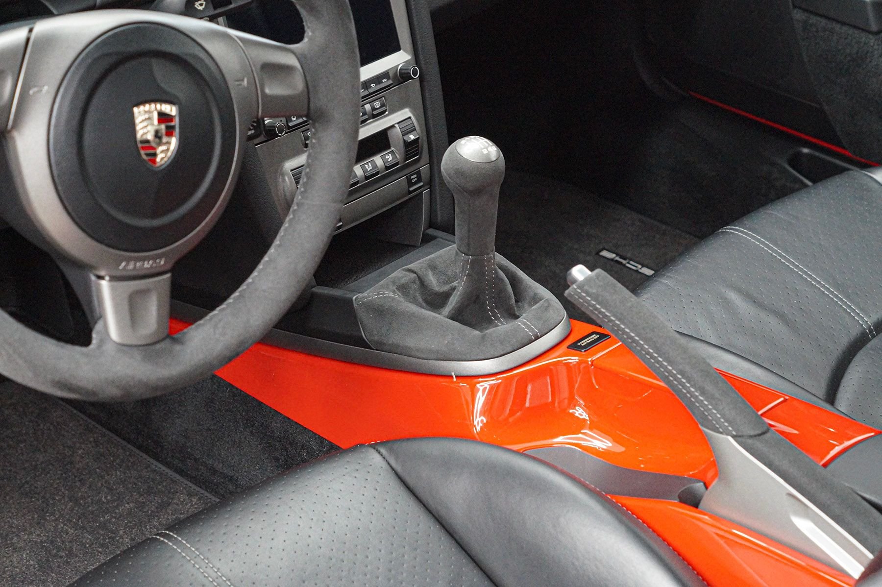

the 997 GT3 shift console has been touted as perfect, not to much race but eliminates the slop
add a weighted **** and shifts are easy and accurate
been enjoying mine for a decade
https://www.suncoastparts.com/produc...T3CONSOLE.html
Mfg Part # 99742401091

Numeric... has three positions so you can try some options. I personally don't like short shifters, I just don't get it. I kept my Numeric with a stock length.

Numeric SSK
Numeric Shifter cables

Here's the thing: Yes, the Numeric is objectively the most "rifle" in action, but it's too clanky and race-y for a typical street application. I simply thought the metal on metal clinking was too heavy in NVH and not commensurate to the experience. It's also really expensive for what it is.
I did like the improved feel of the Numeric shifter cables that increased sharpness of response.
