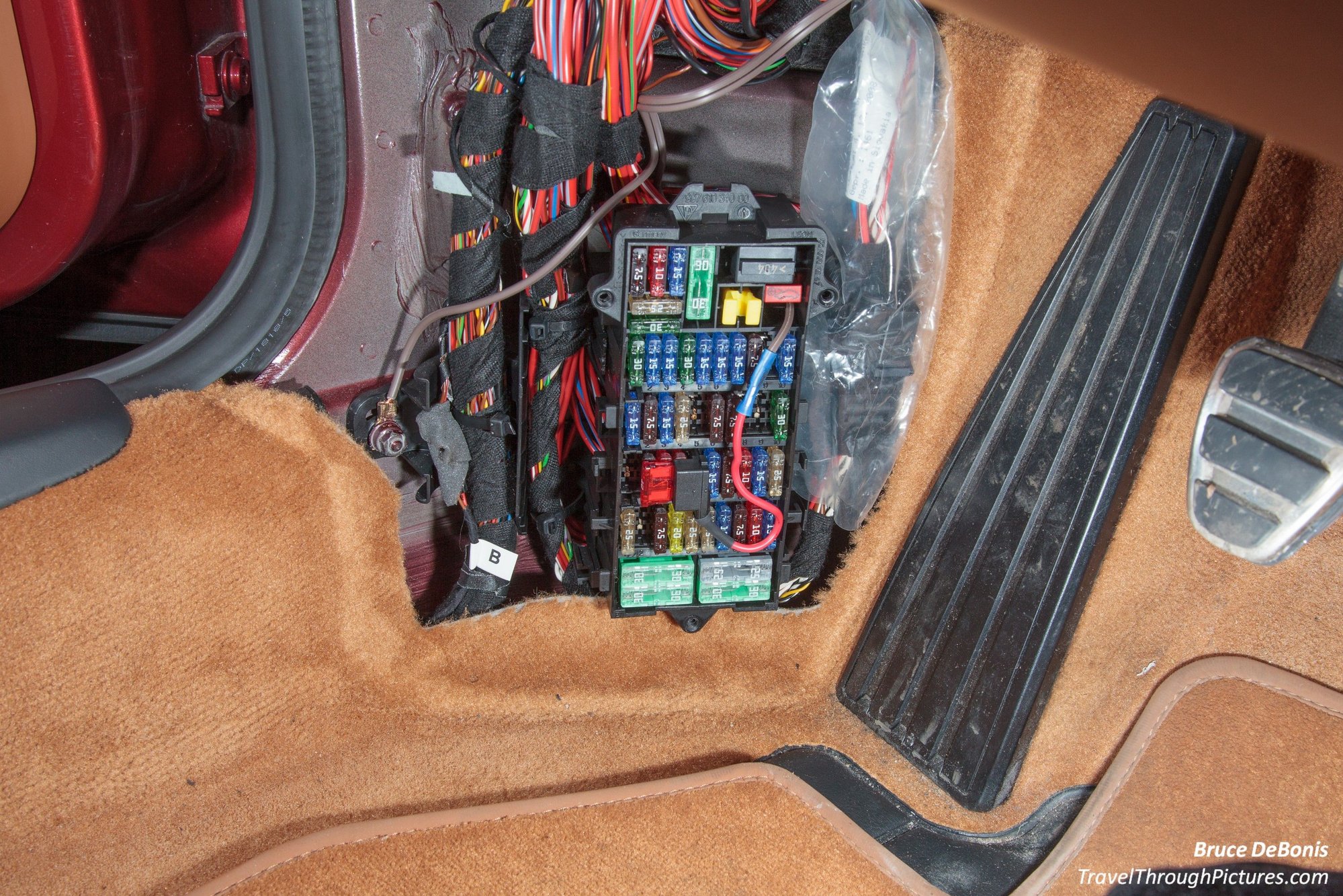

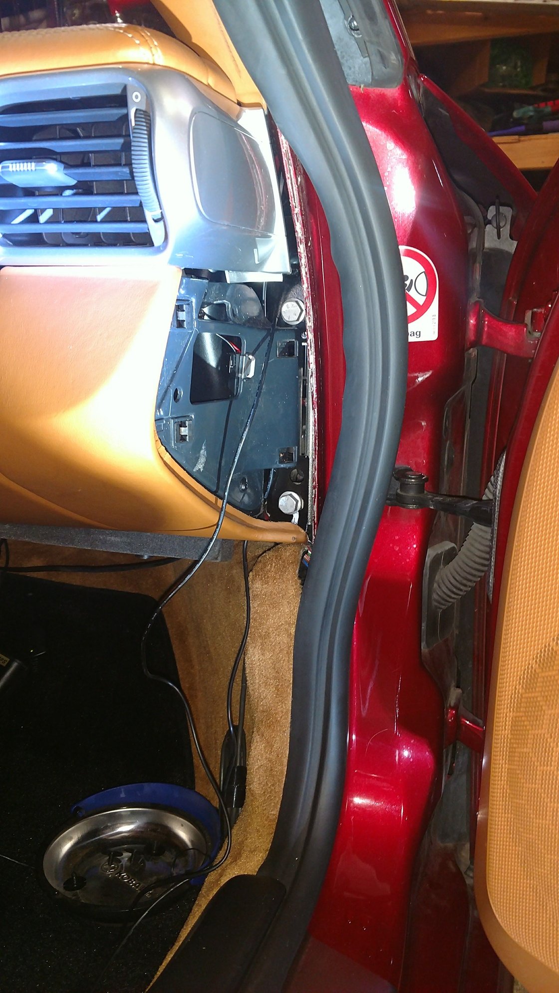

I also ran mine from the fuse box up versus the mirror tap and it's pretty straightforward if you pull the driver's side vent and the A-pillar cover then run it along the front of the headliner.
I used an add-a-circuit tap to the 12V outlet in the passenger side footwell, snaked it up behind the vent and into the triangular channel in the A-pillar, taping it down to prevent it from ratting around, then wrapped the portion going across the headliner in the spiral cut wire loom so it fit the gap at the front of the headliner snugly and that's pretty much it. Be careful pulling the A-pillar cover and you shouldn't have any issues.

I found that I needed to remove the B pillar trim to remove the trim above the door in order to remove the A pillar trim. An air bag was involved. Disconnect the battery and wait half an hour before starting.

It is super easy... just snake a wire above the pedals, use some velcro straps... feed it over the hump behind the center console. Remove the foam plate under the glove box... over to the A pillar. Remove side panel, tuck into A pillar. Along the windshield, there is a wide gap to stuff the wire.
I put a cigarette lighter socket up behind the glove box... just shove it up there... and this allows me to hook up multiple devices... my radar detector and a dash cam.
